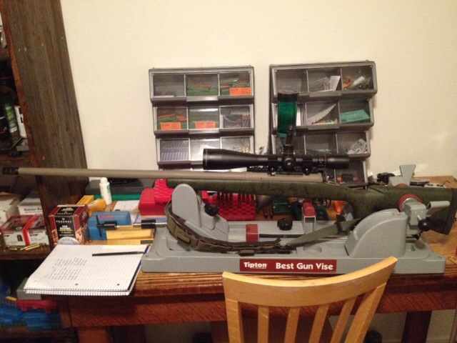

I used Savage Shooters and Youtube to build a Savage myself in .260 (PTG Tac/Match reamer). I thoroughly enjoyed the process, and have the additional pride in having built it myself. I picked up several parts off here used to keep the price down. I shot groups in the .3's during load development, and I'm new to precision shooting and precision reloading (prone, bipod 100yds). I did have the action already, so that is a consideration.
