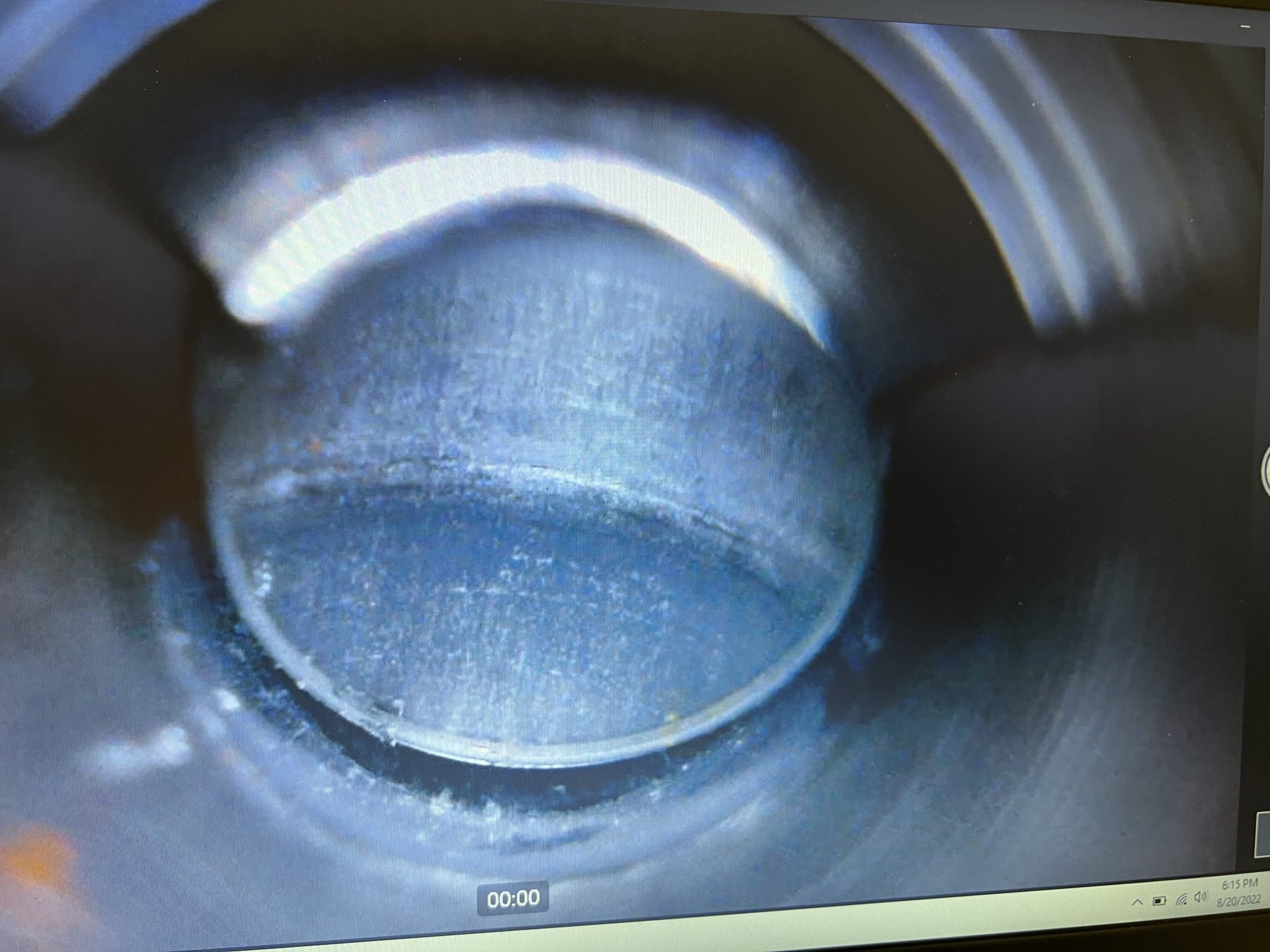

Is my barrel shot?
sachsmart
  • Dec 29, 2020
    307
    121
    08867
    After a few months I took out my Sons CZ457 Precision Varmint trainer. It used to group sub MOA but started throwing fliers and shooting really big groups. Checked bore thru a scope and saw brass filings. Cleaned it and shot it again with different ammo and it did the same thing. 5” groups at 50yrds. Checked the bore again and see brass shavings and pitting.
    It has about 1500 rounds not enough to shoot out a barrel. Confused to what the issue might be
    Thanks in advance
    you're like 1% into the barrel life of a 22LR
    figure out why it's shaving brass off the case and getting into chamber
    unless it's coming off crap plated bullets?
    My son dry fired it a bit before I told him not to, but not sure that was enough to cause damage. I will check the barrel screws
    I shot SK
    I see yellow particles but not sure if brass.
    possibly burn residue from the powder.
    Check y'er extracted brasss for scratches or chips as b6 recommended.
    Check all the fasteners for correct torque.
    Might have a screw or two loose.
    Yes will check the barrel screws and will check the shot brass
    Could be several things, but at this point I would be playing w action screws. If you can tune it back in by manipulating those, then you know it needs bedded.
    Edit to add: To answer the original question; your barrel isn't shot, its one of the other million 22lr idiosyncrasies.
    Reactions: sachsmart
    Thats not uncommon. Give it a good cleaning, it's pretty likely not copper unless you shoot anything other than lead?
    It's unlikely that there's brass in the bore. If it is in fact brass, where's it coming from? The only brass is the casing, which can't get into the bore.
    It's quite possible there's debris from the "cleaning" still remaining in the bore.
    Regarding why the rifle is giving 5" groups, follow justin amateur suggestion to check action and barrel screws for correct torque. Loose barrel retention screws can wreck havoc with performance.
    Yellow is powder residue.
    Look at the chamber for the carbon ring.
    This will cause first round fliers in PRS. This will start as first round of match then turns into first round of stage. Also check crown for issues.
    Picture is carbon ring. Sometimes you can see lead from bullet on ring.
    Check the scope. I had one go bad (turret needed to be rebuilt, which factory did at no cost) gun back on track.
    After checking everything listed, I found the problem replacing current with an older, proven scope. Rifle went back to shooting. After new scope was repaired, good to go.

    New CZ, appx 1500 rounds, shooting SK ammo.
    The barrel is not "shot out", it could possibly be damaged from very inappropriate cleaning practices, but probably not.

    I have thoroughly tightened everything to spec from barrel screws, action screws to scope mount.
    For those asking- I clean this 22 after 300-400 rounds, unless I change ammo. Bore tech rimfire blend & dry patches. There is no carbon ring.
    Last season we shot about 5 rimfire PRS/MARS matches. The rifle shoots single hole & shot very well. Did not get to shoot too much rimfire this year as I was busy with my PRS matches.
    Scope is a fairly new Vortex razor Gen 2. Looks solid and tracked very well.
    So its not the Ammo, probably not the scope (but you never know), not the cleaning.
    I will find out tomorrow at the range if something was loose.
    I'd swap scopes just to see and double check for a carbon ring and inspect the muzzle crown meticulously. Chamber a round or two and carefully remove and inspect those as well.
    If it shot as well as you said before and not now for no obvious reason except a scope swap, I'm betting on the new scope and or rings/mount being the culprit.

    Well, we will file this under the many unsolved mysteries of the universe.
    After taking the rifle apart (did not remove the barrel) and putting everything back to spec torque (nothing seemed loose per say) I went back to the range today.
    I first shot CCI, the groups were bigger but much smaller than my previous outing. There were fewer fliers and the fliers were not too outrageous like before. I shot about 150 rounds and the group progressively got smaller.
    Switched to SK, shot about 30 rounds so the wax from the SK gets evenly distributed and then zeroed. The accuracy is back to what it was before & the fliers are gone.
    I have cleaned the gun before using the same components and method; it did not affect the accuracy like this. Possibly a combination of a few things but I am glad its in good shape again so we can shoot another rimfire match for the season.
