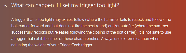

You have a real flair from massive understatement. By the by, the text in red bold font is exactly as shown on TT's website....I didn't add this emphasis.
Citation?
I look on TT site and all they have that's sort of related is wrt to AR's as shown below. But I don't see where they address this at all wrt to bolt guns.
I did find this, however:
Interesting, I would have to dig through a few years of old e-mails to find where trigger tech told me that, but apparently they have changed their tune.
