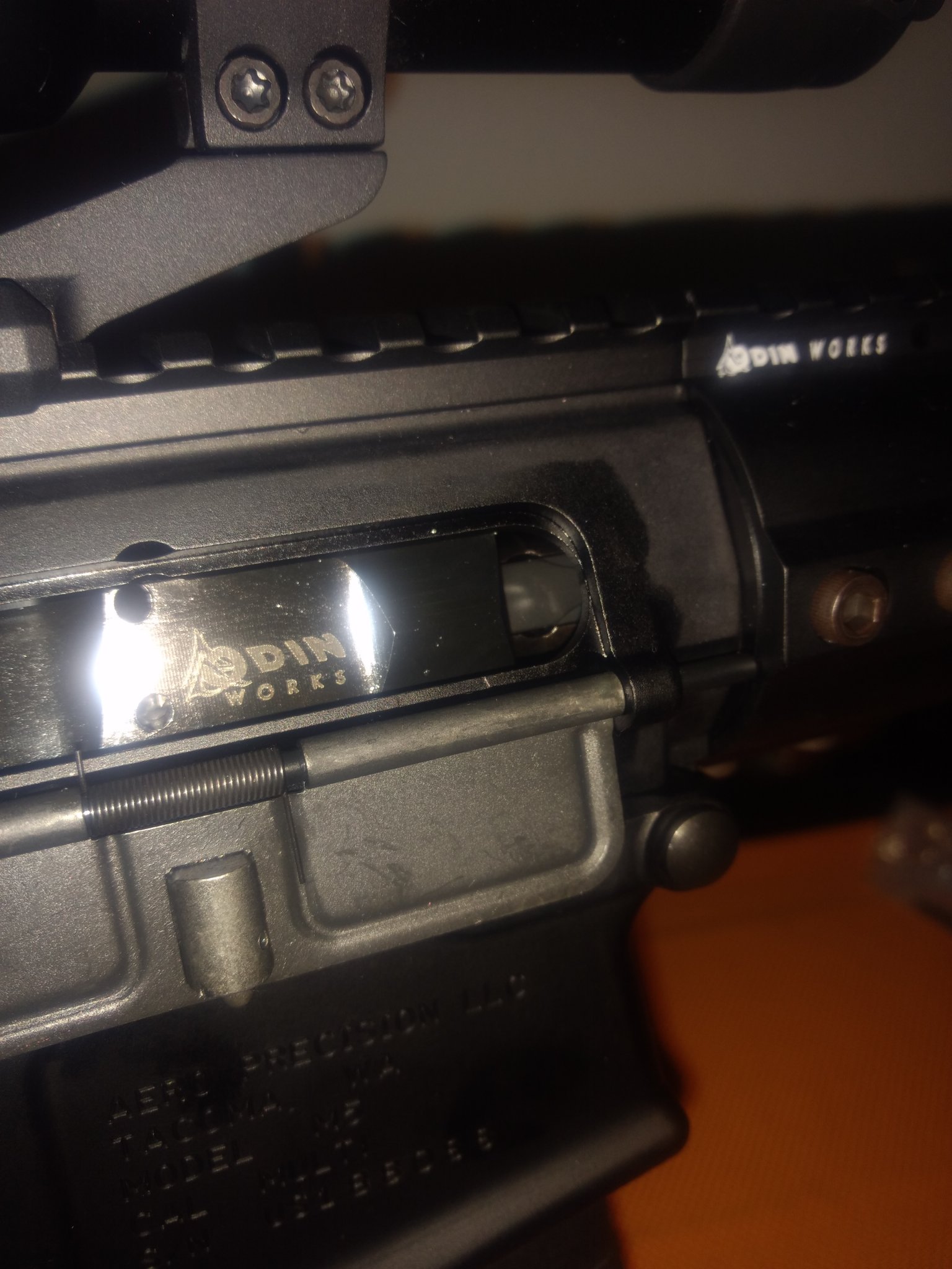

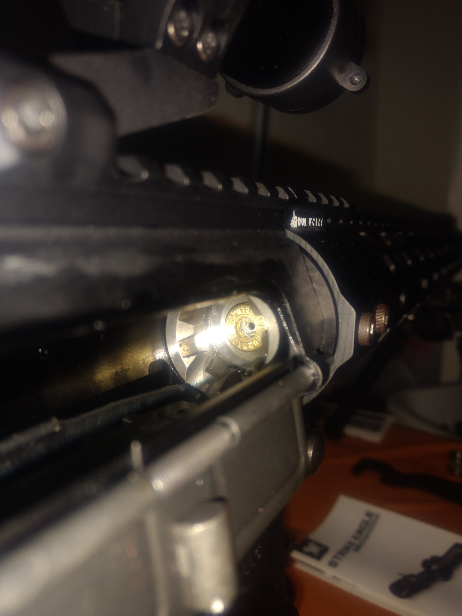

Im getting ready to start loading 6.5CM on a Dillon 550C, in a single stage manner, and I have a Redding 2 Die set (not sure model). I picked up some once fired brass, and the base to datum measurement is 1.558"-1.560".. but i screwed in my sizing die almost as far as it would go until it touched the shellplate, and the base-datum measurement is still the same at around 1.560" after sizing..
Am I missing something? the die is supposed to default size to minimum sammi spec, which is 1.541" for the chamber and 1.5368" for the cartridge I'm pretty sure. Also the brass fits right into my L.E. wilson case gauge, except it just needs to be trimmed down a hair..
So If somebody could shoot me some wisdom I'd appreciate it because I don't wanna blame the equipment since I'm probably the weak link here.

I have good measuring tools. and the brass won't chamber in my new odin gunworks upper. I use L.E. wilson gauges, and a forster datum dial with digital caliper obviously.

This is the "sized" and trimmed brass not fitting in chamber, and not going into battery.

Your picture shows the bolt not fully closed but are you certain that the extractor was over the rim of the cartridge? It's hard to tell from the photo if the case is in the barrel completely or not.
If a fully sized case will not chamber than a small base die may be needed. As previously stated Redding does may shell holders that allow you to precisely bump shoulders and may solve your problem.

If the brass fits into the Wilson gauge and the base is between the two steps, the headspace is acceptable.

You were right from the beginning, my Measurement setting was off.
