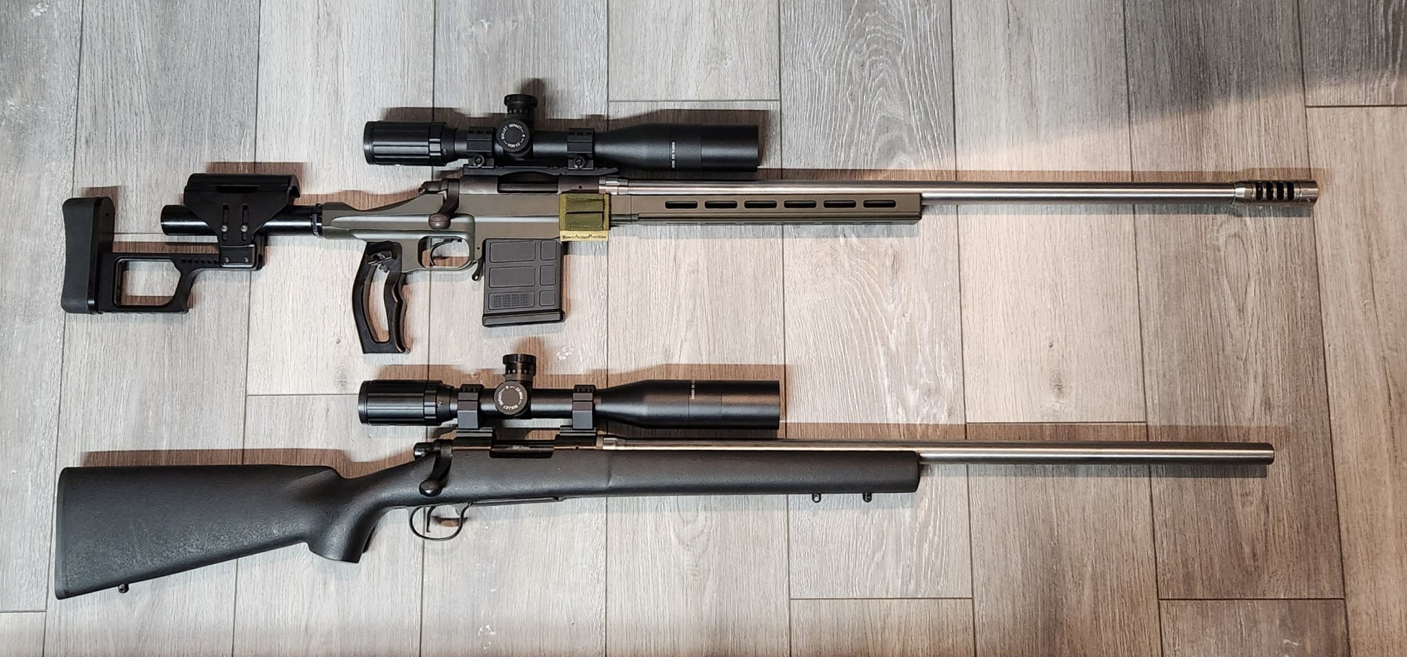

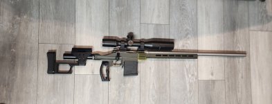

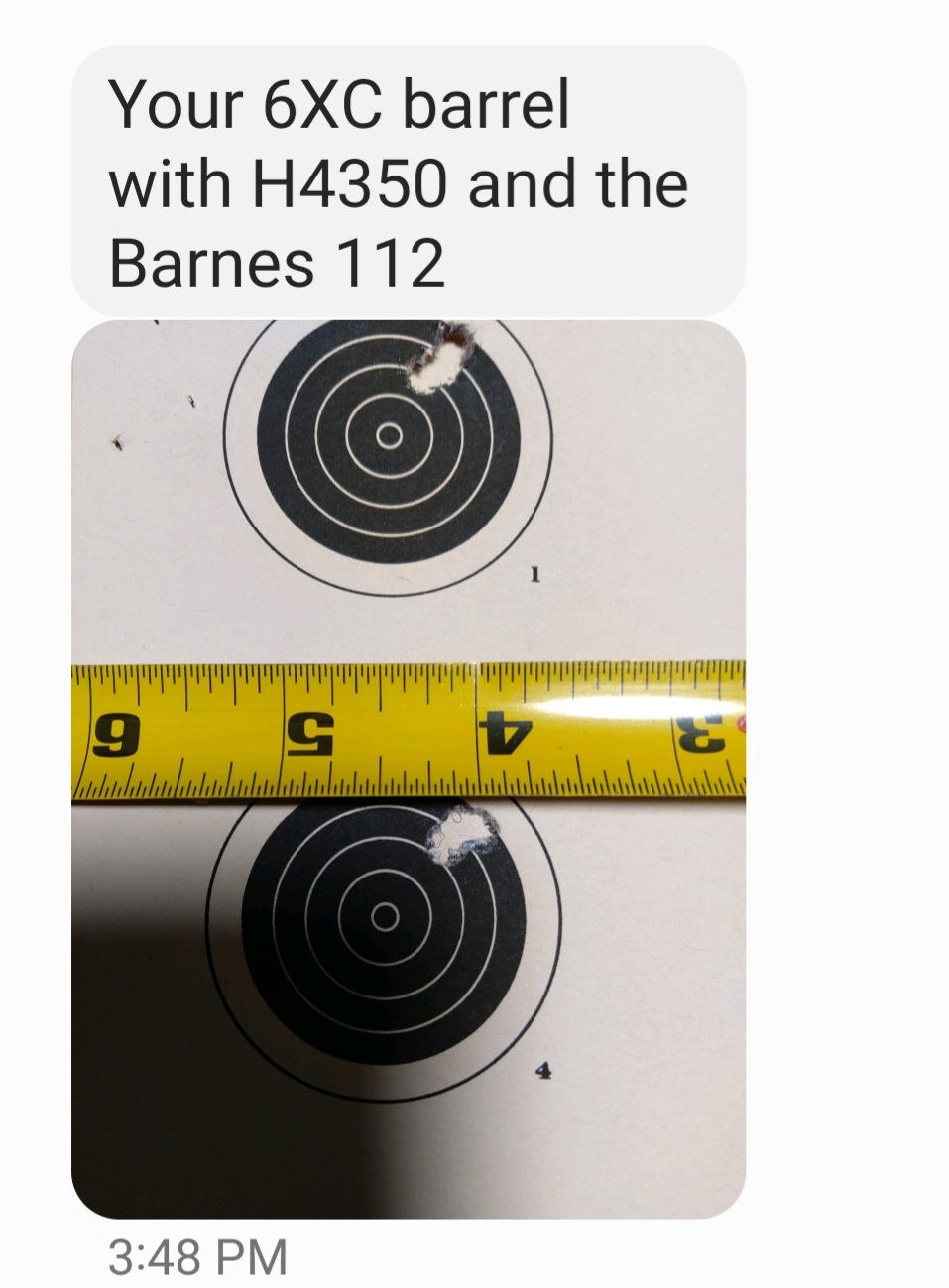

Build is complete! Weighs roughly 14lbs

Shots on the right were a lower charge to test function and sight scope in. Shots on the left were 112gr barnes match burner H4350 running 2820 fps. It was 60 degrees out with a 15 mph wind. This barrel is a shooter and will improve with further load development.

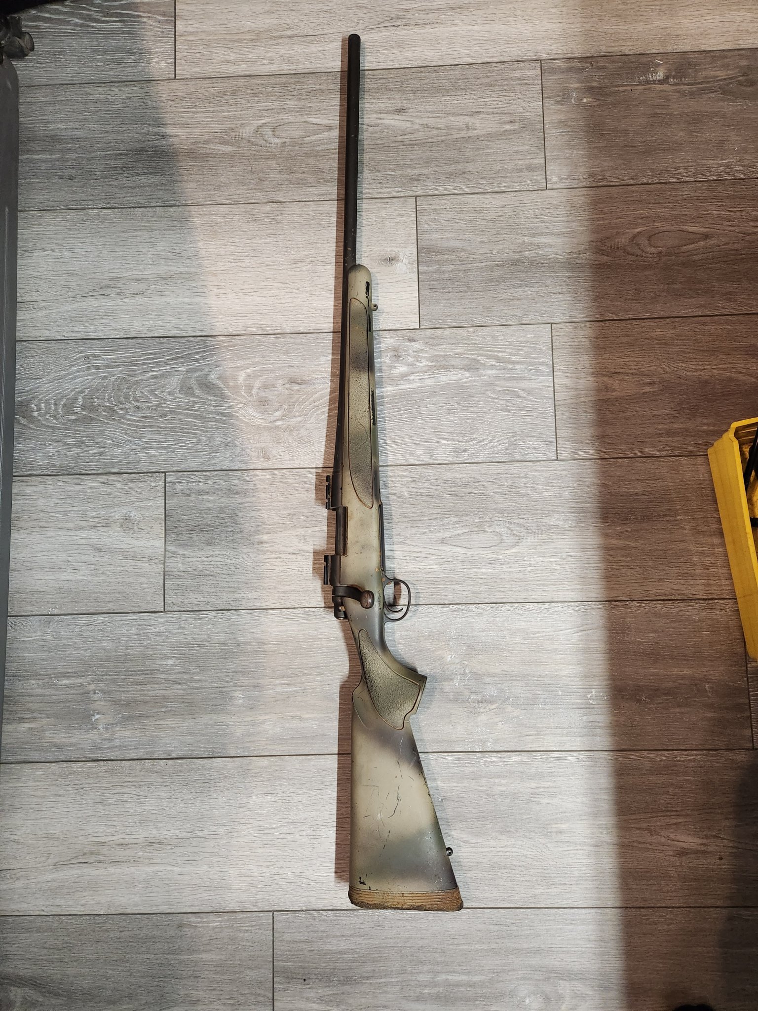

Build number 2 had begun, bought this one for $300 mid 2000's date code. I might be on the naughty list for this one. Barrel will be here on Monday plus other goodies.
