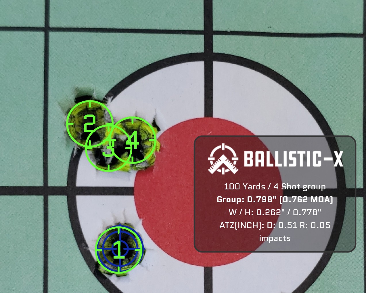

So I finally made it out to the range to give the .308 another try and see if she was accurate and if recoil was as unpleasant as I remembered.
I used some cheap 150gr lead tipped Perfecta rounds to get on paper and get comfortable with the rife. The groups were "ok" but not that inspiring. I didn't expect too much from the ammo though so I tried some match ammo to see how it performed with that.
I had a box of 20rnds of 168 HPBT Federal Premium Gold Medal Sierra Matchkings of which I used 9 to get the two groups below. What a difference some good ammo makes!
After shooting the first group of 5 rnds (which was shooting way low from where the 150gr cheap ammo was shooting - see group with ruler in it) I used 1 rnd to verify my elevation adjustments and shot a second group of 4, deciding to keep the other 10 for another session - this stuff isn't cheap!
Now bear in mind that I'm not an experienced shooter by any means, and haven't shot this rifle in 3-4 years so I was pretty darn happy with these groups! I'm going to say she's a shooter and the recoil wasn't as bad as I remember so I'm thinking I'll keep it and put a PVA Jet4 on it until my Dead Air Nomad-L arrives. I also ordered some Sierra 168's and Berger 168's and some Lapua brass to work up some loads. Primers are harder to find. I have a few hundred large rifle primers but need to find some more - any good sources?

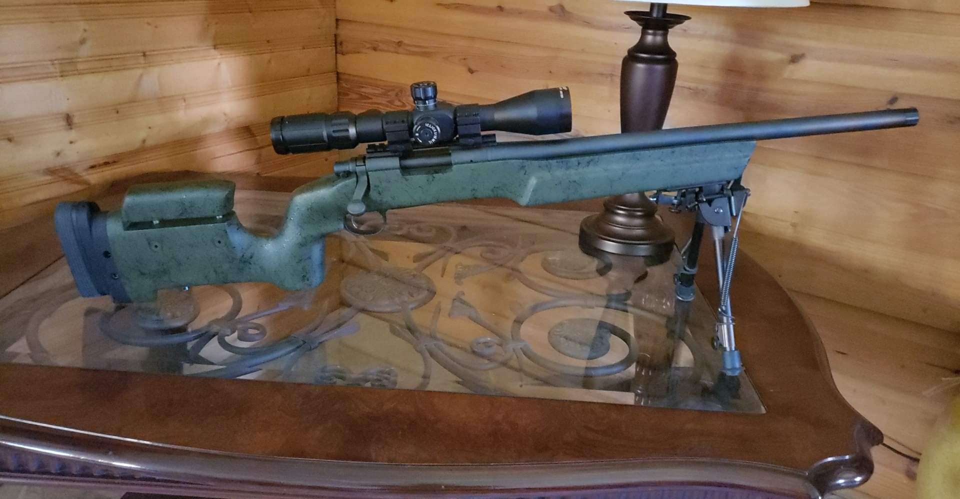

I have the same rifle . I dropped mine in a B&C m40-A1 stock and installed a timney elite hunter .What I discovered was I had picked up to many bad habit's shooting my 6.5 creedmoor . It also is a 700 Remington that I installed a 26 inch .936 barrel along with an odin works muzzle break and have a vortex gen 2 razor on top and I have a krg bravo chassis . recoil is nothing and I find myself getting sloppy . Just work on your fundamentals and take a bit more time getting into a solid shooting position and I think you will be happy .
