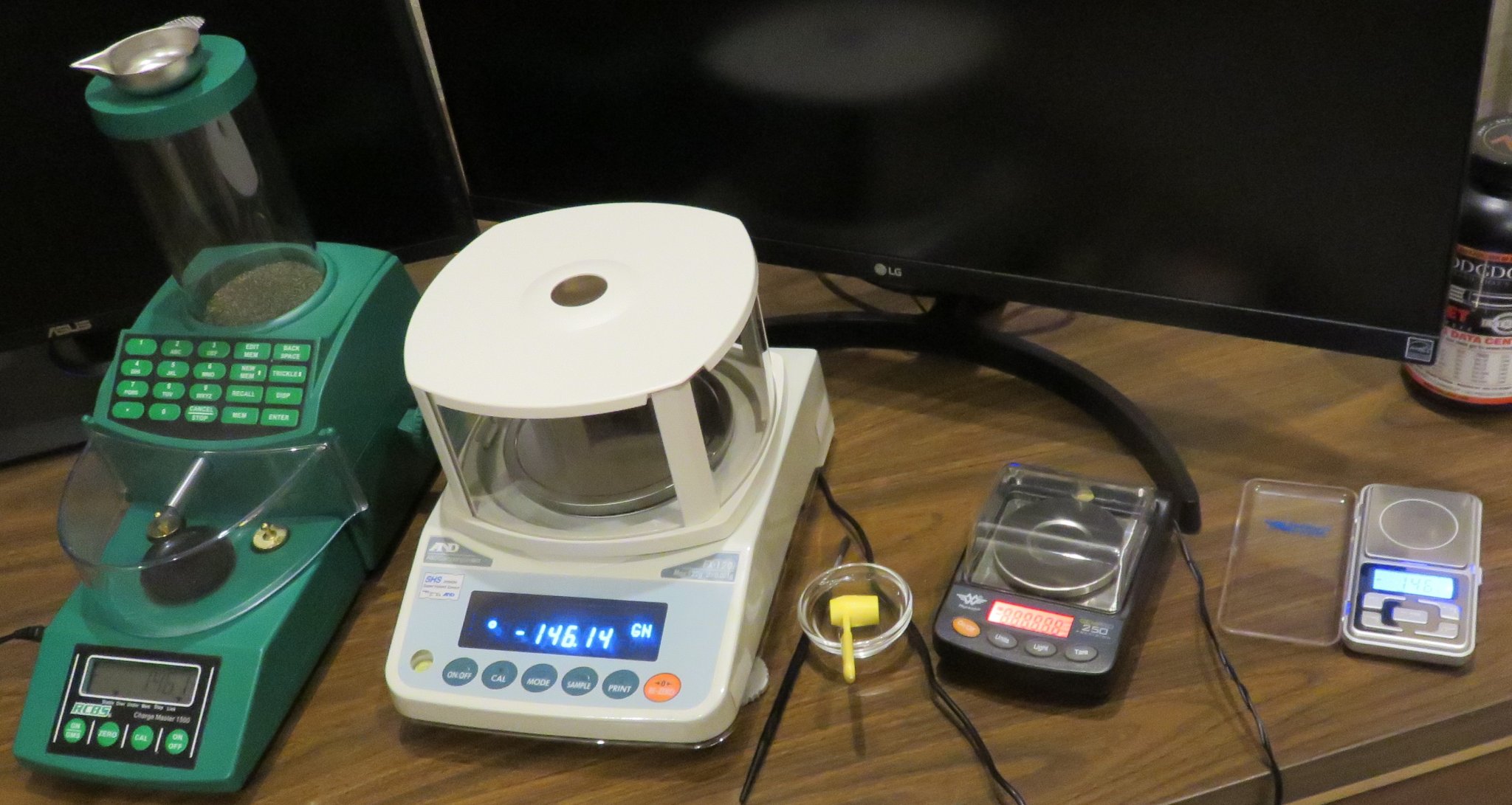

PS: Just so you know that I have a ChargeMaster and an FX-120i, here a pic I took for a comparison of the scales I have:

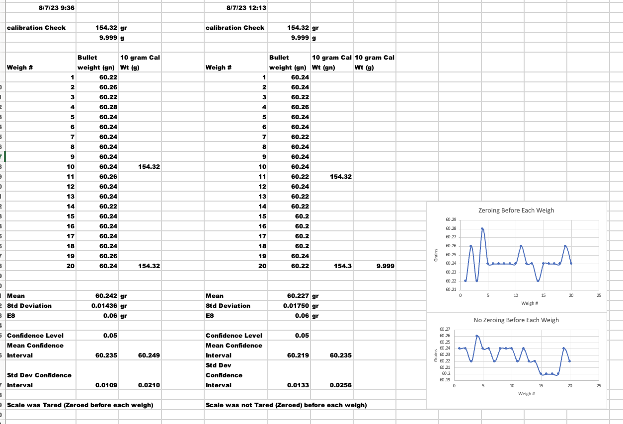

Here is a test I ran on a $25 Gem 20 scale using a 60gn Nosler Ballistic Tip Bullet. This was to check consistency and to determine whether zeroing before each weigh would have a difference.

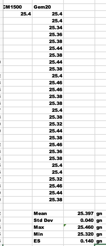

Here is a test throwing a 25.4 gn charge of 8208XBR with the Chargemaster.

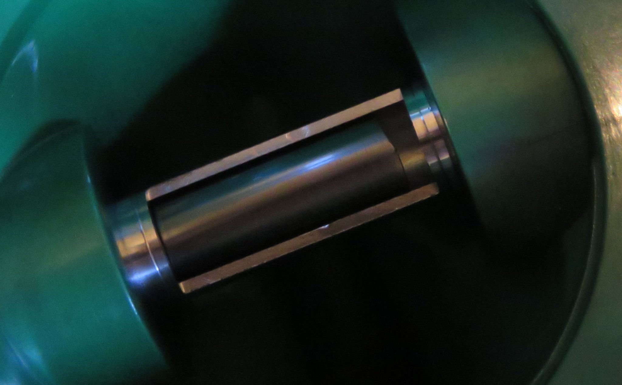

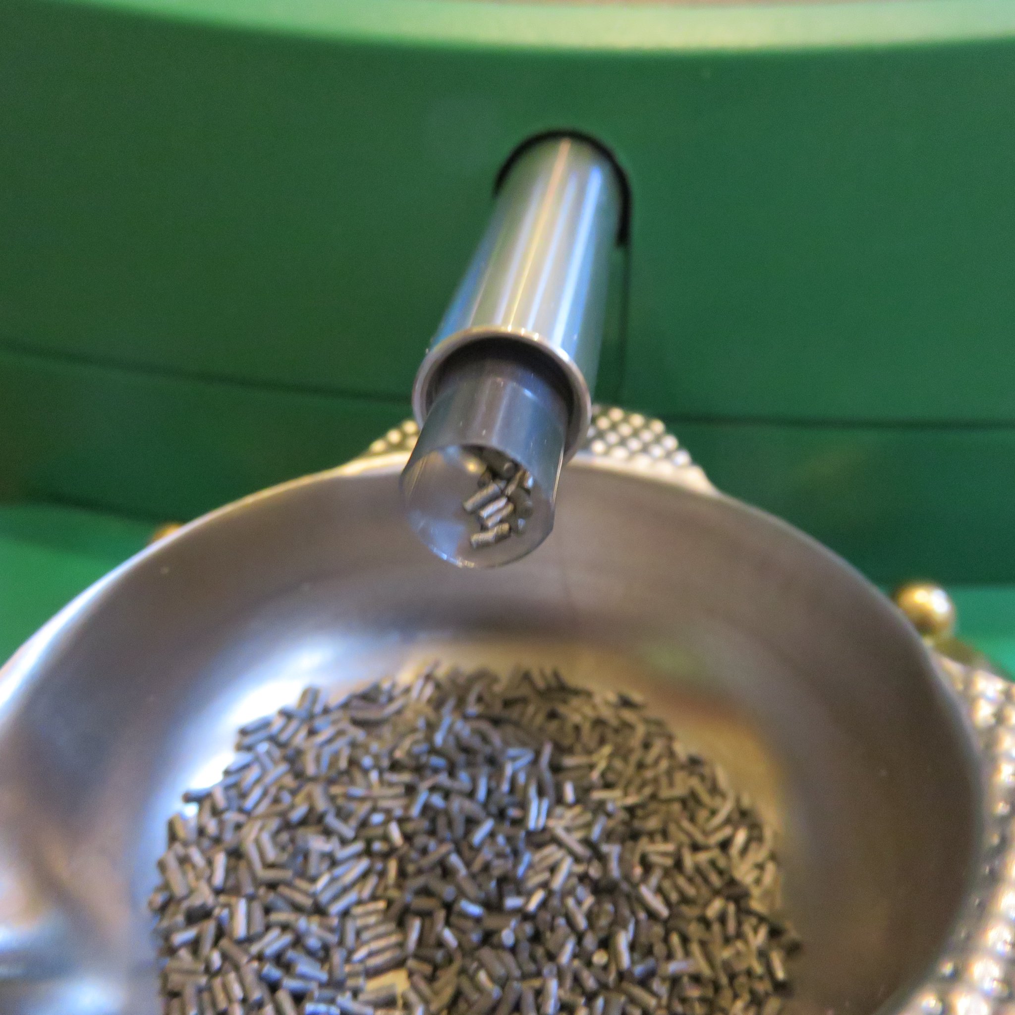

Yeah, I worked out a straw method that helped my CM-1500 for various powders, keeping the overthrows to a small number.
