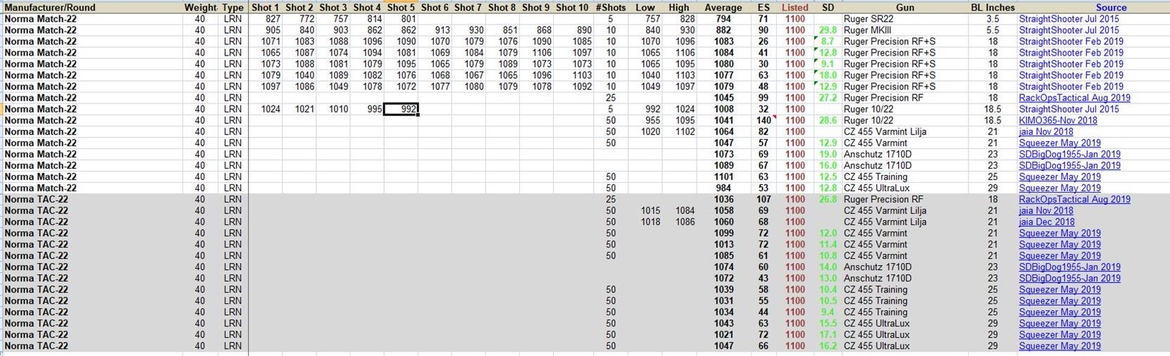

While I don't "know" that they're the "same" projectile, I highly suspect that they are and that the difference is really just a matter of quality sorting that is done at the plant like we often see like with the difference between Center-X and Midas cartridges. So, if you have data for the Norma Match, I'd bet you can use it for the Norma Tac.
If it helps at all, take a look at some data I have on the two and maybe that'll give you some idea:
This does help thank you, that's pretty impressive.
