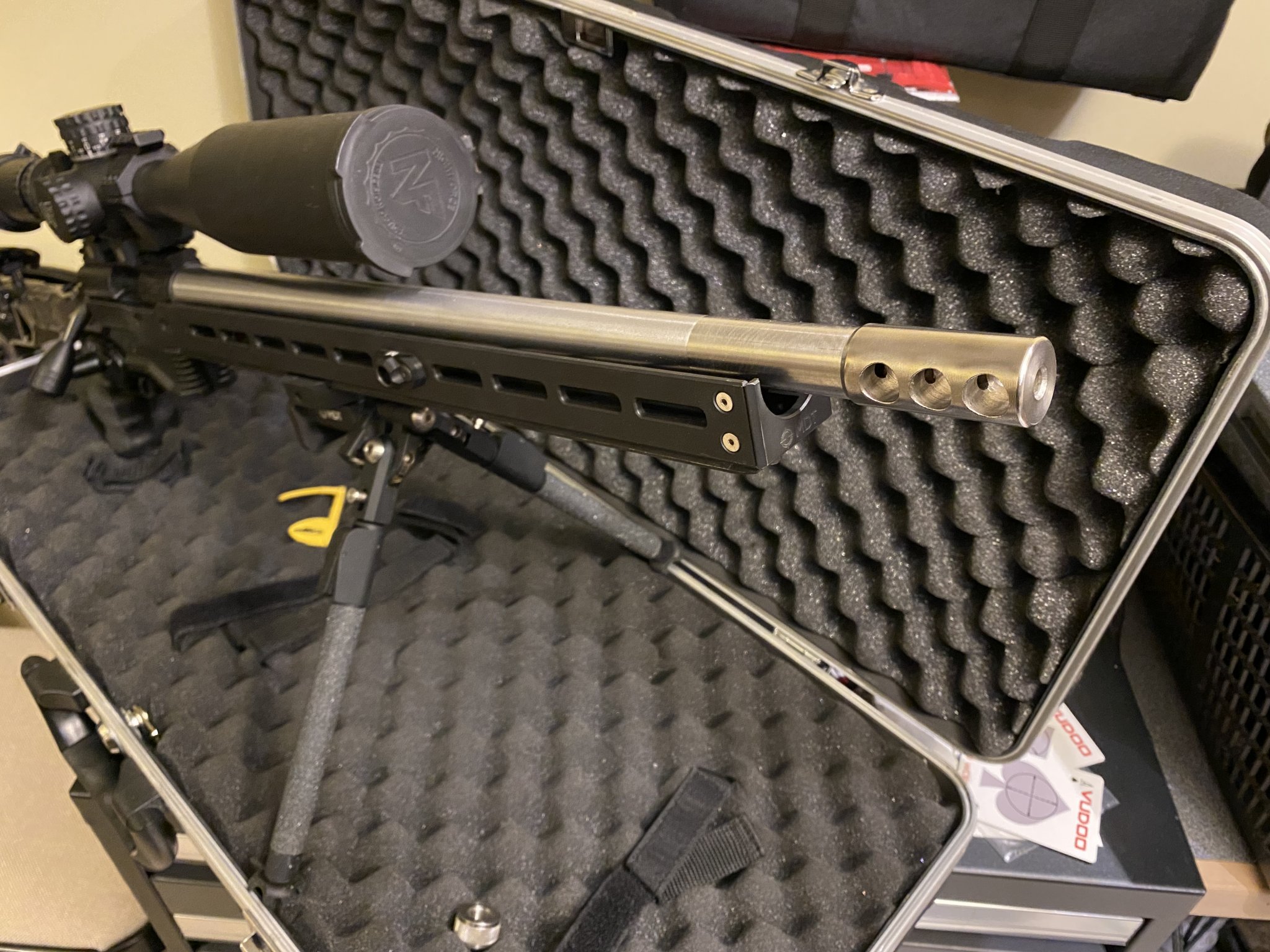

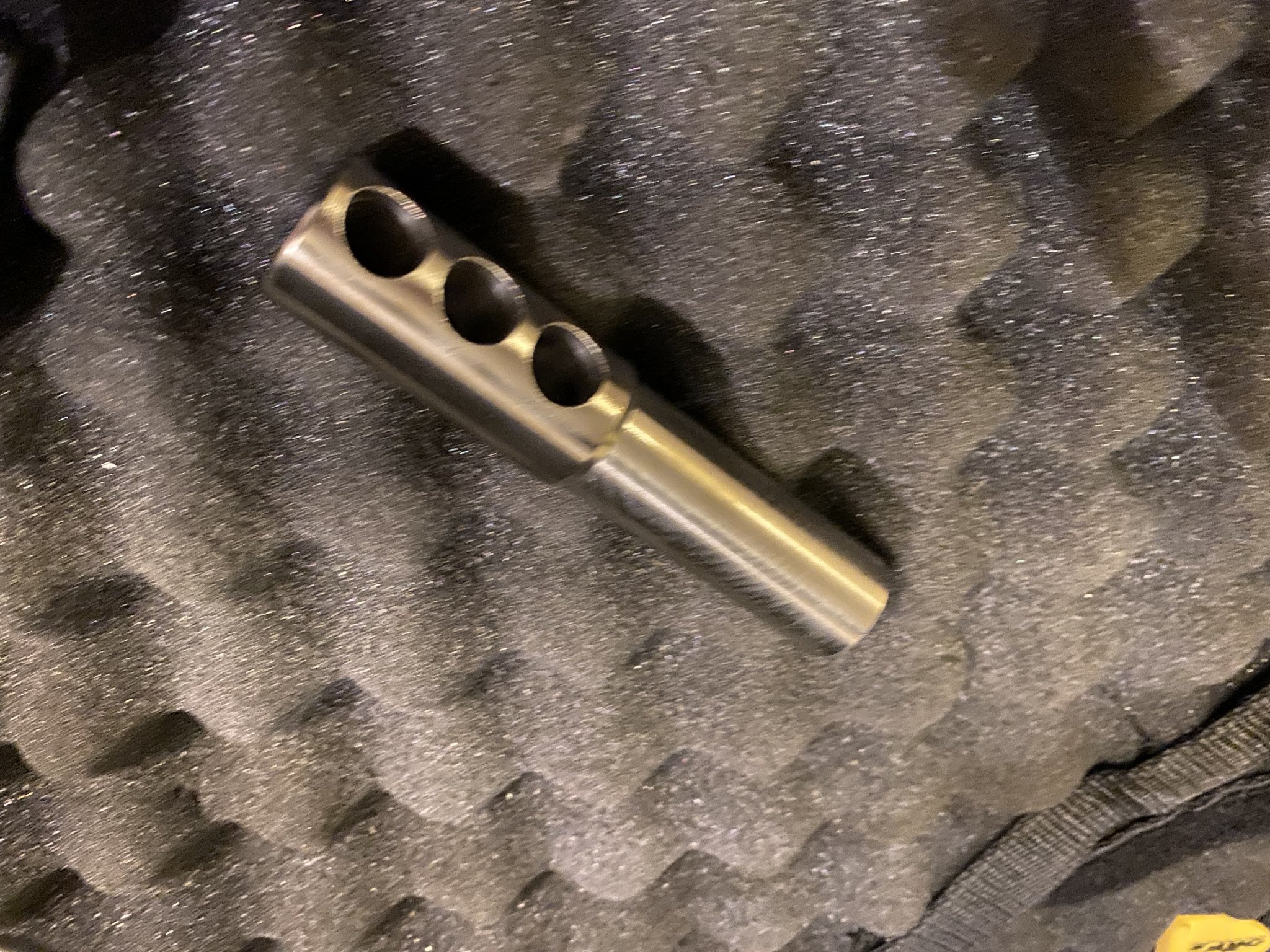

I machined a ~4" long muzzle brake for my 18" MTU Vudoo in an ACC. I bored it larger several times before arriving at somewhere around 0.350" before I saw no change in accuracy based on a couple groups. While lot testing a couple months ago, I shot 5x 10 shot groups with and without the brake, for 6 lots of ammo. I was less rigorous for the remain 3 lots of Biathlon Xtreme (data shared in transonic thread). Across 300 shots, there was a statistically insignificant improvement with the muzzle brake in place. I can post a photo tonight if you wish.
Edit:
Average of 15x 10 shot groups with brake: 1.129 MOA
Average of 15x 10 shot groups without brake: 1.176 MOA
These shot as 3 boxes / lot numbers with the brake, followed by 3 boxes of the same 3 lots without the brake. Distance was 104 yards.
