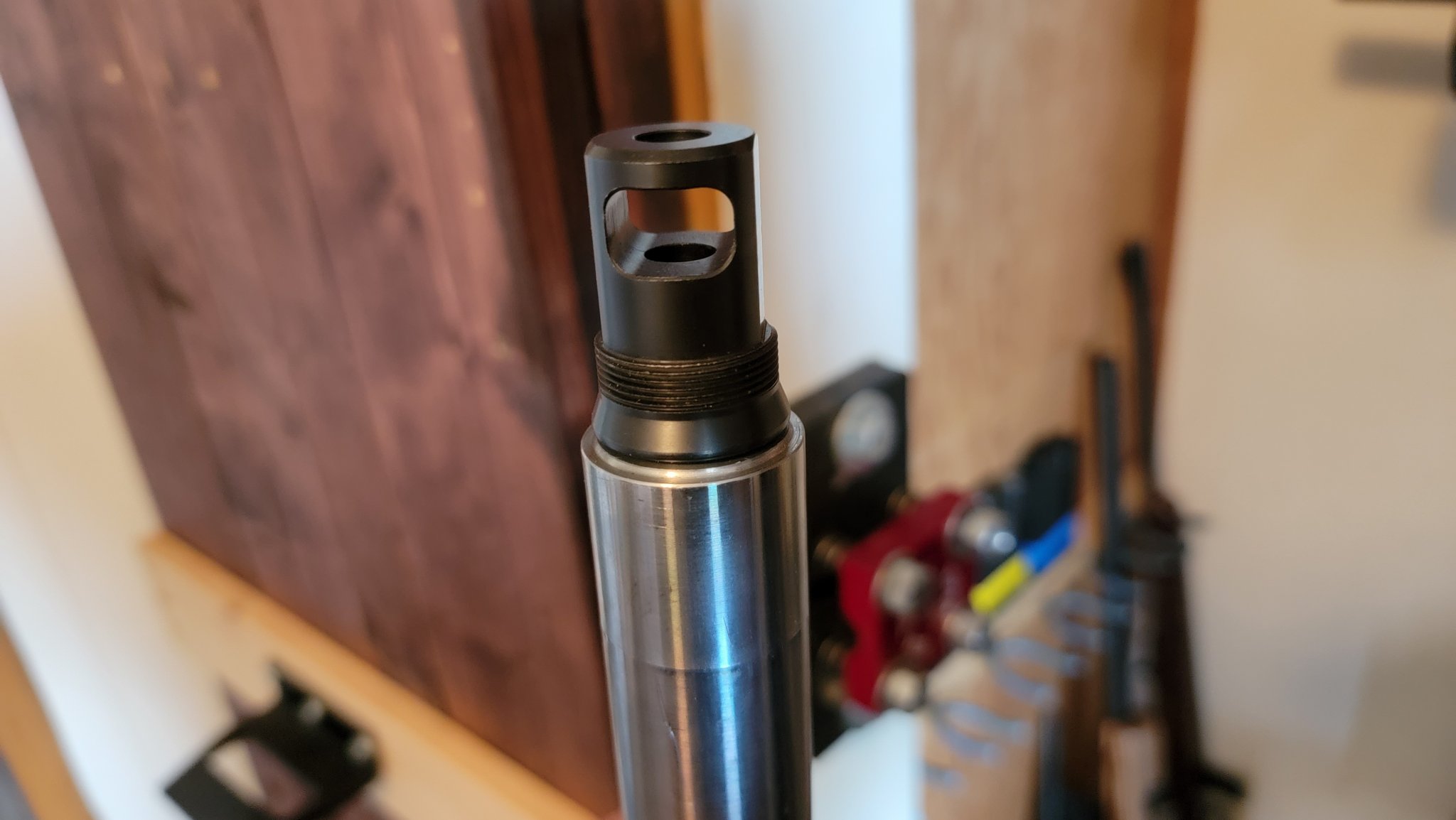

It's a shame they couldn't make a second shoulder on that brake that helps protect the barrel shoulder some more.
I used a Rearden SPB on one of my larger contour barrels, and it's similar to your brake pictured here. Doesn't take much for the barrel shoulder to get a little beat up. The damage is only aesthetic (so far), but something to keep in mind...
Thankfully this was an extremely cheap green mountain barrel and my fist chamber job. Surface finish everywhere but the chamber is trash anyway.
One other note about my experience with the RND CB mount is that I've only used it on smaller calibers, no magnums. I'm just a little hesitant.
