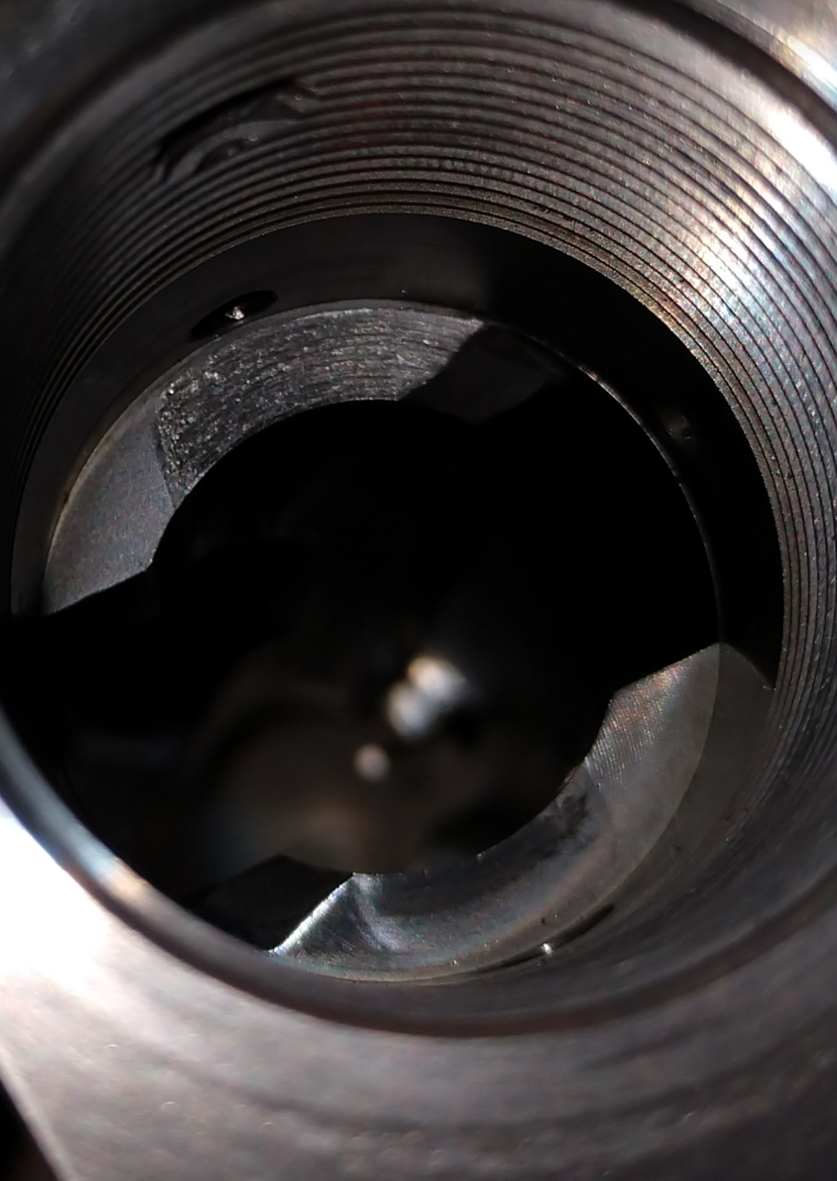

    ****SEE POST #29 FOLLOW-UP****
    Starting a different thread on this topic since I thought originally it was a reloading issue. Long story, short....was having a helluva time at a match this weekend chambering rounds. Thought maybe I hadn't set the die correctly to bump shoulders.

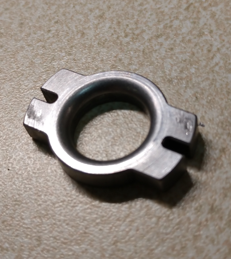

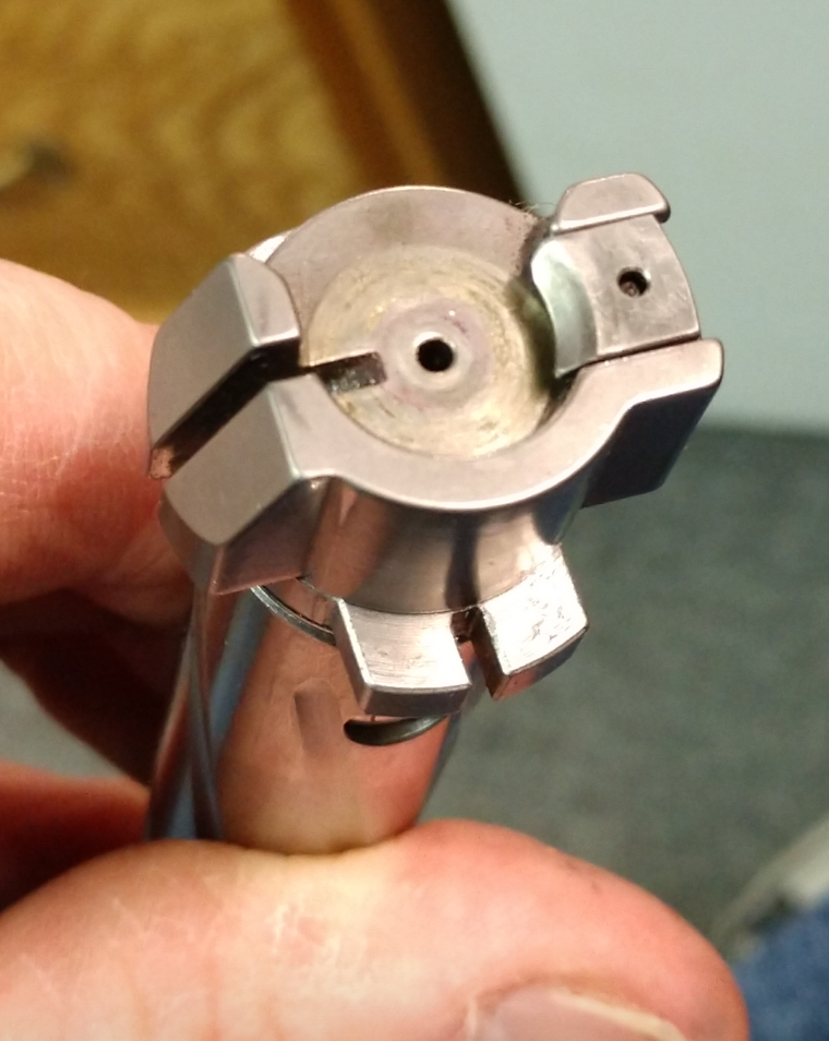

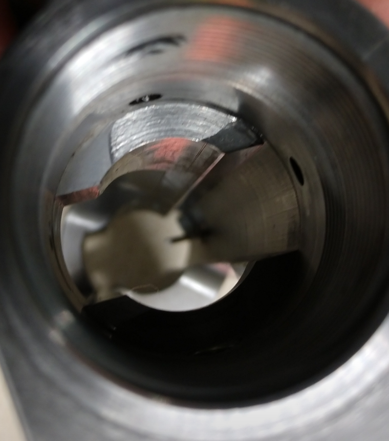

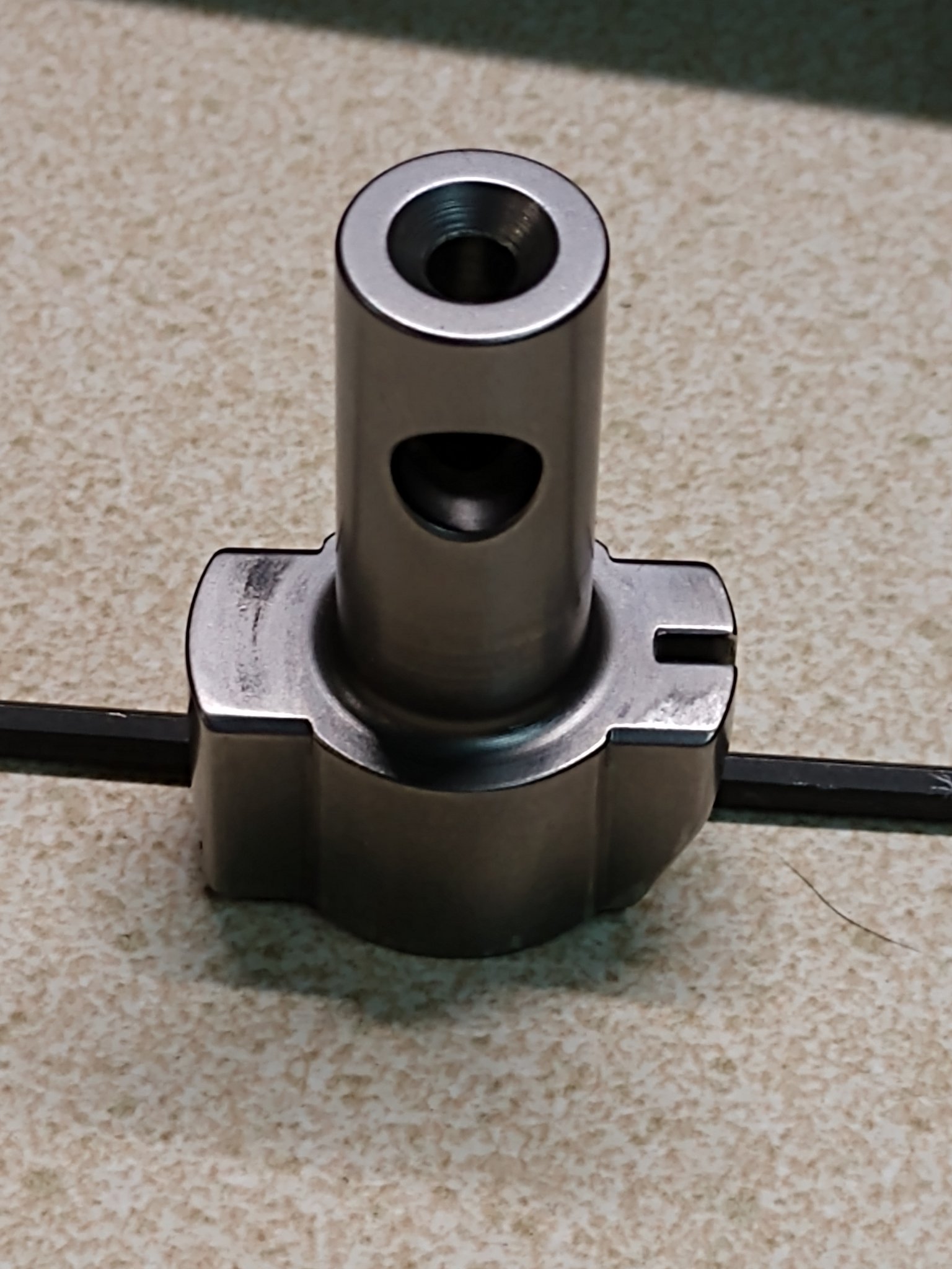

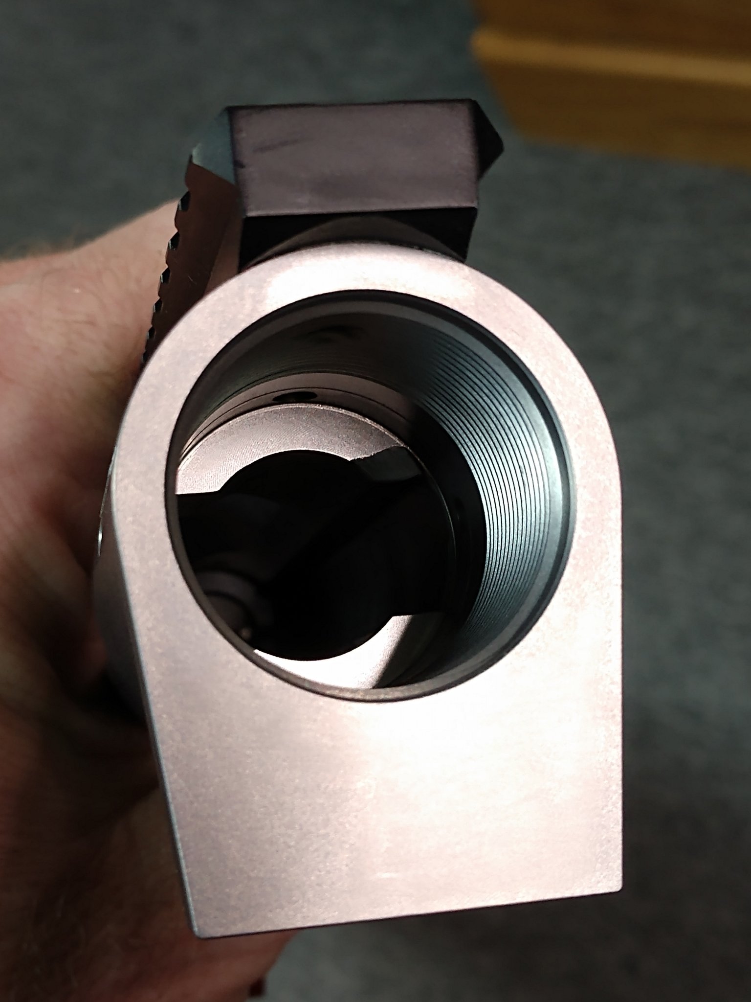

    Took barrel off and found this:
    Something must've got in there? I was pounding the bolt open and closed almost every shot. Decided to not shoot day-2 for safety reasons. Now I'm definitely glad I didn't. What happened and is this action ruined? Thanks.
    We'd like to see it in person. Shoot me an email and we'll get that back in hand to inspect it.
    [email protected]
    Thank you - Ray
    You didn't show the correct part of the bolt that makes contact. But bolt heads can be replaced and the action can be cleaned up. Still need to find out what the cause actually is..... and grease.
    Looks like galling. Did youre action require "pounding open" running it dry? I'd suspect your reloads were exceeding headspace which caused too much pressure to get put on the lugs. Not greasing your lugs could also do this but forcing really tight rounds to chamber is probably the cause.
    Zermatt will get you back in running order I'm sure. Some of the best customer service in the biz.
    Looks like galling of the lugs. Make sure you check your head space next time you shoot again. The headspace may have been borderline previously. Lug setback(wear) will increase that tolerance(stacking). You'll also notice a lot of case head separation when this happens.

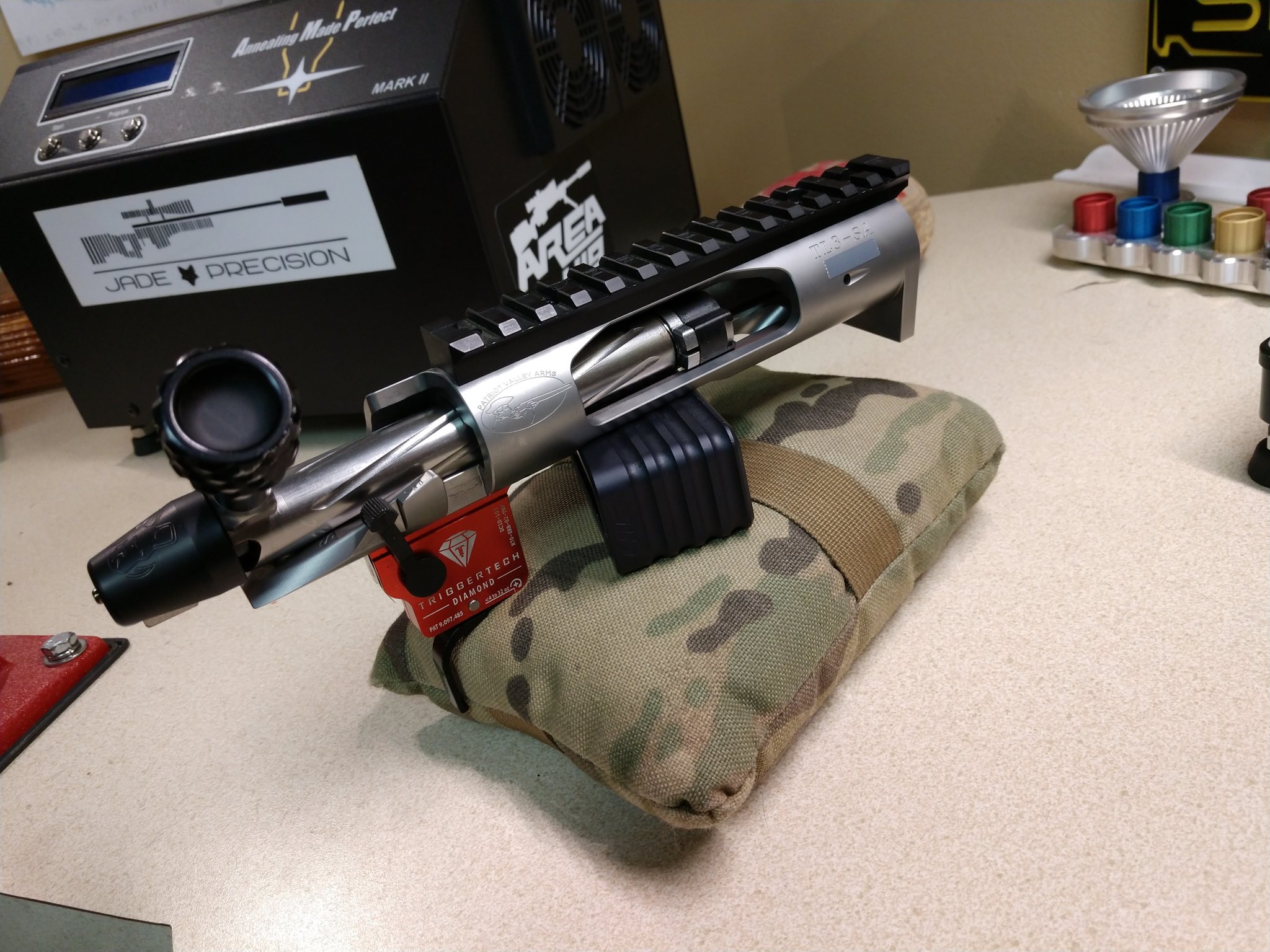

    So this is the first of three TL3 actions I own and my first. It was a pre-order before they were even released. It's been my workhorse since late 2016 and by far the smoothest/slickest one I own. Many thousands of rounds on this thing without a hiccup!
    If you saw my post about it in the reloading section, I bet this is a combo of something getting in there and me being a dumbass and not setting the sizing die correct for this old barrel.
    The loads were not too hot. I ran my tried and true Dasher load, 32.0-gr Varget and jump 0.020". #easybutton
    I believe the hard lift was due to the hard close. It was so hard closing the action that the rifle would cant itself 45° on the bipod. It was ridiculous. Hence why I bowed out day-2.
    I full-length size on a SAC modular die, and use Alpha brass....their older stuff that's not the OCD or whatever. Annealed with an AMP after every firing. Probably 7 firings on this brass now.
    I just think they were too long and I failed to set the die for this barrel. It was my 2020 barrel since my 2022 barrel hasn't arrived yet. I forgot I had a 2021 barrel in between that this die was probably still set to. Oops.
    I can't be 100% certain without this in hand, but if it was that timeline, it could have been an NP3 coated bolt and if that coating starts to flake on the bolt head, issues rear their heads FAST.
    We'll keep our eyes open for your email and get this sorted out. Shouldn't be more than a few tenths off of the lug abutment and a new bolt head to get you back to new.
    Thanks - Ray
    Thanks - Ray
    Email sent. Thanks!

    On a more serious note I had some minor galling on the lugs of an action I bought from a hunter who was switching to 'blast-o-matics' as he had some arthritis and working the bolt was getting difficult for him. When I took it to my gunsmith to make a match rifle out of it the smith cleaned up the lugs and made them square. He said galling is not that uncommon and unless the galling was really significant he could correct the problem.
    By the way, nice job with the photos.

    Well I sent my action and trigger to Ray at Zermatt on 3/1 and they received it on 3/3. I got it back on 3/12. That's fast turnaround!
    Action looks brand new again. They cleaned it up, polished it, timed my trigger and performed the following that Ray relayed to me in an email:
    "The fix was just to drop an endmill on the lug abutment and remove material until evidence of galling was gone. Then, we measured how much we removed with that tool and removed that much from the face of the receiver to maintain the same factory headspace dimension".
    They even replaced the bolt head! Didn't cost me a thing. I've had nothing but amazing CS with Zermatt over the life of this action. If you're shopping actions, don't hesitate to get a Zermatt. You will be well taken care of if anything arises, rest assured. I e owned this one since 2016 and it's seen thousands of rounds, been in dozens of matches and this is the first time I've had to send it in, and it was more than likely my fault.
    From Ray, "We appreciate your feedback! Our goal is to always deliver the highest quality product and provide service to maintain the highest quality product. It's not just a manufacturing process that makes a good product in my opinion, it's a full scale system that includes service of those products that makes them great."
    Can't argue with that!

    I have to ask what grease/lube do y'all use on your bolts?
    @Zermatt Arms (Ray) what do you recommend? I noticed a small amount of red lube on this new bolt. What is that? Thanks again!
    We use Shooters Choice All Weather Grease. It's good to keep some lubrication on the lug abutments and around the stem of the shroud inside of the bolt body.
    Thanks - Ray
