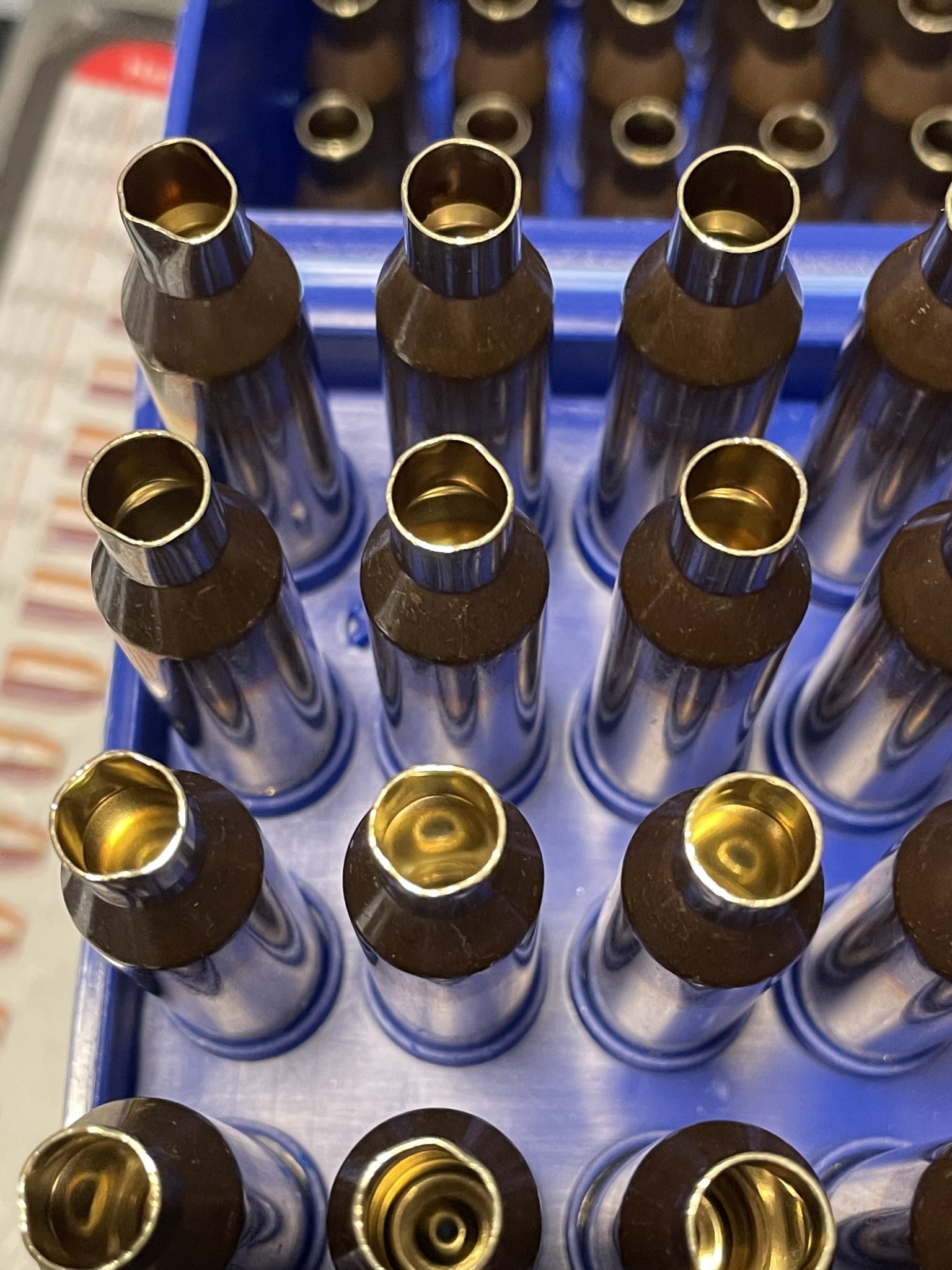

Is this really what to expect from Lapua brass?
My exact response. Lapua comes with excessive neck tension. I run all new lapua through a mandrel before loading.
All new brass should be ran through a mandrel. Its the only way to ensure proper neck tension and has the side effect of fixing the case mouths before loading/Trimming/Chamfering.
Just shoot the Lapua and forget about it, or send them down the road to someone else who will love them and rejoice that they bought perfectly good brass at a discounted price because of a few dents and dings. They will then size them all and have them looking like new in a half an hour..

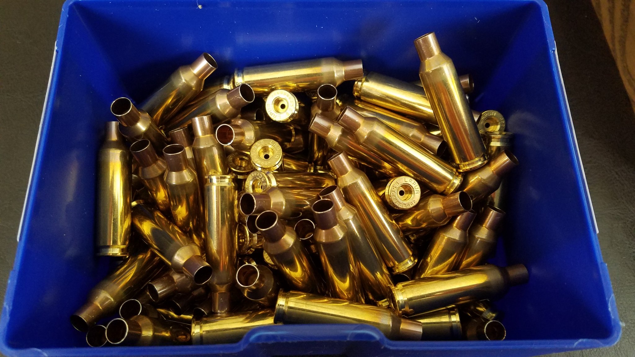

Some times you get boxes like this too

Regardless how the necks look and how bent it makes you....has zero effect on accuracy. Lapua has excessive neck tension and needs a mandrel anyway, they are perfectly round after that.... all the bitching in this thread is just that..bitching....Zero effects on target downrange.
My Lapua 300 PRC brass looked exactly like this and I bitched too. No worries...just FL resize and mandrel. Like Padom said, the necks are way too tight to load out of the box.

A neck has to be pretty deformed to be unrecoverable. Like someone stepping on it or smashing the side with a die.
I have taken some pretty gnarly brass that i swore was dead, run through sizing die, mandrel and hit with the henderson and shit comes out like new.
Brass is very malleable. If you can bend it back to shape, you are fine.

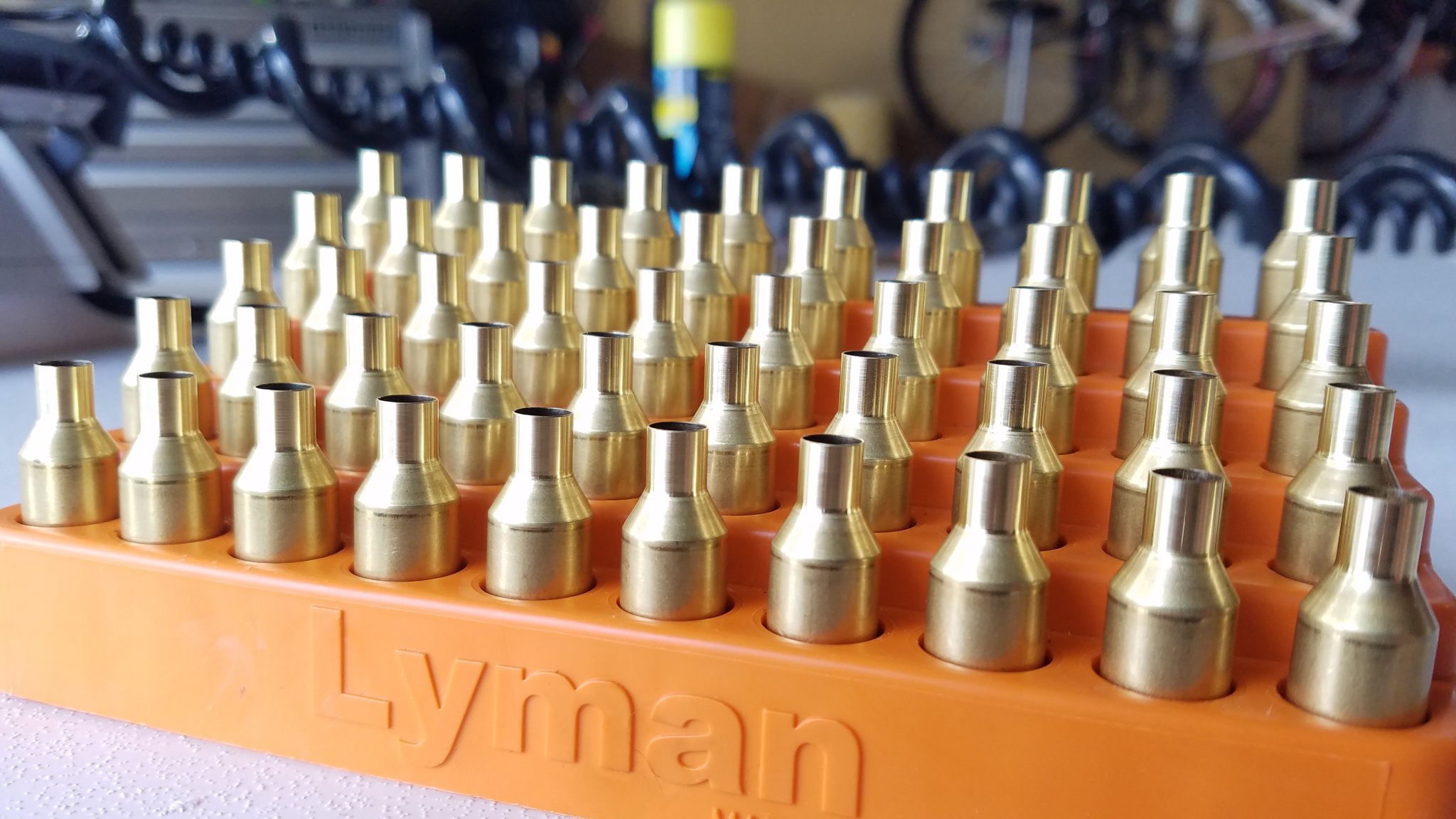

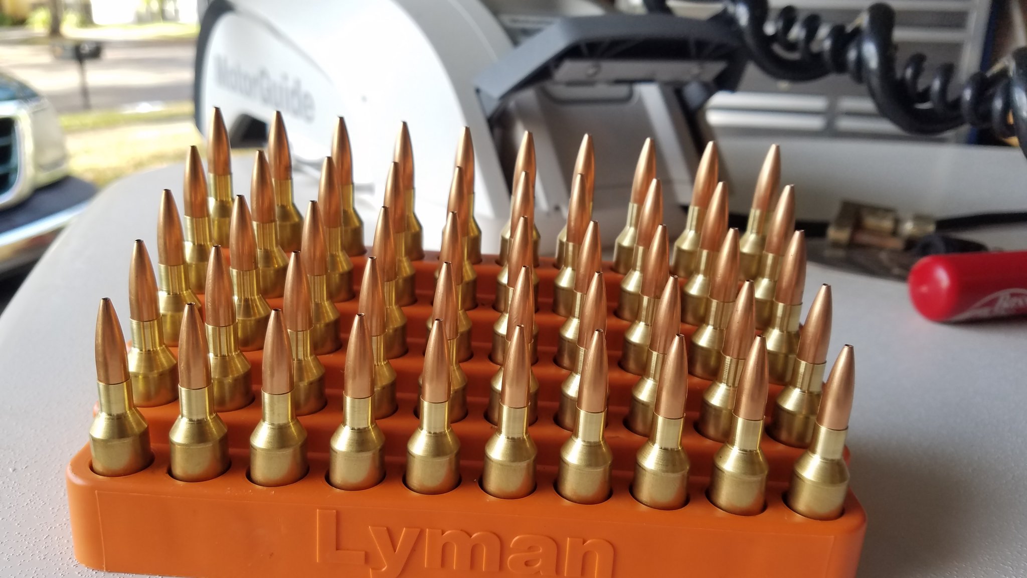

Lookit this:
And this:View attachment 7888514
Just try and tell me that ain't sexy.
Just give it a few tattoos and some red bottomed heels and, uh, .... I'll be right back.

Apparently you haven't read the thread but the fella that's unhappy with his tumbling process.
He wants the INSIDE of the brass to look as shiny as the outside.

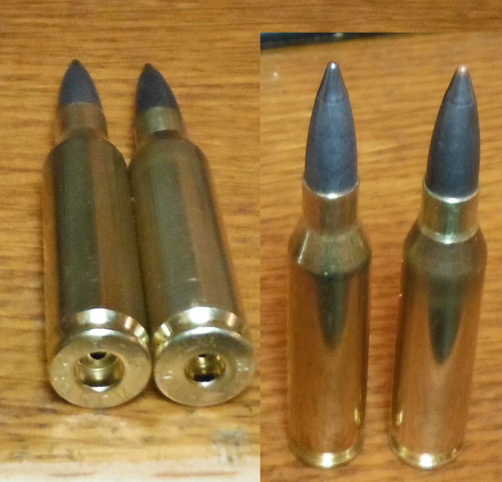

Win and RP brass take extra preparation time.
  • RP 260 brass vs Lapual 308 small primer brass converted to 260 8-24-2012.jpg

My last two boxes of LRP 6.5 CM Lapua brass looked just like that.
The most recent 6-BR had just a couple of dented mouths.
Back in the gold/black, paper box days, none were dented. It was also $37 per box...😭😭
Just picked up 100 6.5 creedmoor LRP and they weren't quite as bad as OP, but many dented case mouths.
