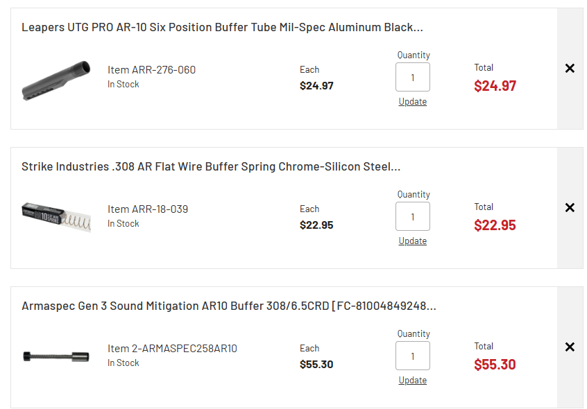

The Q&A on the buffer says it will work with a fixed A1 & A2 stock. Why 'fixed' I'm not sure, because the tube doesn't collapse, the stock does. I do not know if I what I posted will work with eachother.

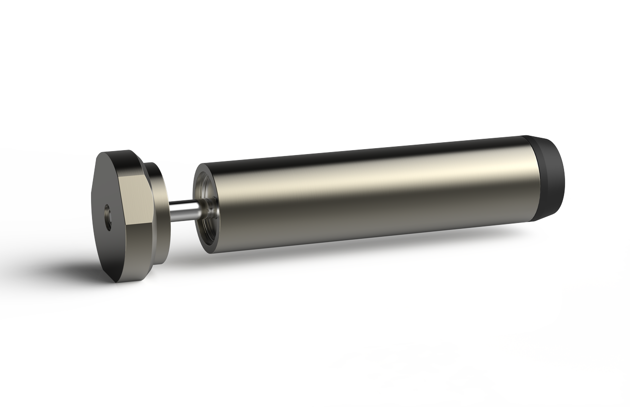

The armspec is a sell contained buffer/spring like the JP silent capture set up. It’s completely stand alone unit, nothing else is needed. Just make sure you get the right one for the buffer tube length you have.
You need a different buffer if you want to use the flat wire spring. Do not get the fixed stock buffer if you plan on using the buffer tube you listed. I do recommend spending the money on the kyn shot. But I’d also add an adjustable gas block. You can really make a nice shooting rifle with all those components. I haven’t seen too many 308 ars that didn’t need an adjustable gas block.

What about this KAK tube? It says A5 components only?
I was referring to the standard rifle buffer tube, early in this thread I thought you were referring to the A2/rifle buffer tube. But then I seen you clarified that you are using a carbine buffer. Lots of confusion early on. Lol
This buffer you referenced is 3.25" long, which is the same length as a standard AR15 carbine buffer. This means on a 308 you have to use the "A5" length buffer tube. This is also the Armalite "308 carbine" length tube. The tube internal depth should be 7-5/8".
This buffer will NOT work in a 308 with an AR15 carbine or collapsible stock length tube, which is 7" internal depth.
This buffer will NOT work in a rifle length or "fixed stock length" tube.
