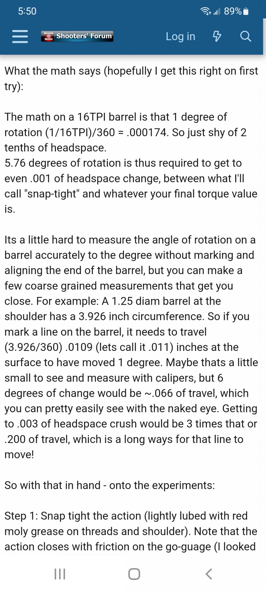

    Really good write up off of Accurate shooter for the math. I didn't verify the math, but I know this discussion has been repeated on here and from what I remember, it was very similar results.
    .002 is enough to have a round chamber or not chamber based on where you bumped. Also, depending on who cut the barrel, what action you are using and if any work was done to the action, you may or may not have a concentric threading that fully seats the barrel on the recoil lug. The surface finish could also effect this value. If you aren't using a good anti seize, go crank on 150lbs plus stainless on stainless and let us know how that works out for you.
    There are steps and measures we take to ensure we get the optimal performance of the system. A properly torqued barrel that can be repeated is one of of them.
    There are enough "bad" smiths out there I always hear recommended (Yet have examples of them doing terrible work), I would be interested in learning which shop Rob is talking about. We are very selective about who we let build our guns and chamber our barrels for this reason. 100% function is the primary and secondary goal.

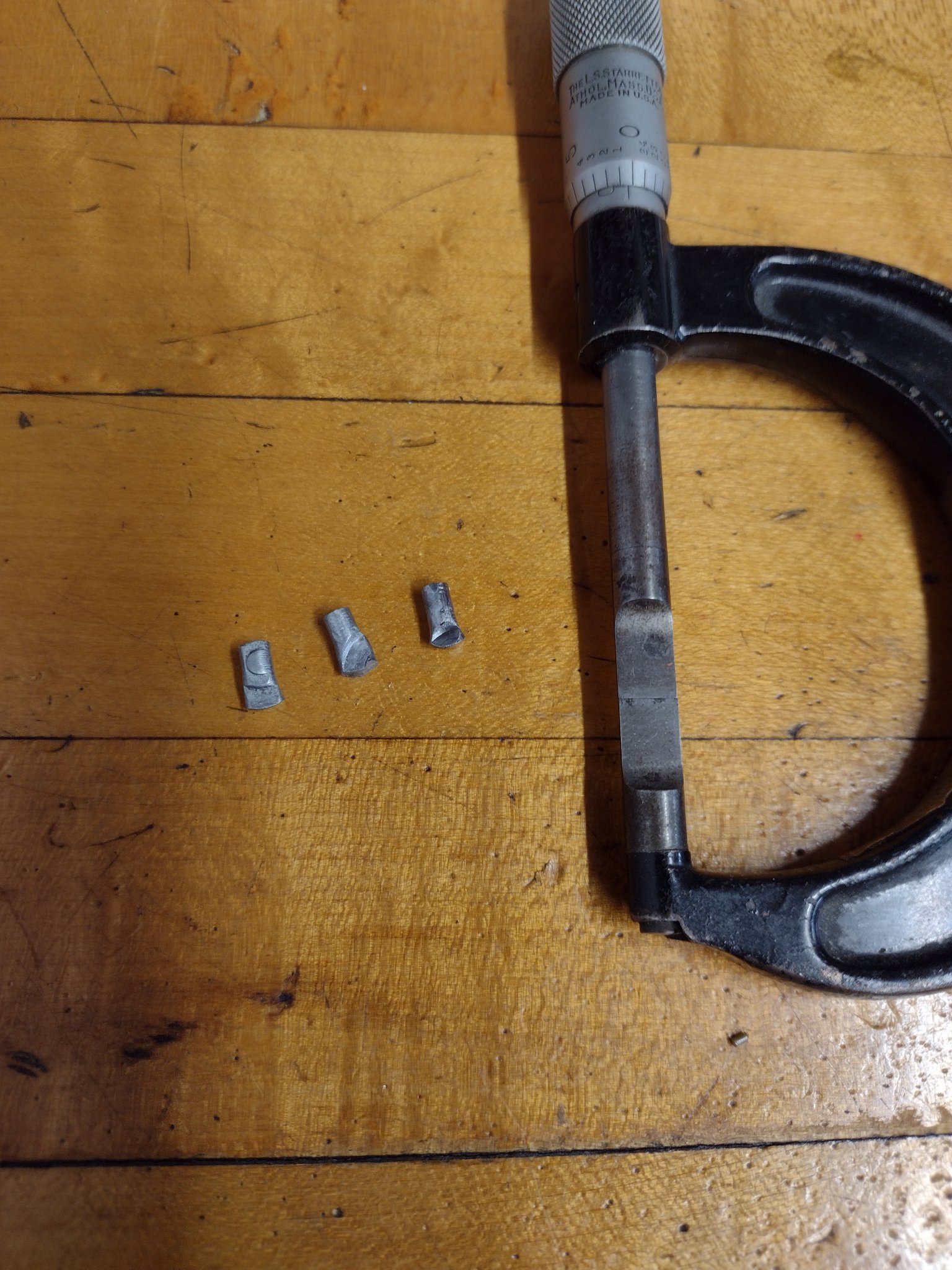

    Informal test time... I have a bighorn tl3 with a shouldered 6.5 creedmoor barrel. I also have a GO gauge from a wildcat I did a while back that has the creedmoor body/shoulder geometry but is roughly .075" shorter on headspace. I grabbed a few chunks of lead and smooshed them between that guage and the bolt face as a sort of comparator for change in headspace at different torque values.
    Hand snug- .0742
    80ft-lb- .0736
    120ft-lb- .0731
    So about a thou. I know I've seen .002 or nearly that going from the lathe to final assembly before, but that may not be necessarily representative of swapping a barrel that's already been mounted before.
