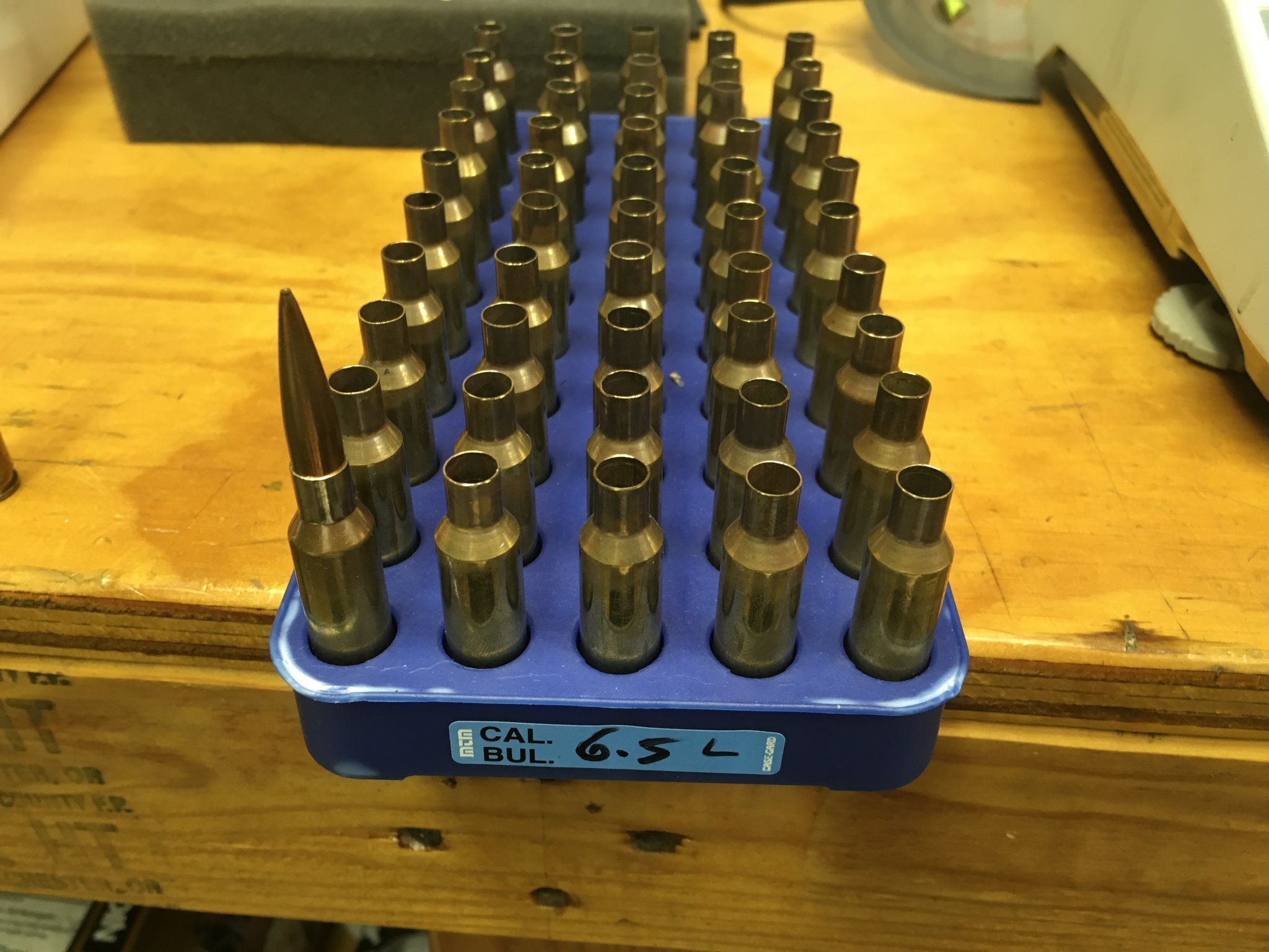

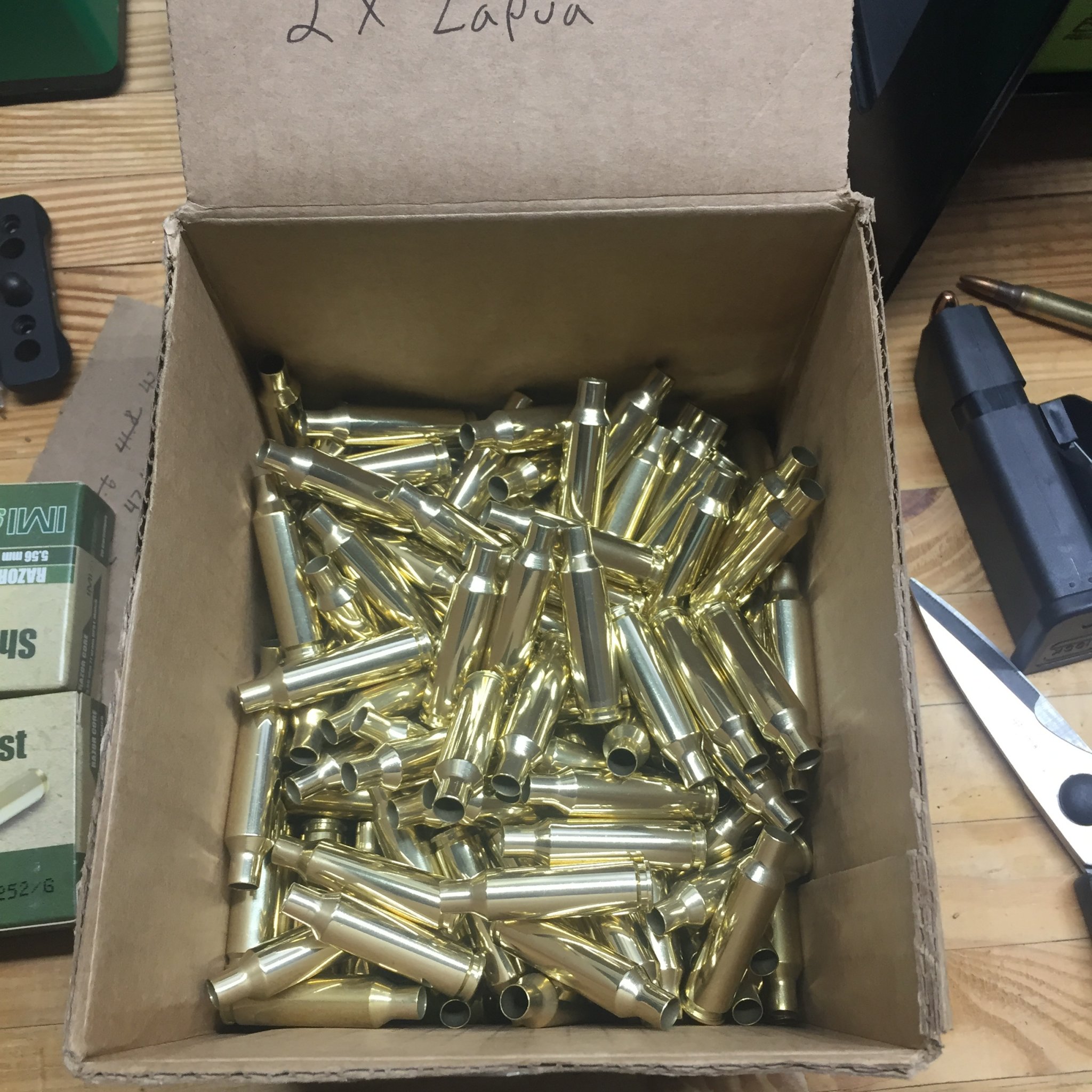

I stopped using my wet tumbler with pins except for pistol brass. Stopped using pins entirely and switched to the little stainless steel balls found on Amazon. Trouble with wet tumbling, it beats up the lip of the neck, and gets it too clean as stated above.
For my bolt action rifle brass, I decap and use the ultrasonic cleaner with Hornady brass cleaner and Dawn. Rinse, dry, neck size, and anneal. Trim if necessary. (Full length size when necessary)
On my 12 reloading with my Lupua brass still shooting great.
