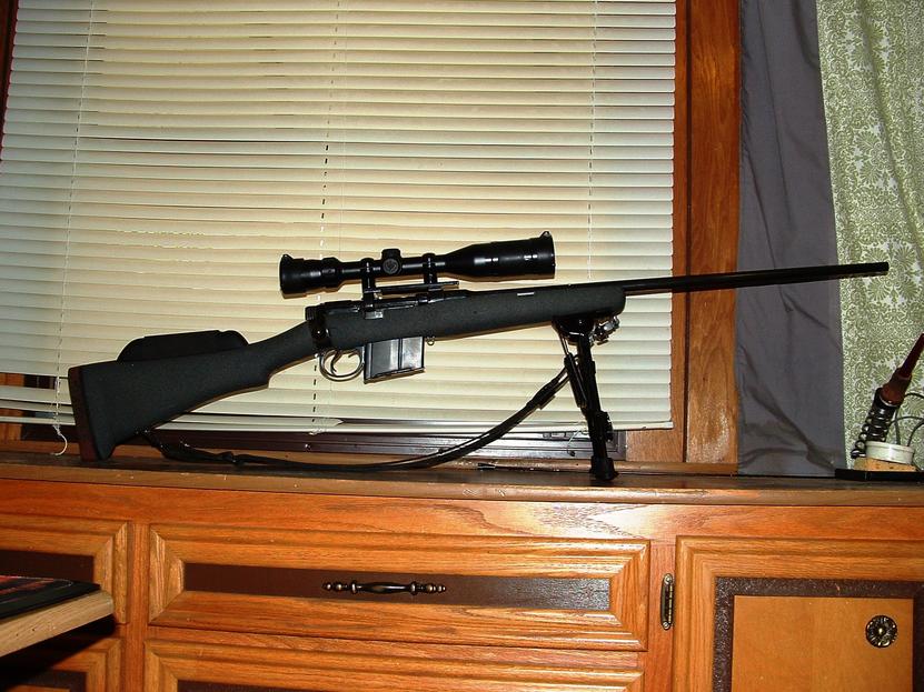

I found a load that approximates the NATO load and stays within the chamber pressure specs. I'm using once fired NATO 7.62x51 brass, 150 Gr. Sierra FMJ bullets, 50.1 Gr's of Winchester 760, with CCI primers. This load is rated at 40,100 CUP (Copper Units of Pressure) which is right at the NATO spec of 40,000 CUP. I haven't chrono'd the load but it will shoot 1.5 MOA @ 100 meters with the scope off a rest (on a good day - LOL). I've included a picture of my Ishapore 2A1 Tactical that I us my loads in.
