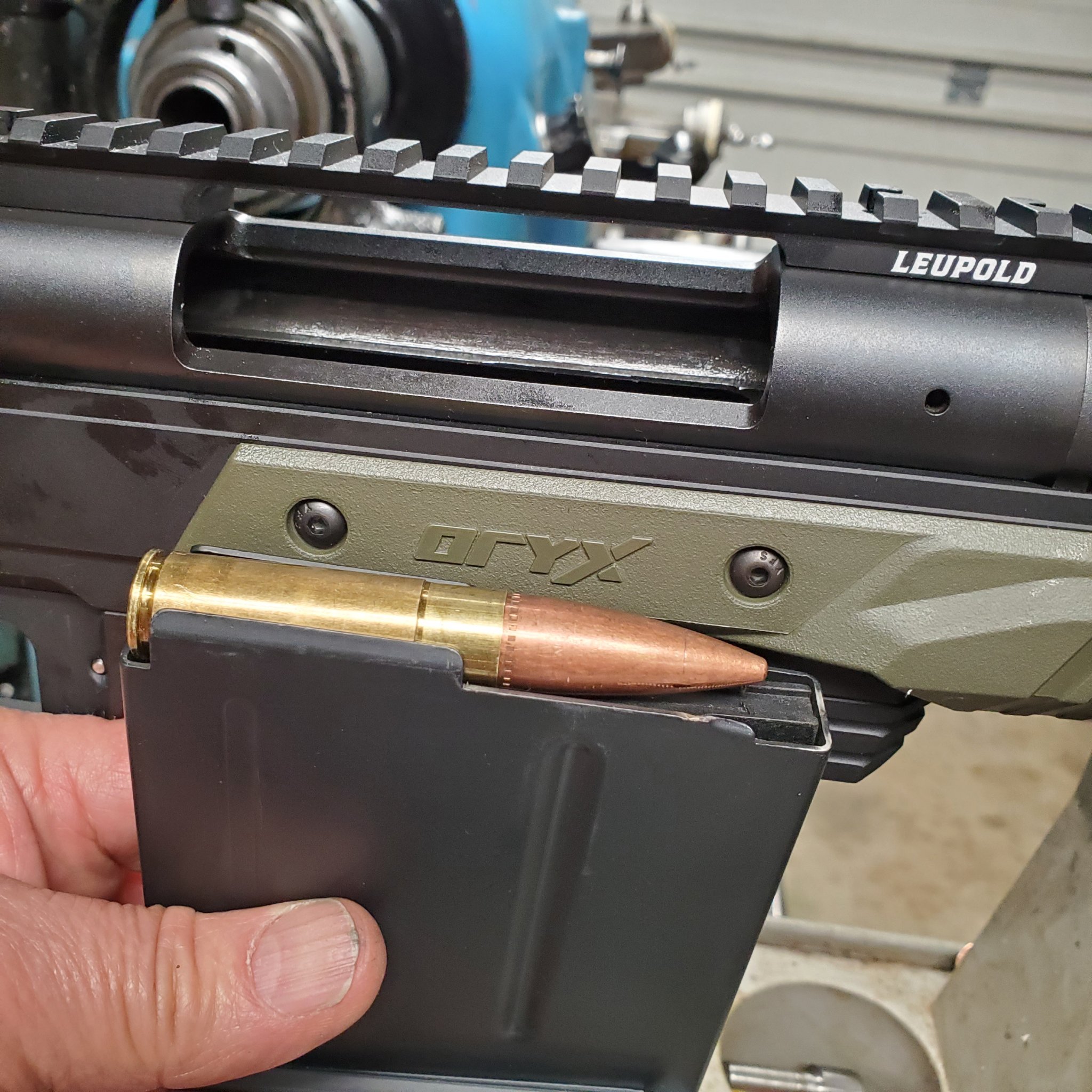

The Rem long action 300 win mag and 338 lapua have the same foot print to bolt up to a chassis.
I use MDT mags in a chassis, some chassis have a limit to the COAL length of mag that will fit their chassis.
I just used the same chassis on a 300WM and changed to a 338 bolt and barrel for a .510 Whisper.
The Chassis is limited to 3.715 mag for 300 WM or 338LM.
Running the 300WM at 3.715" makes a world of difference in its performance 2962 fps for 230 match bullets.
A 3.8 mag will not fit a 3.715 mag well.... Is your only concern.
This 300 WM is now bolted for 338 Lapua cases in 510 Whisper...
