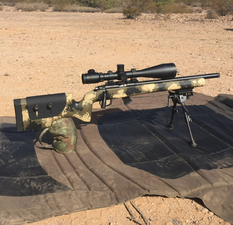

I bought an oversized bolt knob from a guy on eBay and works ok for me. It does take some getting use to from the factory bolt knob but so far I like it.

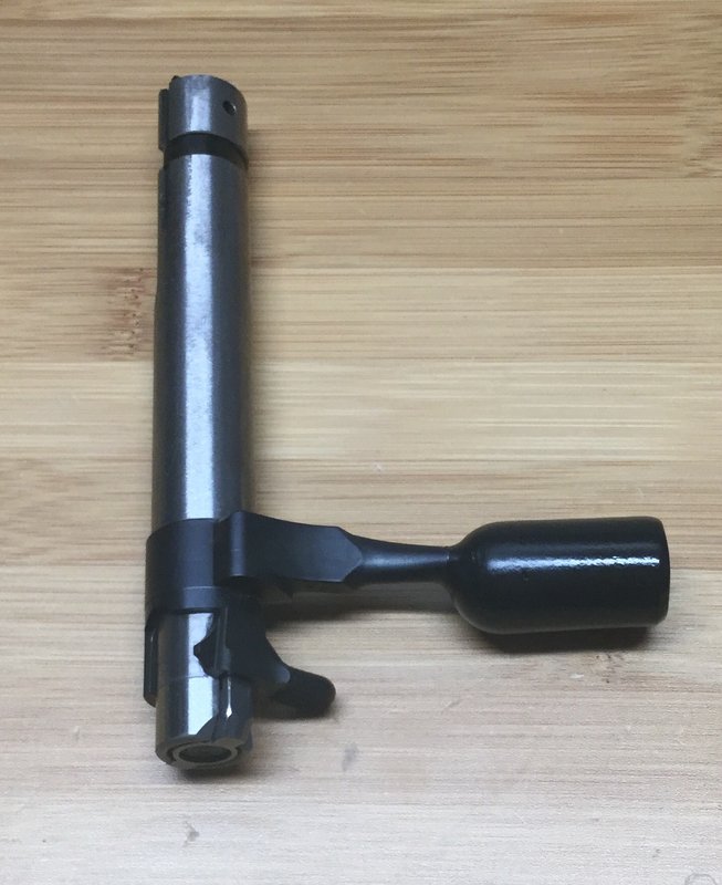

Here’s my DIY 455 bolt handle. Total cost around $5, maybe 20 minutes of work, and a little time waiting for Devcon and paint to dry. No cutting or welding was necessary, and I didn’t even bother to disassemble the bolt. This is the original bolt, so function is identical. It clears my trigger finger when closed and my Bushnell 6x24x50 and throw lever. I didn’t take pictures in process but I can write up more detail if anyone is interested.
The glades handles have the issue of hitting your trigger finger in some stocks and then the fit issue. Some actions they won’t even function properly on. Best to have a knob fitted to the factory handle!
