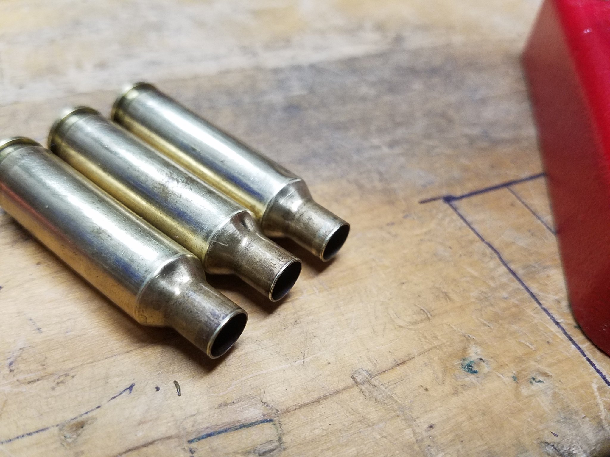

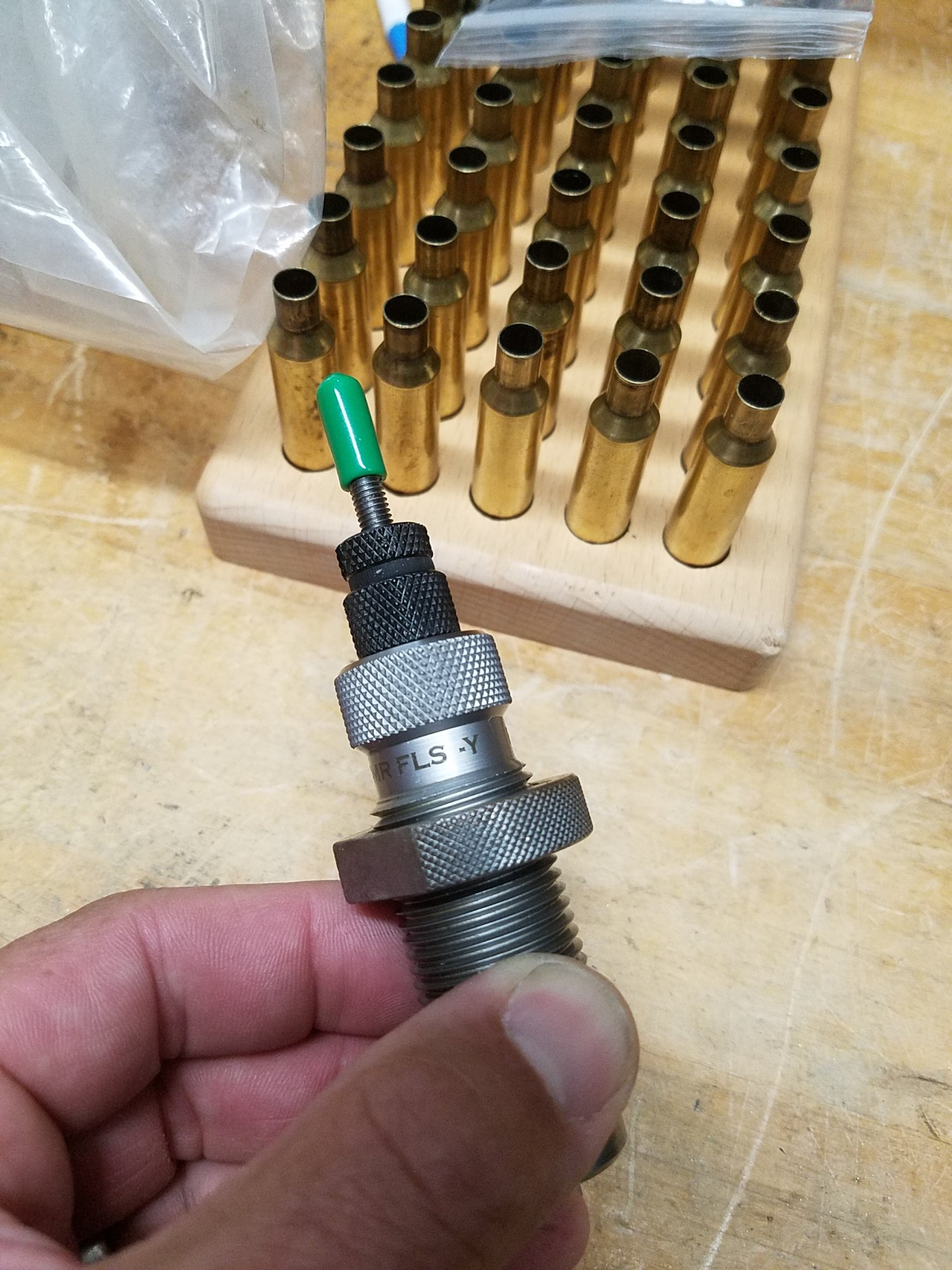

I'm new to precision reloading and setting up a Forster FLS die in 6.5CM. Brass is Hornady once fired through my Bergara. I tumbled it for 1.5 hrs in corn Cobb with a splash of New Finish. Then used Hornady case lubes. Die is set between 1/8-1/4 turn past bottom of stroke. First case came out fine but the next three have dimples at the neck.
I ran a brush inside the die and then a wet patch and tried again. Two more cases came out dimpled.... one of them even worse than pictured above. Then I backed off the die to where it's not bumping the neck back and it does fine.
What might I be doing wrong?

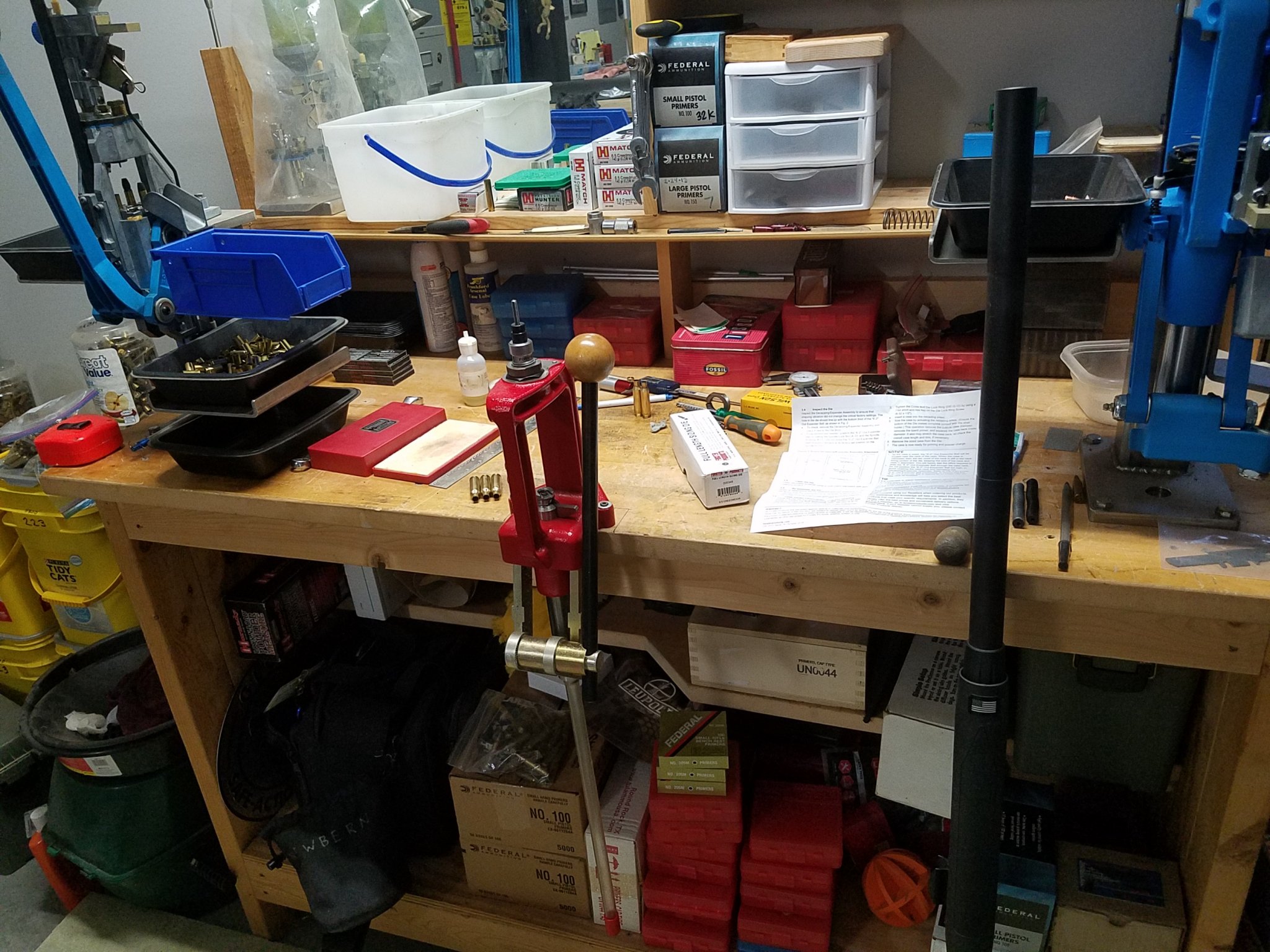

The top of my bench is flexing down when I size. Could this be part of it? The flexing causes the motion to not be one smooth motion. I intend to make a riser like I have done with my other presses.
Here's my set up. I've been reloading on a SDB and 550(223) for quite a few years but I've had my 223 brass processed.
I always lube my shoulders because I spray lube as well.
It could be too much lube... or it could be just simply not allowing enough time for it to dry and for the nonlube part to evaporate off. Let it sit for 15 minutes where it can breath and air can pass over it and then try again.
Though at this point they may be fine. If they are still coming out like this then you have too much.

You guys were correct. Seems like a rookie mistake now, lol. I just did 35 cases with minimal lube and all is well. I'm getting the hang of it now. Too little lube and the case gets tight and the rim pulls down a little which I'm learning affects the headspace (using the Hornady comparator).
spilfe7980, I didn't let the lube dry at all. I'm using Hornady lube and a pad, not spray lube. I'm assuming this is correct.
I have some spray lube but not sure if it's OK to get into the case necks. It seems overspray into the necks would provide inconsistent coverage.
Thanks for your help.

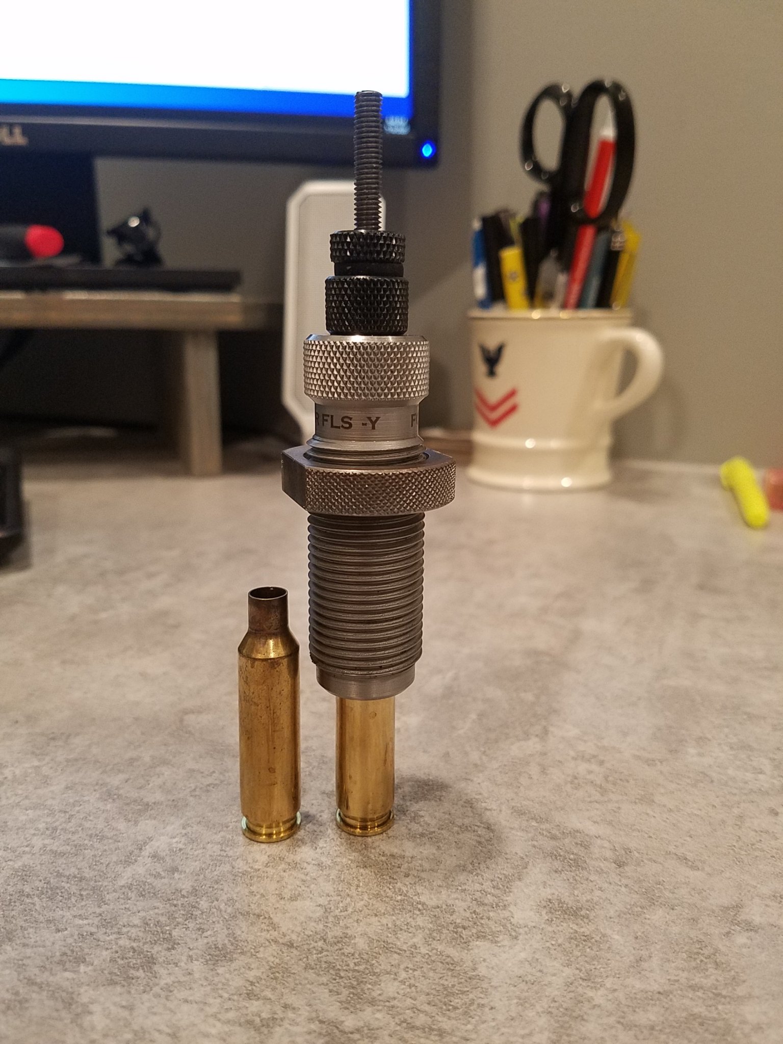

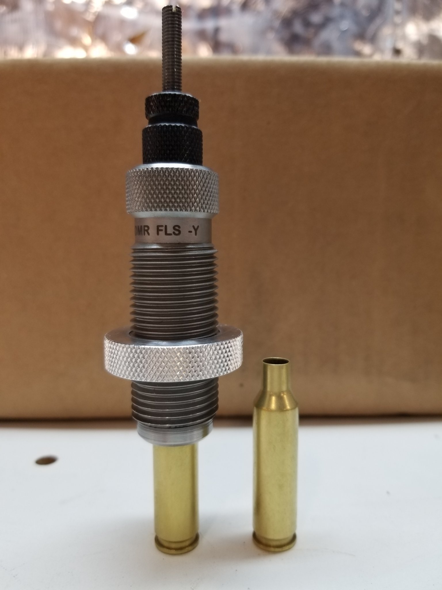

Is the die marked "FORSTER 6.5 CRDMR FLS-Y" ?

thank you for posting this.....as is my fortune, i waited almost a month for this die to arrive....and of course the die is undersized. your post saved me from having the case get stuck and spending too much time trying to get it unstuck and figuring out the problem.
Reactions: Timo Turl
Thanks for the info, I'm undersized too. I sure thought it took a lot of effort to resize these, but that explains it.
Glad I was beginning with my Hornady brass, I would have been pissed if I would have ran my Lapua brass through this.
Come to think of it..... it IS a problem with the Forster die. That was my last guess. ;)
I suspect I was still using too much case lube. I appreciate the responses and advise on all.

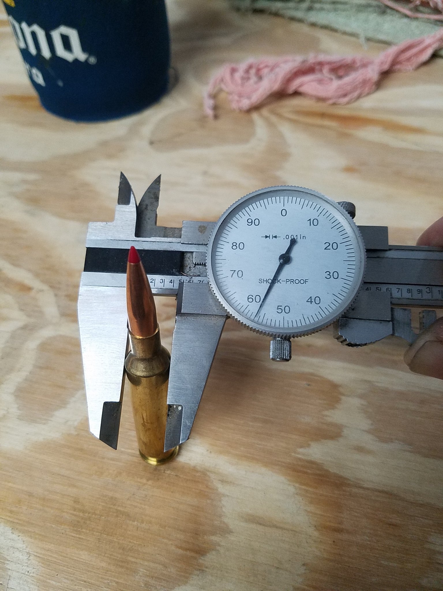

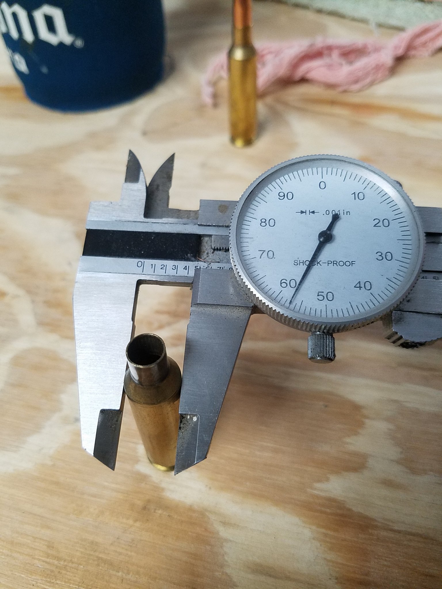

Case diameter at the neck with this "undersized" FLS-Y is the same as Hornady 140 Match ammo. Thoughts?
well that’s not the neck...
What did Forster say was undersized? The body portion? Idk could have some spring back in there but could still be overworking the brass.
I wouldn’t chance it.
Neck, lol... I knew that. Top edge of the body. I hope that the die is undersized. I'm looking forward to hearing from Forster.
I think the denting of the shoulder is the lube, but POSSIBLY exacerbated by the undersized die. Let us know what Forster says, hopefully its a quick turn around.

I got this from Forster this morning.
Thanks for contacting us about this, we did have some dies within that batch that did not get cut with the finish reamer (not all dies were undersized). If you would provide us with your address, we will send you a mailing label so it can be sent in for our review and replacement if needed. Sorry of the inconvenience.
Scott Kempel
Forster Products Inc.
I responded with this and included the photo that I posted above
Scott,
Your company makes very nice parts. I've been a machinist for 25 years and I'm impressed with the fit and finish on the dies. :) I appreciate the way you're handling this so far. I've included a picture that might help you determine. The die is sitting on a case that was fired in my 6.5 Bergara Pro.
Thanks,
Ryan
He responded with:
From the image, yours looks potentially ok, I think it would still be best if we sent you a label so we could check for sure, we will send one later today.
Scott Kempel
Reactions: Gustav7

I got a shipping label yesterday at 4:08 pm CST. I shipped my die out this morning.
just wanted to follow up on these posts......i just now received the package from Forster....they sent me a brand new die in box. took a total of 9 days, not too bad. just resized 10 cases and it works nicely.
That's great to hear, thanks for the update. I haven't received my die yet. Hopefully mine will come in any day now.
Mine is supposed to arrive tomorrow and I shipped it out last Thursday, so 9 days as well. Amazing customer service on their part.

My new FLS die arrived via USPS today. Yes, it's a brand new die. It was accompanied by a nice letter explaining that it was a new die and thanking me for my business.
Upon opening the box with the die and inspecting it closely, I had to chuckle because there is now a check mark engraved next to the "Y."
Not all Y dies are out of spec. I suspect they went through and tested the Y dies and marked them as they passed or corrected any error.
The expander in my dies has to be extremely tight so it doesn't pull out.
I would like to go to mandrell die as well but am thinking of leaving a grossly under sized expander ball in my sizing die.
That would still clear anything out of flash hole and help straighten dings in neck.
I want it undersized to the point of zero drag on a strait neck and not requiring any lube.
I could use input on that.
