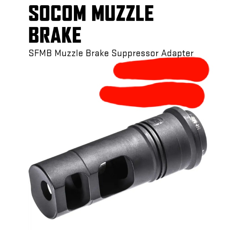

    So I'm building a .223AI now, and I have the barreled action. The barrel is a Sendero Lite and has 5/8-24 threading.
    My only .223 suppressor is a Surefire SOCOM, which because Surefire sucks balls, NONE of their muzzle devices that are threaded for 5/8-24 will work with the SOCOM suppressor, as apparently they're all caliber specific...or at least split into 223/308 sizes. (unless someone knows they will?) I called surefire and they said get an adapter lol
    I have a Rex Silentium MG7 (.358") in jail right now, and will be using it on my 357 lever guns and my 6.5cm.
    I wanted to be able to shoot both my 223AI and my 6.5 with suppressors on them, but the only way to do that would be to get an adapter from 5/8-1/2 like this Hughes Precision one....
    The other option is to just use the MG7 on it when I want... which I suppose I'm fine with.
    Has anyone used a 5/8-1/2 adapter? Any issues with them?
    Besides buying another suppressor(maybe down the road)...any other options or opinions?
    Can you have the threads turned down?
    Surefire chose to restrict the interchangeability of 7.62 and 5.56 cans so their military customers couldn’t confuse them and destroy them. I support them in that.
    I also think that 5/8 should have been the standard M16 thread as soon as they made the barrel heavier. Bigger threads are better.
    Reactions: Gustav7
    I was trying to avoid having it turned down for two reasons:
    1.) Eventually I’ll get another suppressor and I’m not sure what I’ll get or what muzzle I’ll want etc, so didn’t want to limit my options
    2.) Is prefer not to turn it down and possibly cause any issue with the steel creating a stress area and heating the barrel up causing fliers or shifting of groups, etc. Not sure if that’s reasonable, but after listening to the podcasts with Frank Green it came into my mind.
    I agree.
    What about having a muzzle brake opened up?
    Adding an adapter adds a lot more potential for misalignment.
    I definitley didn’t think about having a muzzle brake opened Up. Just have to make sure it’s a gunsmith or machinist that know what the hell they're doing.
    That honestly may be the best route
    Re-threading the muzzle would threaten accuracy a lot less than a lego set of adapter-connectors. If threading a muzzle causes accuracy issues you would just as likely would have those issues when it was first threaded...or chambered. For comparison sake, many brake adapters run about $125. A muzzle thread job is typically $125.
    If I can find someone to do it, I'd rather rethread the muzzle brake, but I see your line of thinking.

    Not sure why you just don't go with a 6mm socom brake???
    Welllll, two reasons:
    1.) I called them and they said they didn't have anything that would work
    2.) I assumed that was the standard muzzle brake, and while I see it says "suppressor adapter", I couldn't find a picture of the bottom. The bottom of the proper suppressor adapter needs to have a little cutout that matches the suppressor indentation inside the suppressor. I had a SOCOM brake that didn't have that indent, and the suppressor would fit on it, but it would shift under fire as it wasnt indexed on that indent...
    So idk... maybe I'll call them again and see if someone else is smarter than the first guy I talked to.
    I could be wrong.....butt I doubt it🤣

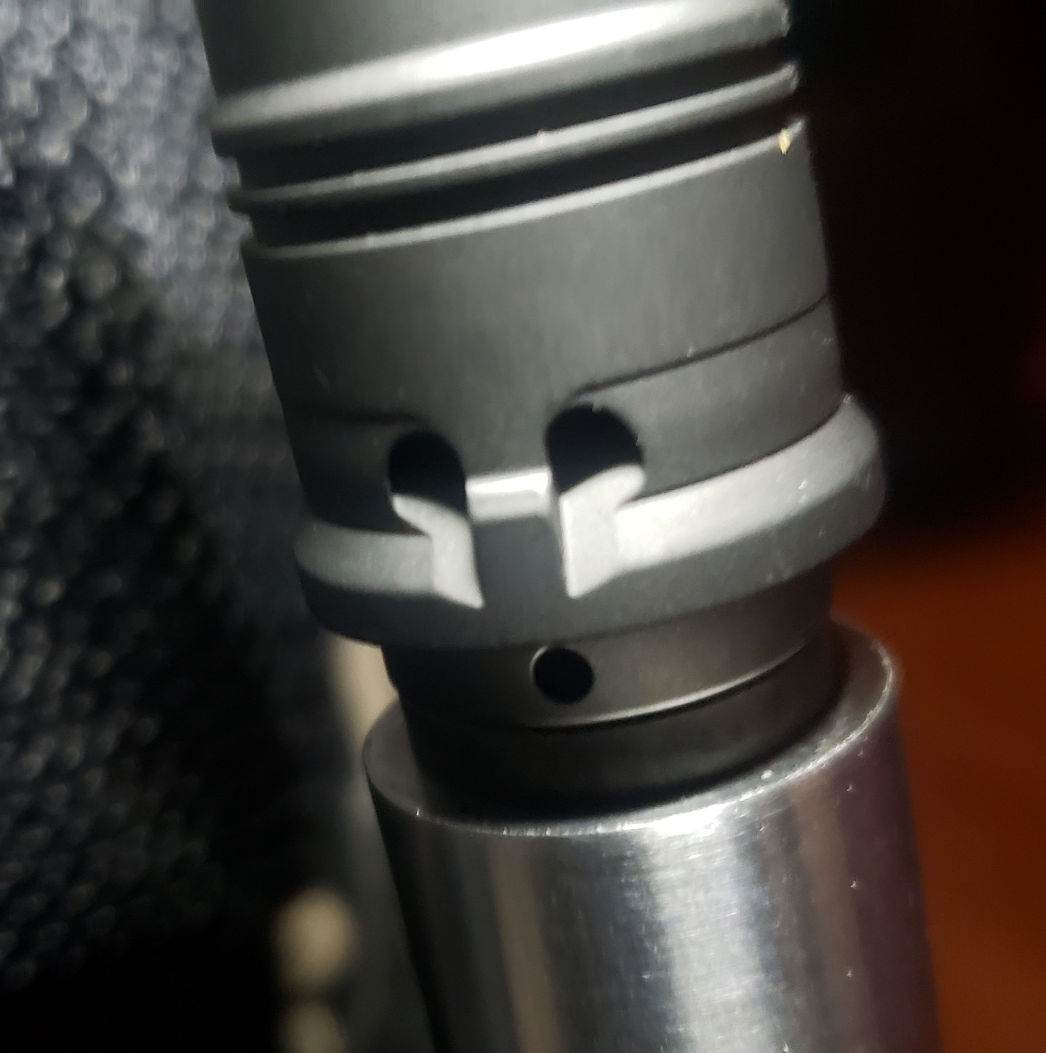

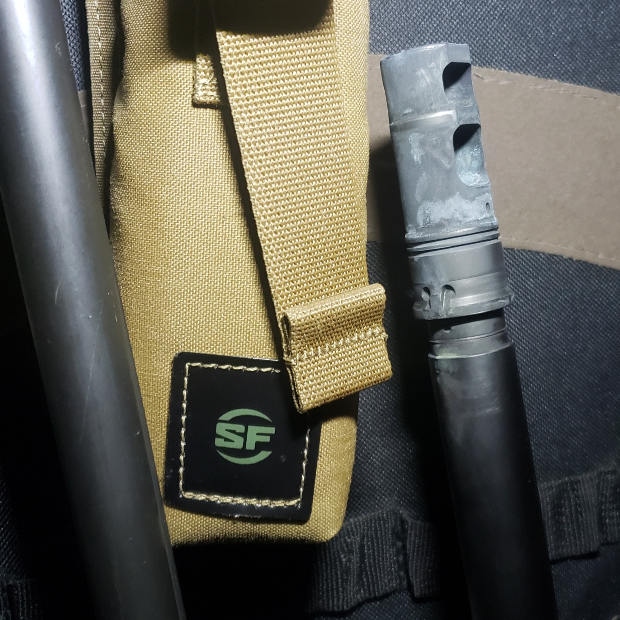

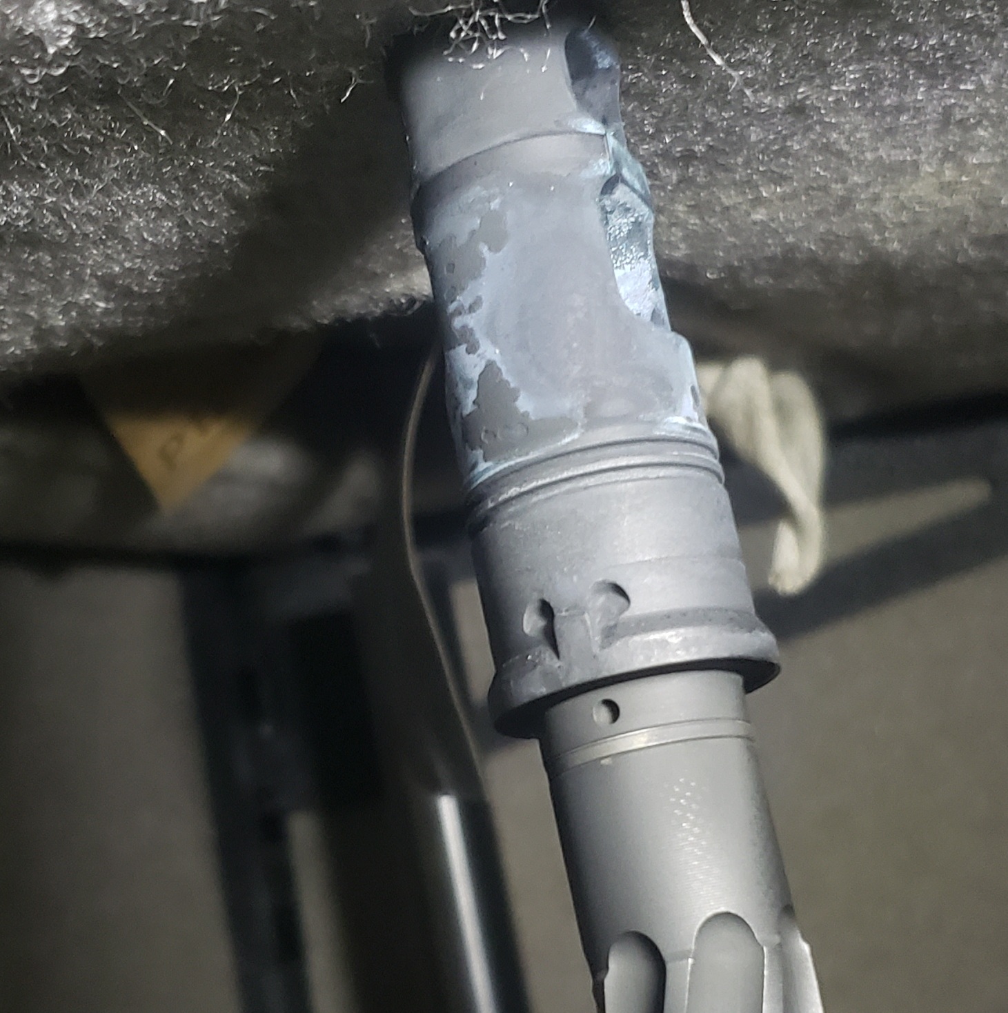

    okkkkk, well I feel stupid now lol, but I think I know where my confusion came. I have the muzzle brake you're showing, but I didn't buy it from a place, I got it from a guy. My old muzzle brake and adapter was not like that, it was the old ass one with the knurling on top and no indent. Somehow I got confused as to which one was on their site, and obviously Surefire was of no fucking help.
    The important part is that we all learned something, and thats priceless lol.
