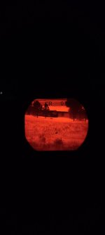

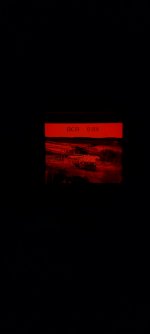

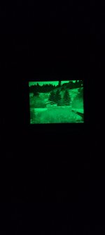

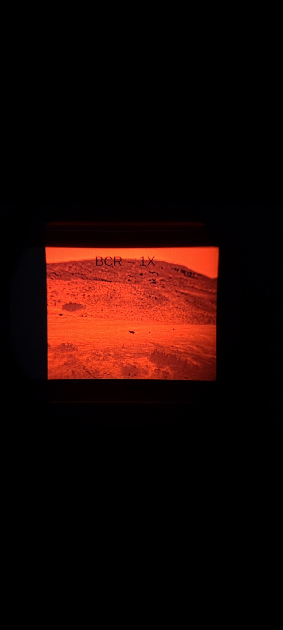

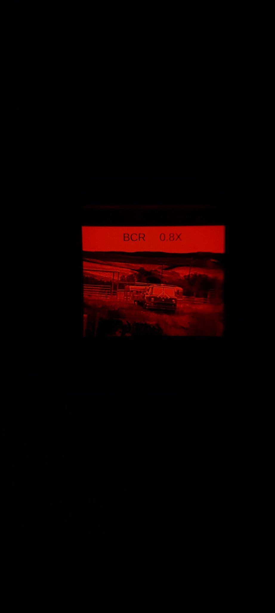

Took the Tig out night to test with a 3x magnifier. Out of all of the optic combos that I've tried the Tig infront of, I have go say that an EOTech/3x magnifier combo seems to offer the best image, FOV, and PID capability. Here's some images (the first house is roughly at 300 yards and the second image is up close within 60 yards, rabbit is about 70ish yards..didn't have many animals out tonight). Both are on the color Pallet (BCR and CR are the same, BCR has a little more contrast and sharpness.)

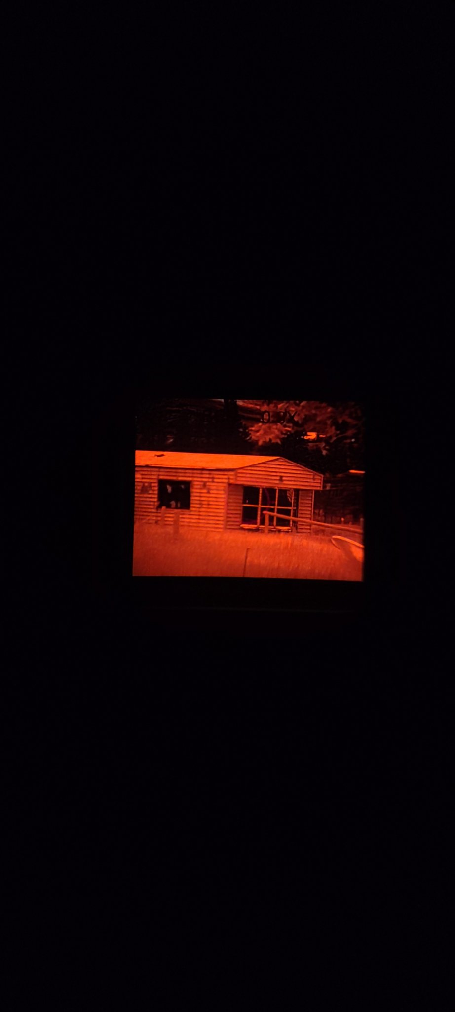

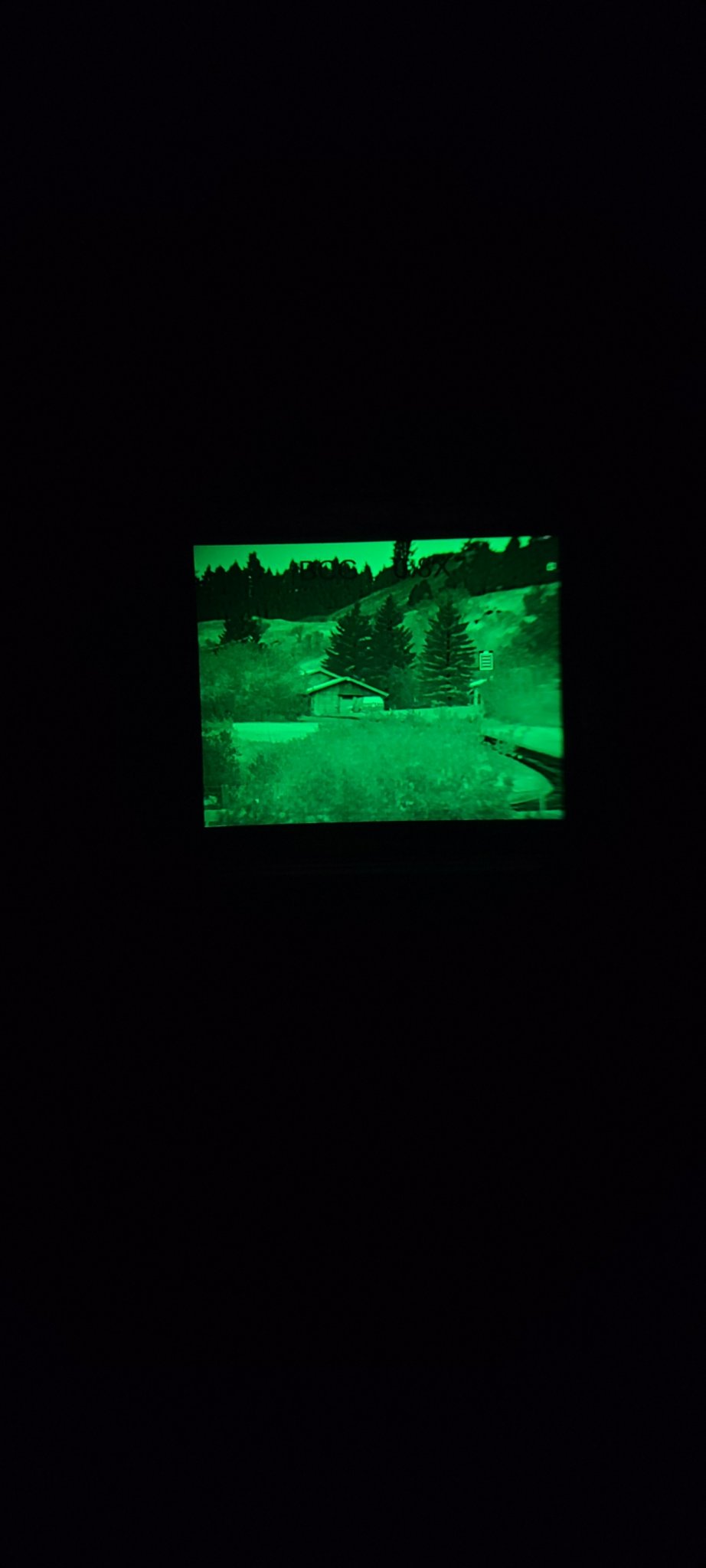

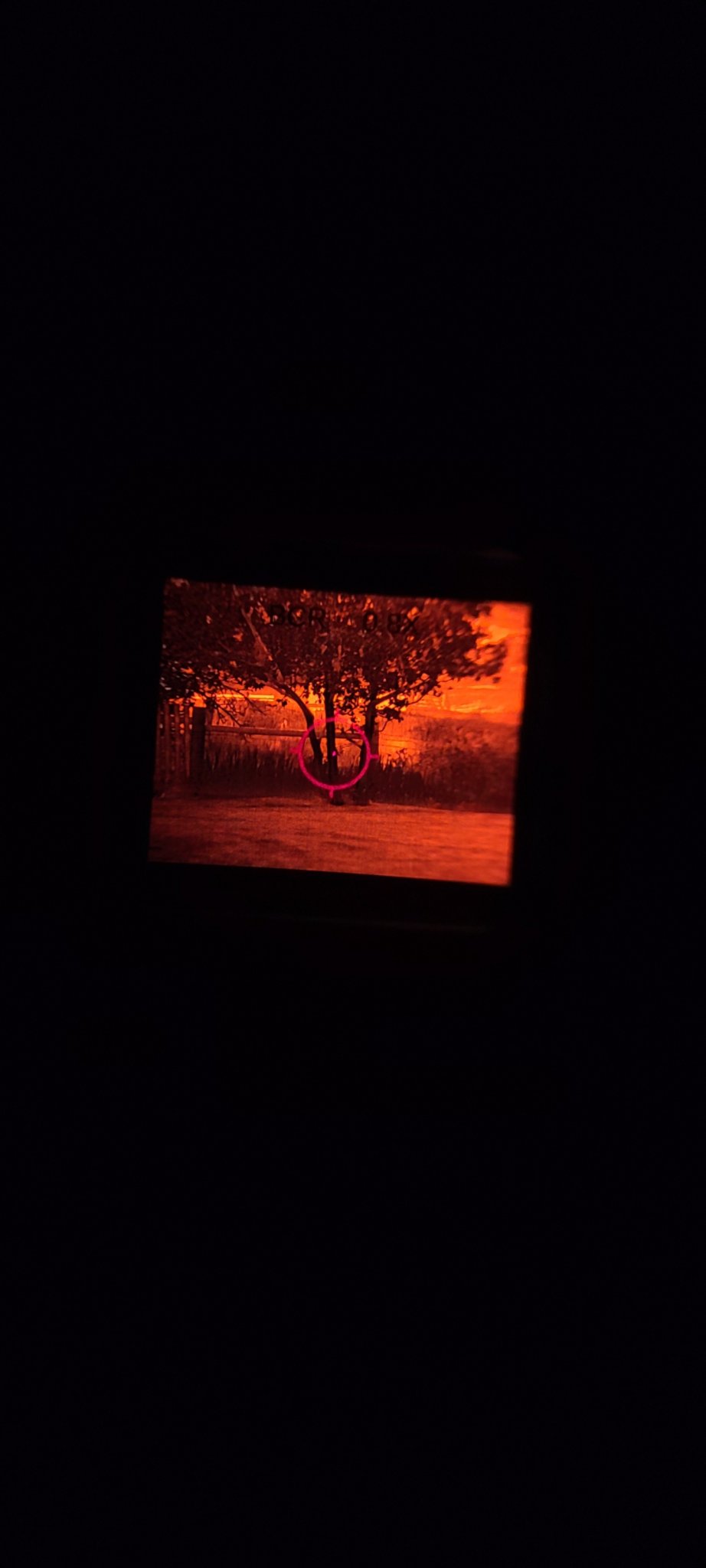

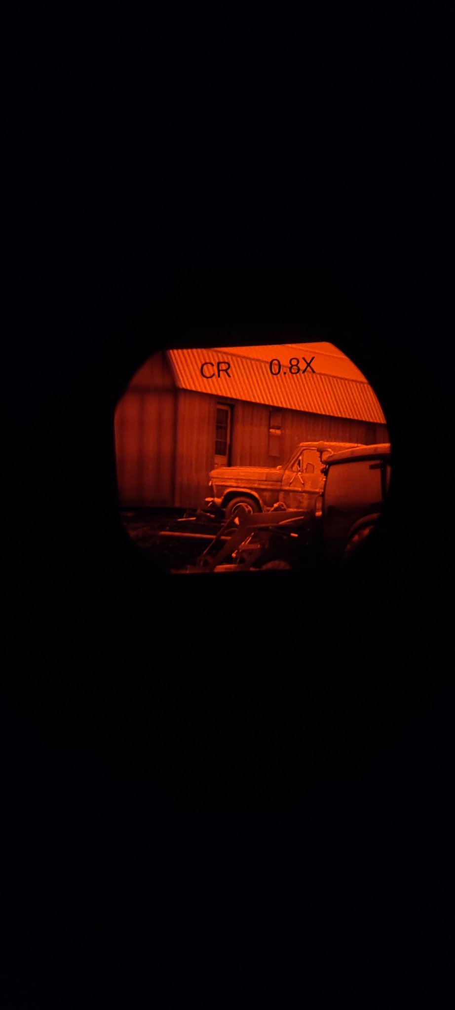

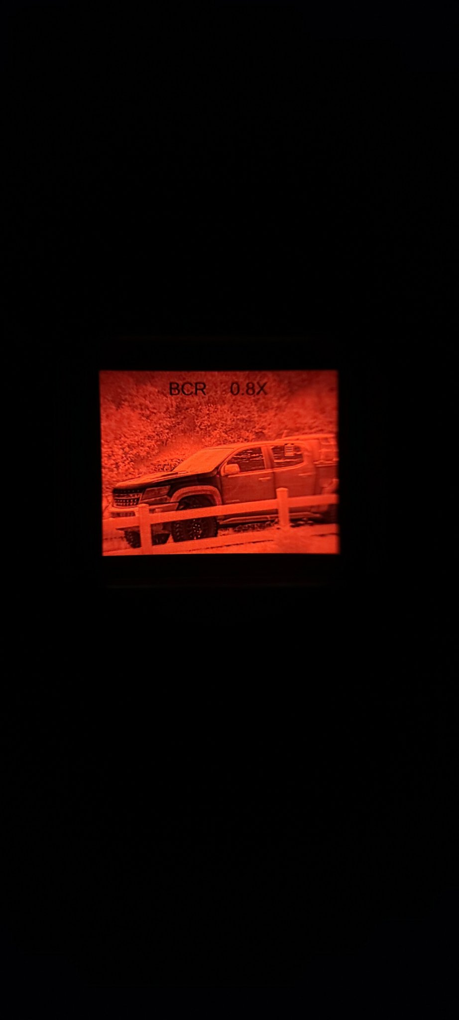

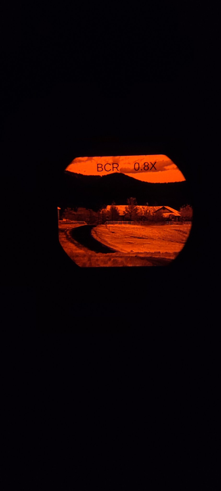

Got to spend some time behind the tig last last with an EOTech/3x G33 combo. The last couple of days have been PERFECT thermal conditions (warm, sunny, humidity less than 20%), and I got some great photos.
So far in my testing (mostly image testing, Wig does the shooting part 😃), I have found that the tig looks best (best clarity/PID distance) with a 3x magnifier...by far. Anyway, here's the goods. For reference, that deer picture was at around 700-800 yards.
