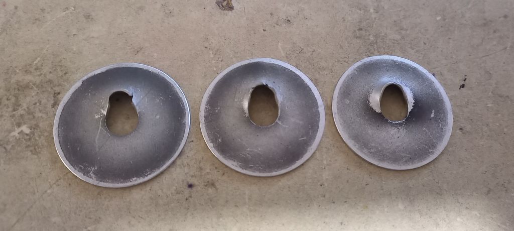

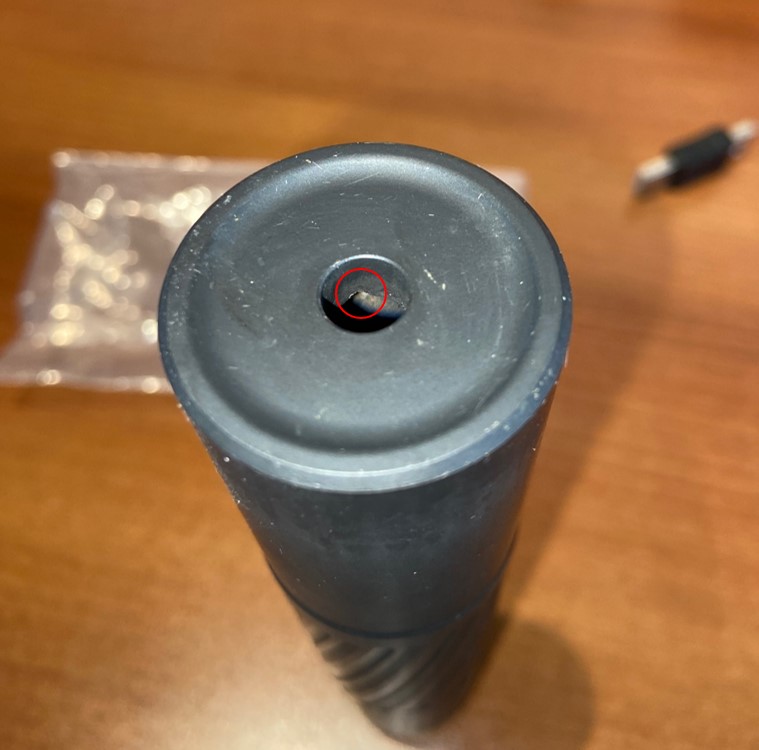

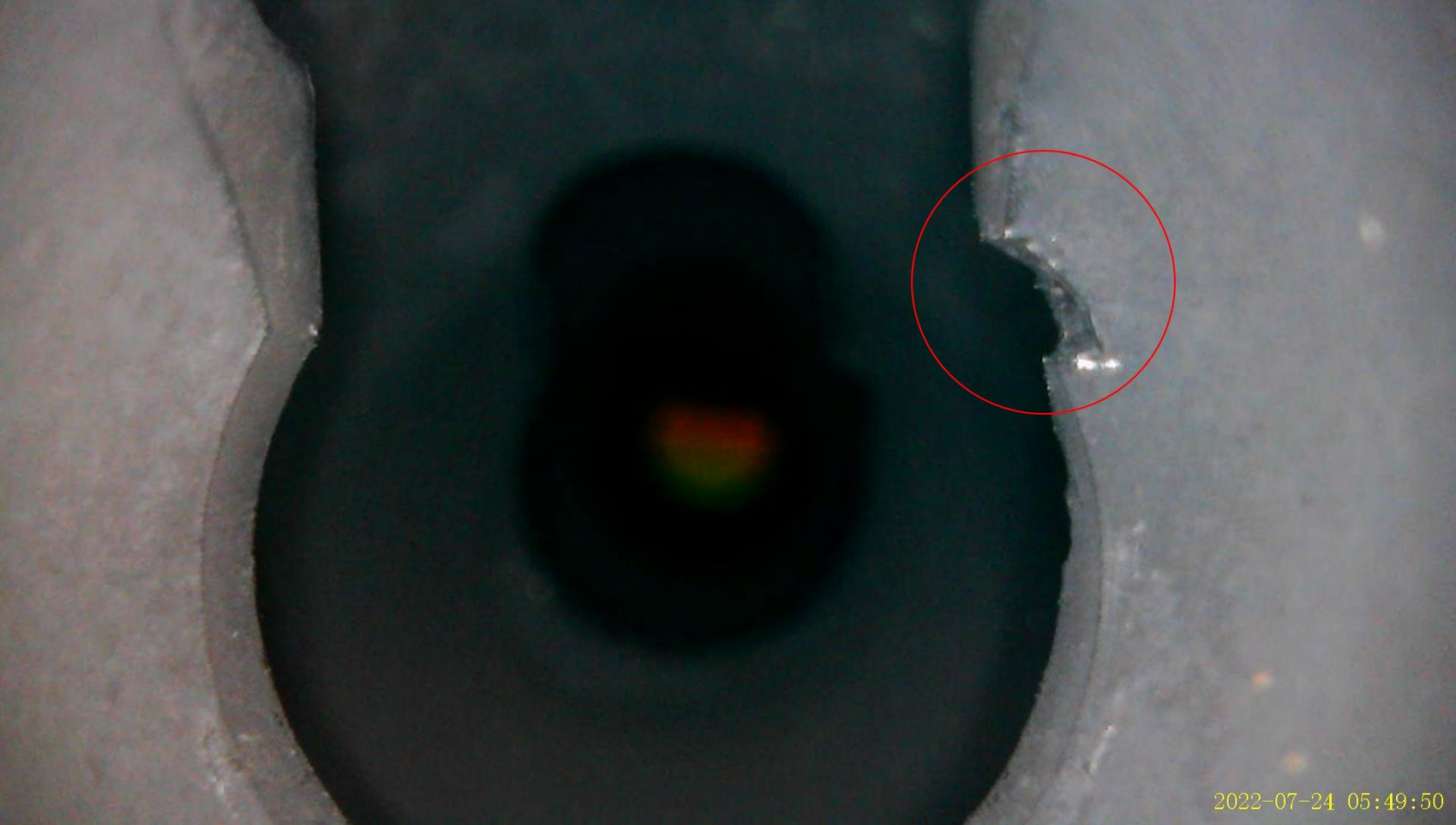

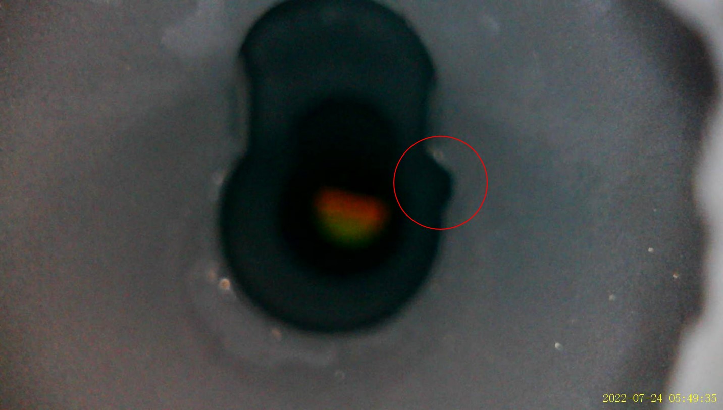

Examining it at the range, it looked like I was lucky and just grazed one baffle…so I looked down the bore, it looked all lined up still, there were no cracks or bulges in the tube at all, so I shot a few more rounds with no issues. But, when I got home I put a Teslong bore scope in there and yep…struck every baffle and a bit of the end cap. Very small chips taken out…but nonetheless. So, I took pics, reached out to TBAC on a Sunday evening with my figuring that they will see it the next morning when they come in. Well, TBAC has GREAT customer focus and @Zak Smith replied to me that night and in his opinion the suppressor is fine and will function perfectly….just don’t do it again (sigh..haha). In discussion with TBAC, if I did want it repaired, it would essentially be an almost all new suppressor just with the serial numbered tube retained (and maybe some other bits…but mostly a fork lift upgrade).
Below are five pictures of the baffles going from muzzle end to pic 5 being the end cap. And I hope this little story of woe was at least mildly interesting.

Did you have baffle strikes, if so…how bad or were you able to shoot it as is?

I'm lucking that the damage to my can, as shown in the pics above, was so minor as to not impact function/performance per TBAC and their recommendation is to just shoot it. I can always send in it some time but they will basically have to replace almost the entire can except for the tube and the CB mount. All the baffles and the end cap have that very small chip and it seems to shoot just as it did before.

Didn’t strike anything in there at all. Not even a little strike like I had?
No strike. Nothing, landed in the woods. Maybe a scuff. My buddy was laughing his ass off.
Not trying to pester you...just curious. Did you run a bore scope down it? I couldn't see the little chips (and they were small) out of the baffles until I used a scope.
I guess the gas blast was enough to launch it 75 yards.
Again, glad your can is ok...as for me, I intend to never do this again (famous last words haha)
No, i just a plain quick visual inspection. i think what saved mine was it was a 30cal with a 30 cal end cap on a 5.56 rifle
