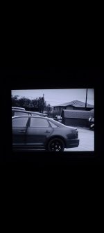

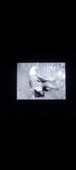

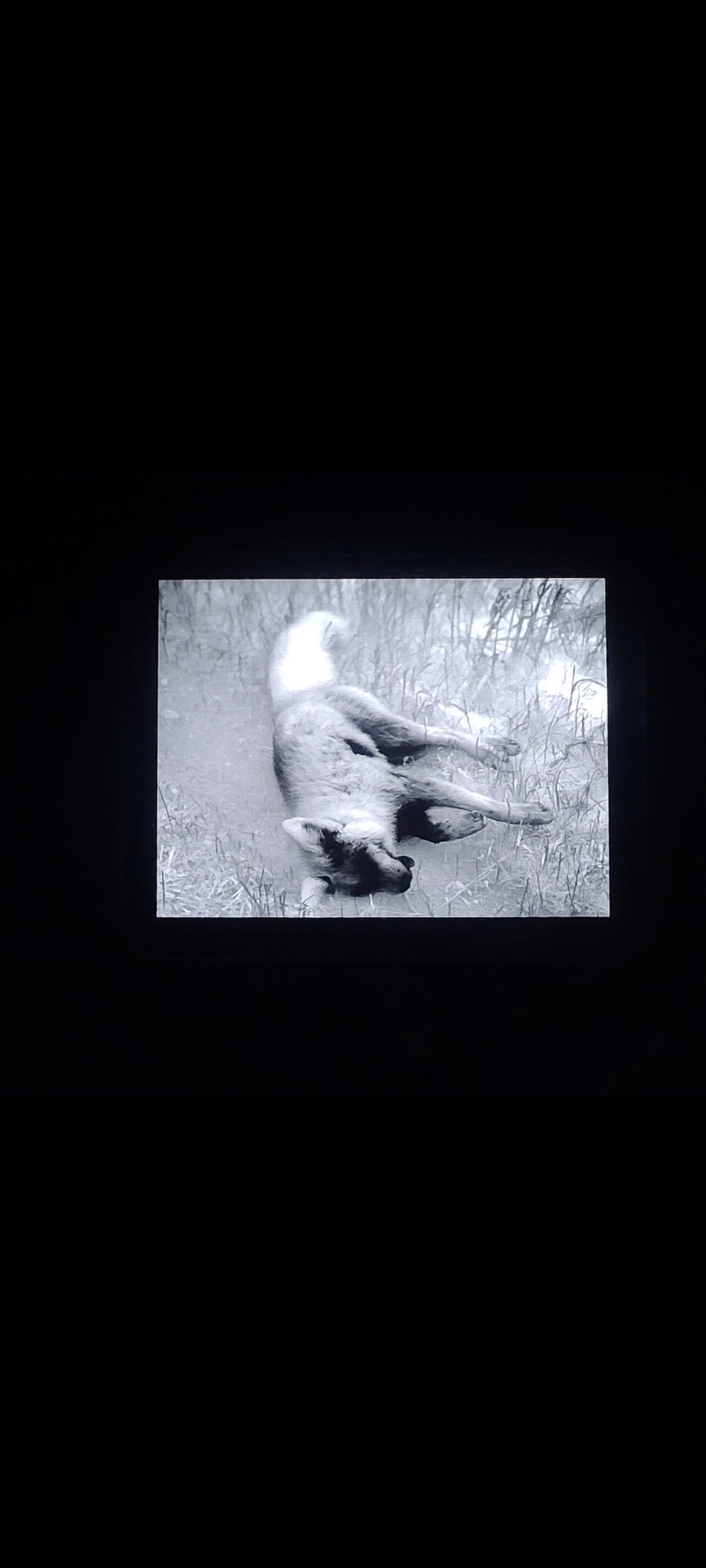

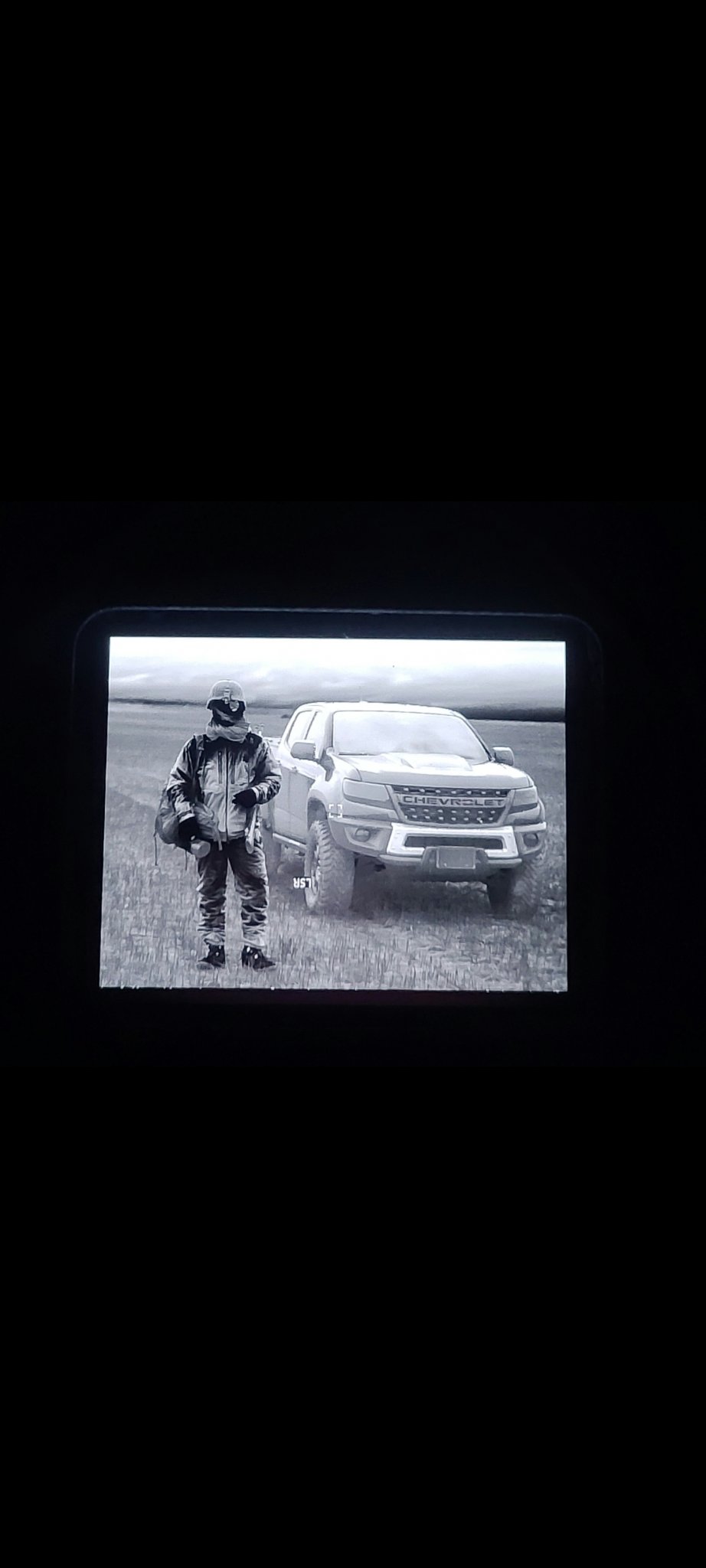

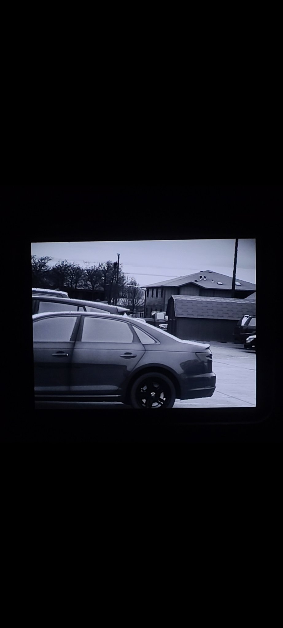

I was going to comment on this. I don't have a voodoo M but I do have a voodoo S, and it gives fantastic terrain detail, and with a lower gain setting it brings out detail in animals very well (here are examples of both). I found that the animals were more crisp and carried more detail with the voodoo M compared to both UTC's. The HISS 320, while more sensitive, gave the worst image out of the 4 options.

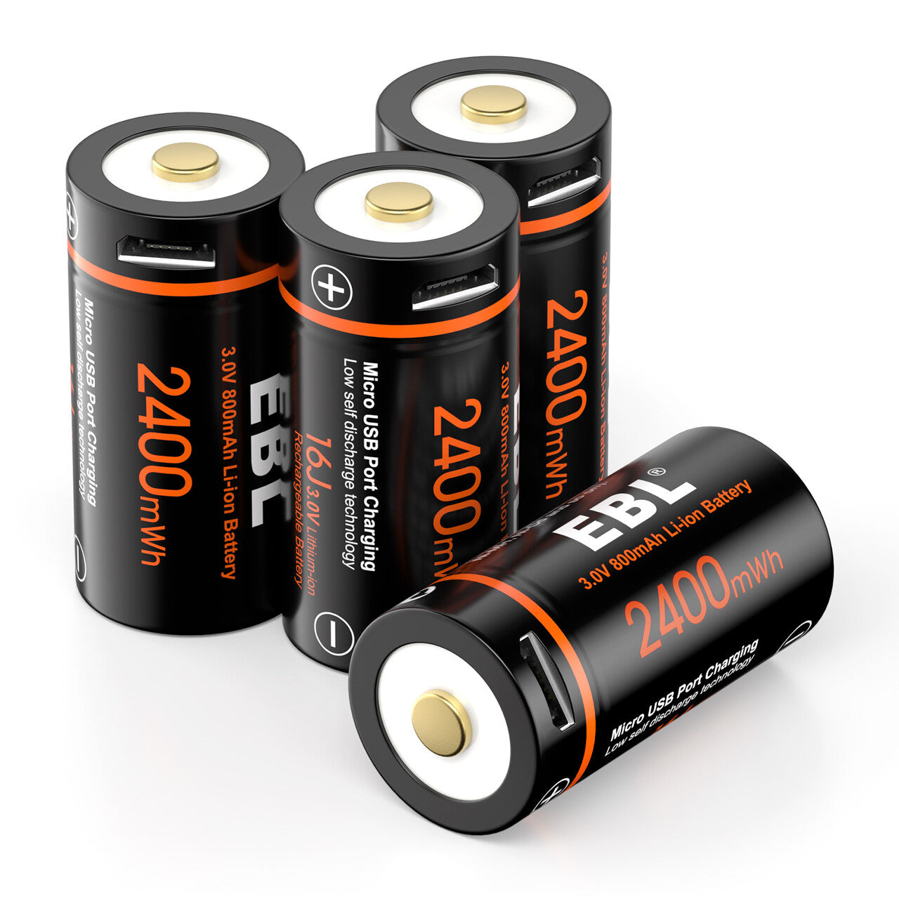

However, EBL does make a solid 3 Volt RCR 123 rechargeable that is solid as a rock. I run these in my sensitive devices that cannot take more than 3.6 Volts such as a COTI or Dbal A3. These batteries have the same voltage as primary CR 123 and are safe to use in anything rated for CR 123 primary batteries.
Any downside to running these 3V batteries across the board? I'd guess laser and light output would be reduced? How would the Voodoo M, S, NOX or other units play with these?
No downsides. Those batteries are good to go in anything requiring regular CR 123 3 Volt batteries.
Neither laser or light output is reduced. Only thing that might be reduced is the total run time on the devices as those are 800 mAh vs regular primaries are around 1,600 ish mAh but I have noticed that I get just about as much run time out of the rechargeables as I do the primaries.
The upside is that a lot of times you go out at night and use up 1/2 the juice in a primary CR 123 or thereabouts and you really don't know when it is going to run out but you continue to use it the next night so as not be wasteful with your batteries. Point being it could crap out on you at the worst possible time. With rechargeables you don't have to deal with that as you just recharge them up and start the night out with known fully charged batteries that likely will not crap out in one nights normal usage unless a horde of Zombies attacks your defensive position and you are forced to use the crapolla out of your laser dispatching them.
Reactions: rlsmith1
Nice, I was just going to start looking for some good 3.0V RCR123. Is their peak discharge current the same as a CR123? Might not be an issue in thermals, but could be on flashlights.
Well regular CR 123 usually are peak discharge continuous 1 amp. The EBL's are 0.7 amp.
A lot of the high power White Lights like the Surefire M600 DF require high drain batteries which are usually 18650.
I run the EBL's in mainly Dbal A3, Pas 29 Coti and have run in Flir Thermosight Pros. They perform perfectly in those three items. FYI the Flir Thermosight Pro's will also run the hotter RCR 123 rechargeables that have a nominal 3.7 V and come of the charger at 4.2 V with no problems at all.

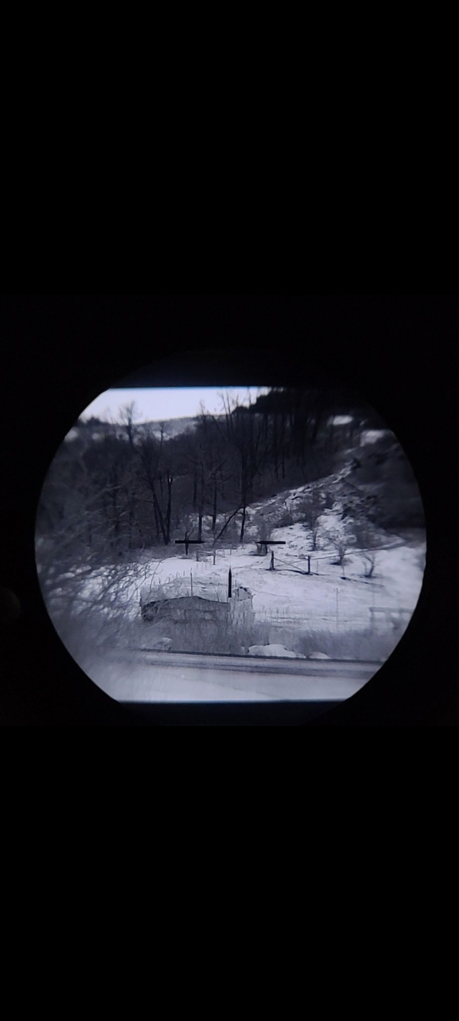

Update #1 - Over the summer my buddies and I got to a new level for long range shooting at night. Previously the furthest we have gotten hits was at 1,000 yards and that was using a PVS-27 clip on. Every time we tried to push it further we had trouble seeing our misses and it wasn't possible to correct. We even upgraded a couple PVS-27s and PVS-30 with new tubes from L3, Elbit, and Photonis. Although there was a significant improvement in performance, it really didn't result in longer range capability, at least not for our particular environment.
The next step was giving it a go with our thermal and heated steel at 1,214 yards. For this we had my VooDoo-M, a Trijicon UTC-Xii and a Flir HISS 320. We were able to see misses and hits with all 3x devices, and even though the HISS was only 320, the mid wave cooled thermal is still king when it comes to seeing trace and splash detail. The VooDoo-M and UTC Xii performed about the same where the splash was visible, but just barely. In this video the UTC Xii was being viewed through a spotting scope while the VooDoo-M was using the video out. The quality of the video out is not as good as what you see through the view finder, but as I mentioned in person they seemed very similar.
I also threw in a video of my PVS-27 which was re-tubed with a 2300 FOM Photonis tube. You can see the target, but you can't see the misses or hits.
Next stop is 1 mile, and we have some new acquisitions planned to help get us there...so stay tuned.
