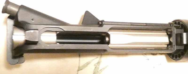

If you can access the bolt carrier from the bottom (by removing the lower receiver) use a short wood or brass dowel, about 3/8" in diameter and about 3 or 4 inches long and place on end located against an appropriate beefier part of BCG and drive it back with a small hammer.
