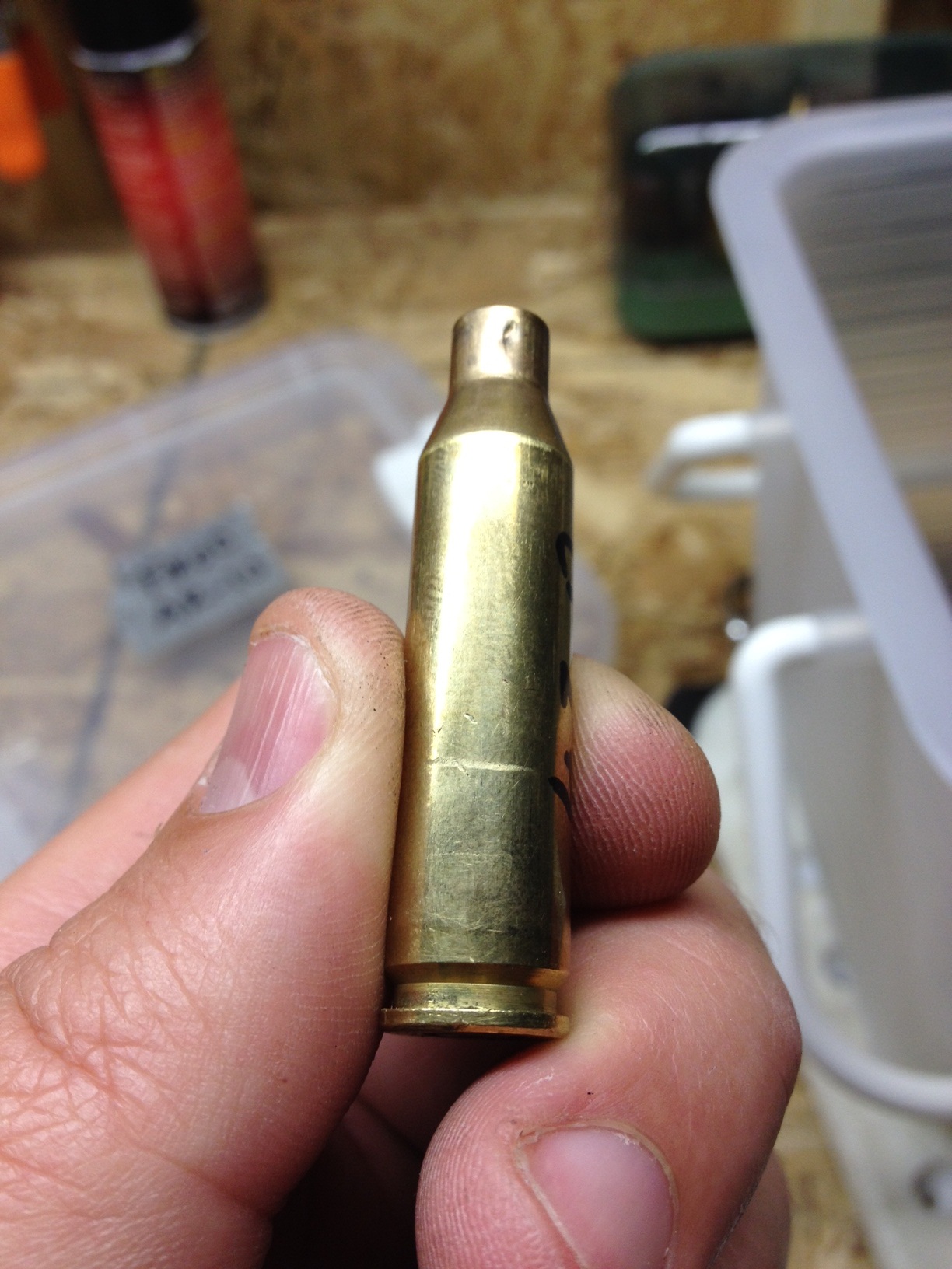

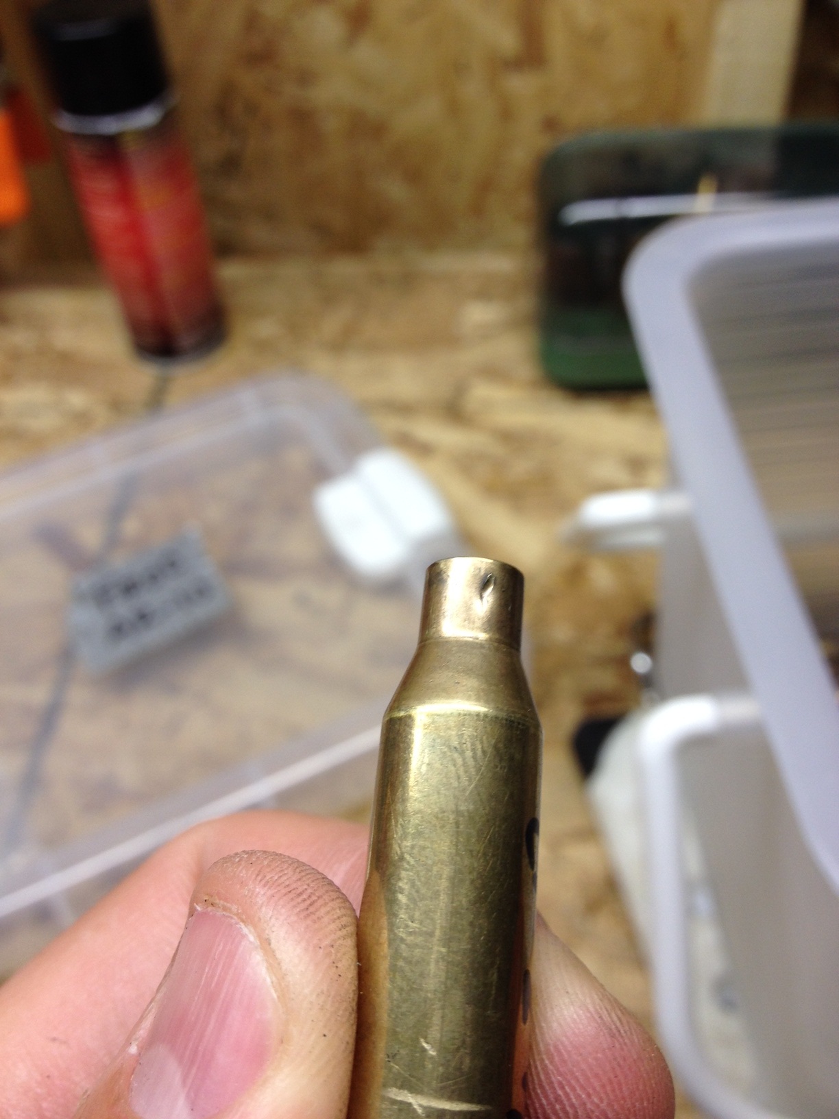

So glad i found this thread! I just took delivery of my new JP LRP 260. I loaded up some Lapua 123gr with 42gr H4350 (thought that was a nice mild load) and went shooting...
1) Got some interesting marks on the brass, including a horizontal stripe around the circumference of the brass - will post pics later. Brass also very dirty.
2) Got inconsistant ejection, sometimes brass getting caught at 90 deg in the ejection cut out.
From reading all the above, i think that 42gr H4350 is a little on the low side for a 123gr scenar, might try 42.5 or 43gr. Also think that i need to play with the gas block, maybe overgassed? I will report back with findings...
here are some pics to describe what i am seeing.... i get a ding in the case mouth and a scratch around the middle of the cartridge. I am going to reduce the gas and see what happens...
I am open to the collective wisdom of the hide here... this is my first foray into loading for a semi-auto. (have loaded plenty .260 for the bolt gun, am learning the semi auto is a whole 'nuther kettle of fish :) )

Just an update on my post above....
I dialed the gas way down and the problems went away. There are still some minor dings on the brass, but that is to be expected from a Semi-Auto. Feeding and ejection is now flawless. Seems they ship the guns with the gas port very much "open"...
