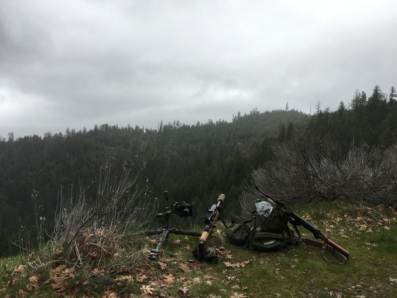

I just had my first outing at shooting distance. I was set-up at 630 yards with my 700 SPS Tactical .223. We were shooting in a changing 20-25 mph wind and as you can see the direction at 325 was a lot different than at my position which was a little lighter speed, guessing about 10-15. The target is 12" wide and 20" tall steel that i have circled in red and I had a chance to be at the target position, my nephew knocked the target over after 2 shots with his 300 WSM from 325, so we had to go pick it up. There was no wind at the target position.That was an eye opener to see what the wind was doing and actually pay attention to it. You can see at 325 there is a ridge that drops off to a branch and you can barely see there are tree tops at that point so it drops off pretty far then comes back up to the target. From 325 back to shooting position there is a small dip but not much, fairly flat other wise so definitely some terrain variation.
