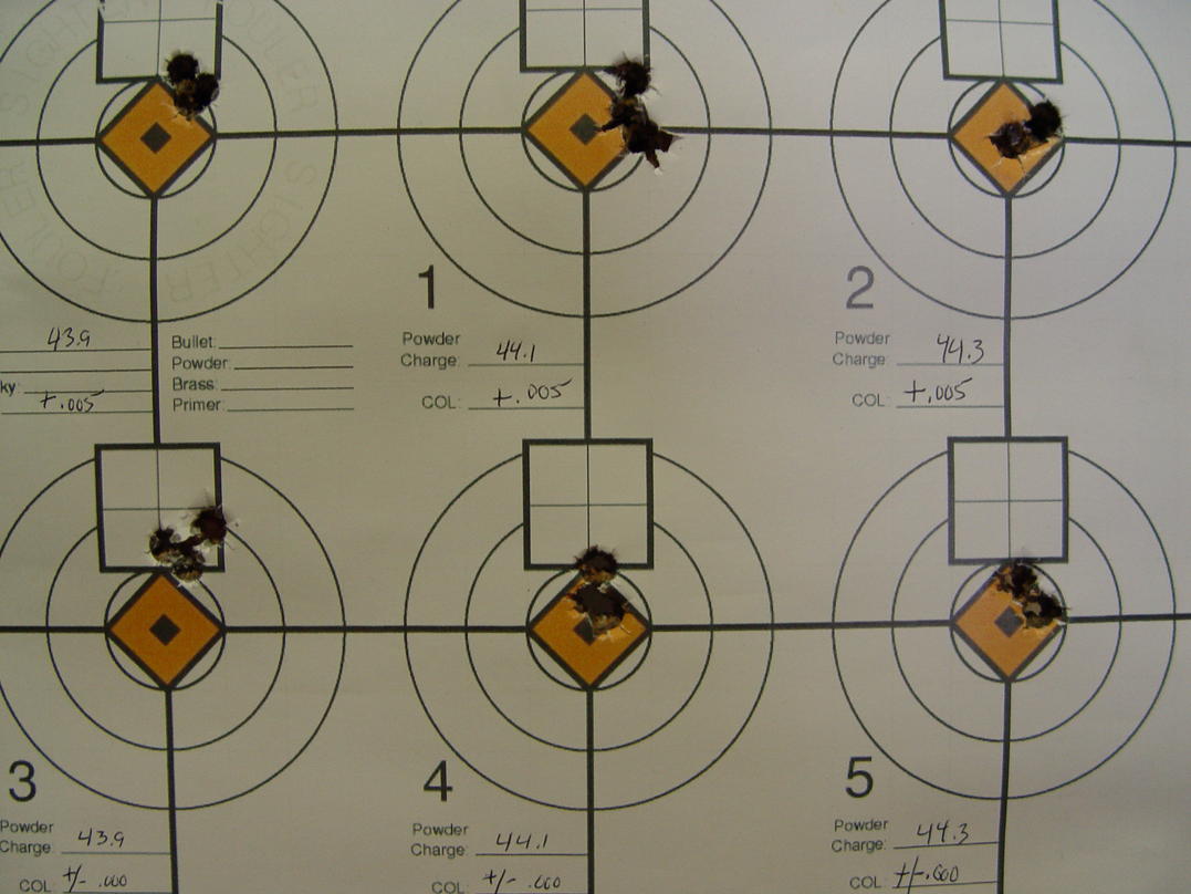

Here are my load development pics with 185 Bergers and charge weight of Varget and seating depth. 3 Powder charges-43.9, 44.1 and 44.3 & 4 seating depths-.005 jam, .000, .005 and .010 jump. My rifle specs are 22" Kreiger 1-10
gafferq2xl: Which 185 bergers are you using? There are a couple that are VLD and a couple that aren't. It seems the non-VLD actually PREFER to be jumped rather than jammed or .020 off the lands like the VLD's seem to like. I THINK I read that Berger designed them to be jumped for guns that had long throats(the majority of non custom guns).
Yes to jump but to how much I can't say. No experience over .010. As you can see though pretty much all of the powder charges and seating depths showed good results.
