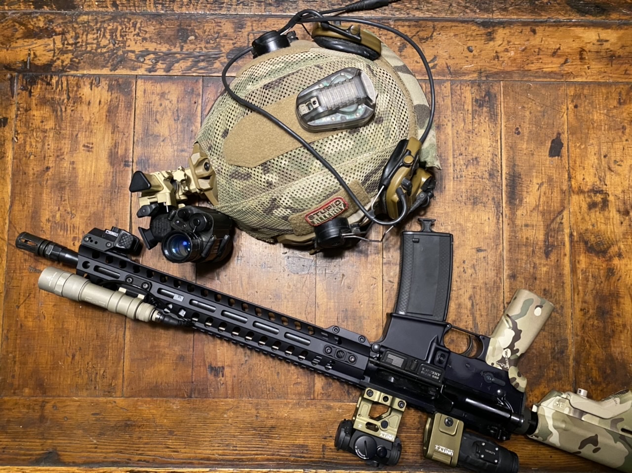

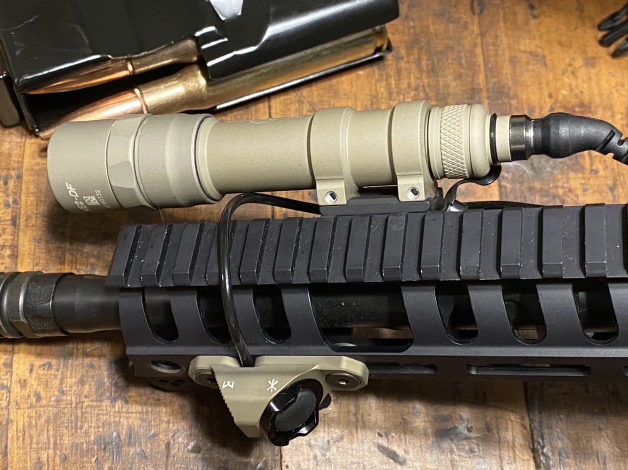

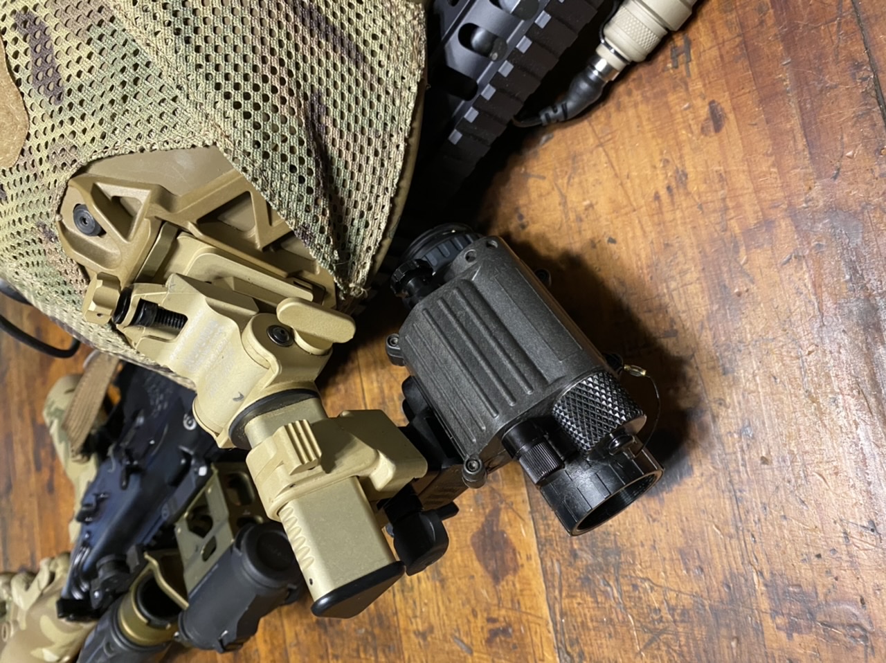

    I also just got into NODs (money pit, haha!). I am starting with a White Phosphorus PVS-14 on a Ops Core bump helmet (Wilcox mounts), helmet mounted IR strobe and light. Will be acquiring a MAWL C1+ soon for aiming.
    For shooting longer range, I recently purchased an OTSI PVS 27 to go from rifle to rifle. It will also see duty clipped onto a mount used in conjunction with my spotting scope. Total invested so far: ~$6800 (Not counting MAWL).
    Reactions: verdugo60

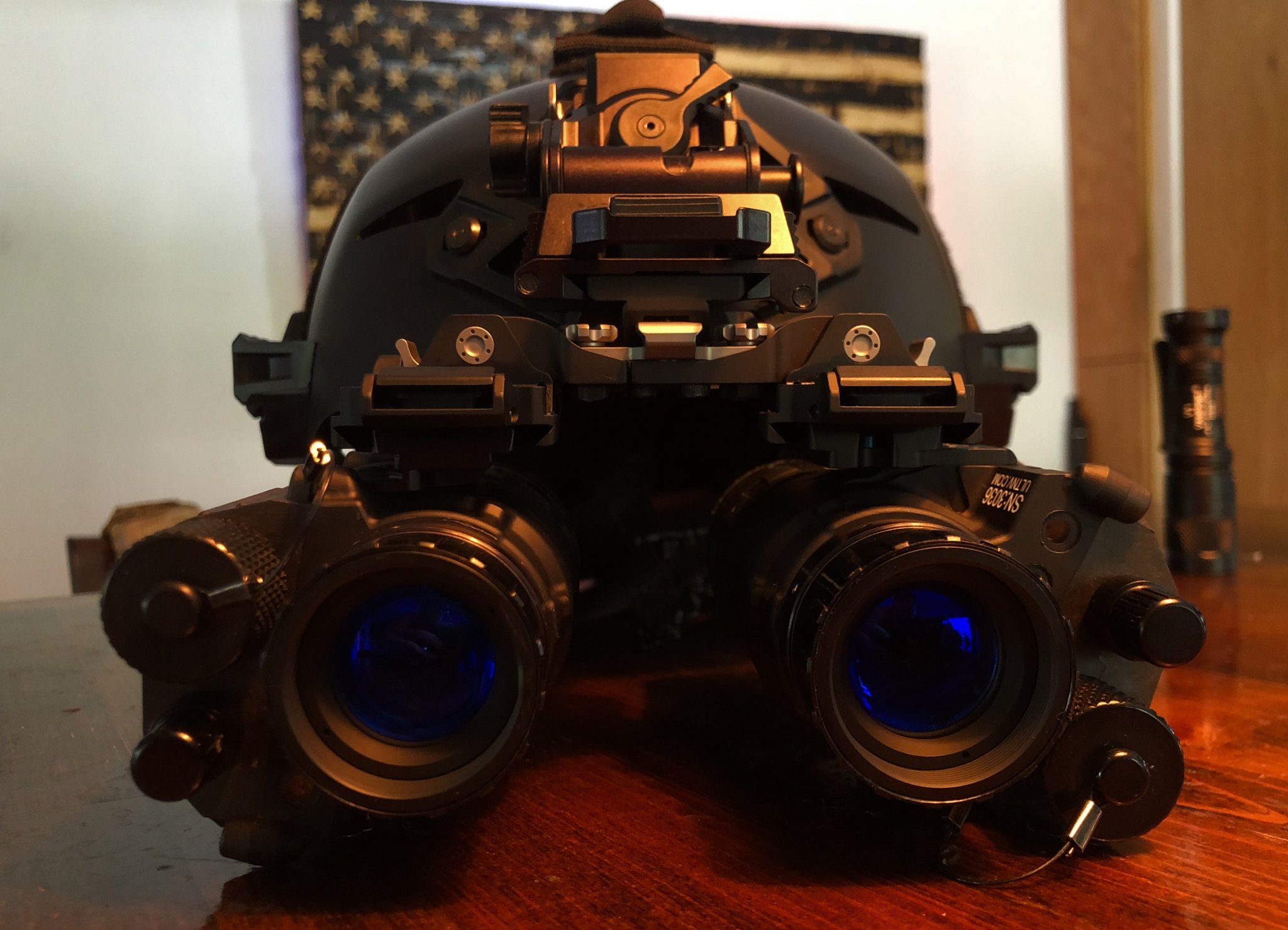

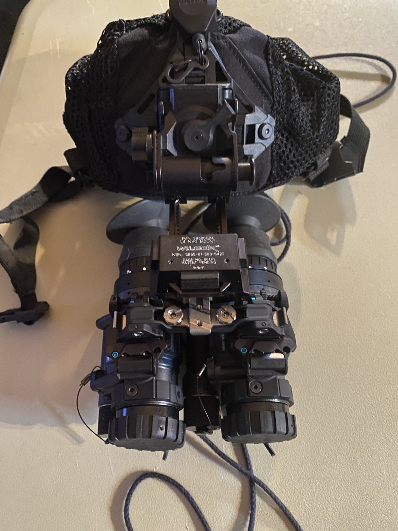

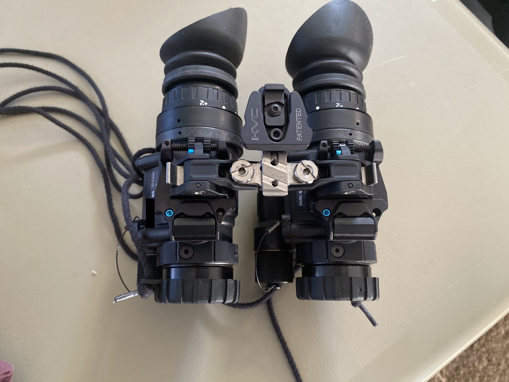

    I'll throw in my $0.02 so you can get an idea of my decision making process thus far, I just started putting together my first real NV setup this month with dual factory L3 PVS-14s (unfilmed WP, supreme tubes). I'm humble, but my setup won't be "complete" until I have (1) a solid thermal monocular like a Skeet or that new Nvision (2) a high-output Darth Vader-level IR light that makes me happy (Luna ELIR-3 will do it for now though).
    Now I would say that I could definitely work with a single PVS-14 on a helmet (I had a single gen2 for a while and made due), but I'm a redundancy freak so I needed a minimum of 2. Plus, my wife or kid will be able to use one when we hunt.
    That said, I'm in the market for the thermal that I can run along side my helmet mounted 14, and I feel that is mandatory equipment for a complete night time setup. I have a little Leupold LTO Tracker 2 HD that actually works pretty damned well (to a point), but it's not 640px @60hz, and it's not designed to be helmet mounted.
    Everything else that I bought was straightforward. Chose the KVC bridge so I could run the PVS-14s and thermal. G24 is awesome. My only mistake has been the Crye Nightcap. My head circumference is probably 1/2" too big and it's extremely uncomfortable lol

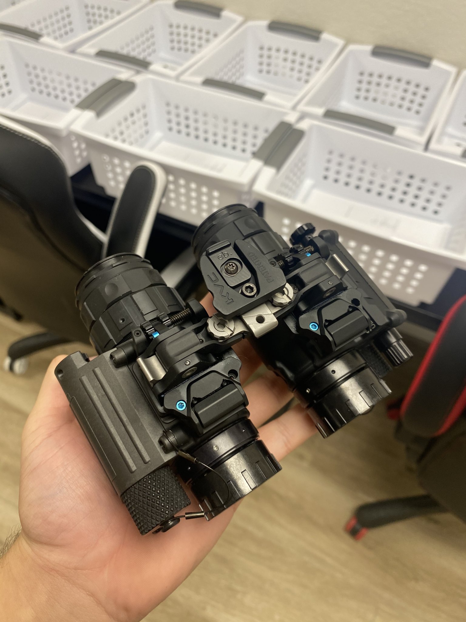

    My choice in a very similar boat:
    Device(s): PVS14 Vyper C, carson glass, L3 UF WP tube, MAWL C1
    Helmet: TW Exfil LTP
    Mounting: Norotos Hyper INVG + Dual Dovetail

    I was split between the Wilcox 63100G16 and the KVC bridge. The OSS shoes needed for mounting the 14s to the KVC are a separate SKU than the bridge itself, but it still came out slightly under the MSRP of the Wilcox. There's a different shoe needed to support a thermal
    In the end, I chose the KVC based on availability, but I don't think you can go wrong with either.

    View attachment 7410081View attachment 7410082
    That looks like you are running 2x right side OSS shoes (the ones that clamp to the infinite focus stop ring). Is there any reason for that? The OSS shoes should have come as a kit with one ring mount like that for your right eye and one mount that screws into the other side of the 14 and doesn't require a ring. Setup like that your battery compartment will be to your outside on both 14s.

    So, within your budget and “mission envelope” I’d recommend the following, or something largely similar — within the listed outline I posted above.
    After the pics, I’ll define why I recommend that route, especially when it comes to the Norotos INVG and accompanying Dual Dovetail Arm.
    Pics just for Verdugo (‘cuz yer momma always told ya you wuz “Special” 😋 )
    So, you might be able to immediately see why I recommend the INVG/DDT combination with single monoculars.
    Assuming you’re a good ol’ Righty and not one’a them devil-worshipping Lefties that uses his evil hand to do the Lord’s work, the PVS-14 would typically run over your Left Eye, keeping your Right Eye free and night-adapted or for use with White Light when you’re gettin’ your Night Thang on with the local misdemeanorin’ populace.

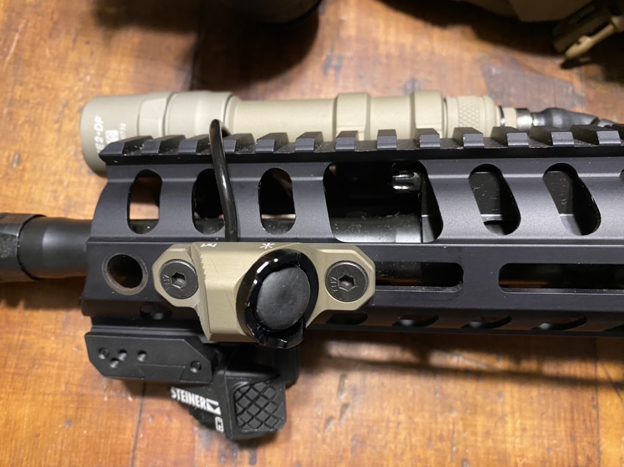

    On the front of the rifle you’ll see the SF WML, Unity Hot Button, and TOR IR Laser. The TOR button is very close to the Hot Button, but it’s actually very difficult to activate the TOR accidentally (and it’s invisible and eye-safe even if you did). Assuming you’d go with a SF M600V White/IR WML, this gives you a very light, simple, compact, functional full-spectrum solution for about $700 total.
    DO NOT CHEAP-OUT ON THIS PART!!!
    On the melon, pick your bump helmet of choice ($300-500), Deluxe 4D Pad System ($100), INVG Mount ($400), Dual Dovetail Arm ($100), Mohawk Counterweight ($100), Hel-Star Strobe ($300), and whatever Ear Pro you want ($60-500) along with mounting system ($80). All-in, you’re talking around $1,500.
    If you skimp on the headgear, it DRAMATICALLY affects your entire kit, hobbling its effectiveness. Pairing sucky headgear/padding/mounting with even the best NODs the world has ever seen is like cutting the two front legs off a Cheetah and wondering why he don’t run so fast no more.

    Now, onto why the INVG/DDT is the Absolute. Best. Ever. mounting combo for a night vision monocular in the history of the universe:
    First, it uses “Force-to-Overcome” (FTO) on multiple axiis instead of the locking button method. Some prefer FTO, some prefer the button. Personally, I’m equally at home with either. What separates the INVG from all others is that the “Horn” also rotates 360* in both directions and it stows a PVS against your helmet very quickly like no other mount — ever. Sometimes you just want to rotate the NOD quicky out of your way, but not fully stow it, and the INVG rocks at this. However, the biggest advantage is the ability to instantly switch eyes in 2 seconds flat! “Why would you want to do that?” you ask. Well, when you want or need to go from active IR laser aiming, which is generally a “blunt” aiming method for close-range shots, to finer, longer-range aiming using your optic, being able to instantly snap the PVS over to your right / shooting eye to view through your Aimpoint/EOTech is Da Nutz. NO other mounting solution offers that capability.
    Yeah, I had to mount it like that intentionally due to an interference issue with a mount that I setup on one of my rifles (Waiting for some parts to show up to resolve).

    This tailcap:
    Haha, yep that’s what I want Sir, does it have a name?

    Here ya be, matey:
    As far as running two separate lights, you only need it if you need to switch between white/visible and IR illumination instantly. If you have 3 seconds to spare to turn the Vampire head from one to the other, no need for dual lights. Saves space and weight and no risk of accidentally hitting one when you meant to hit the other.

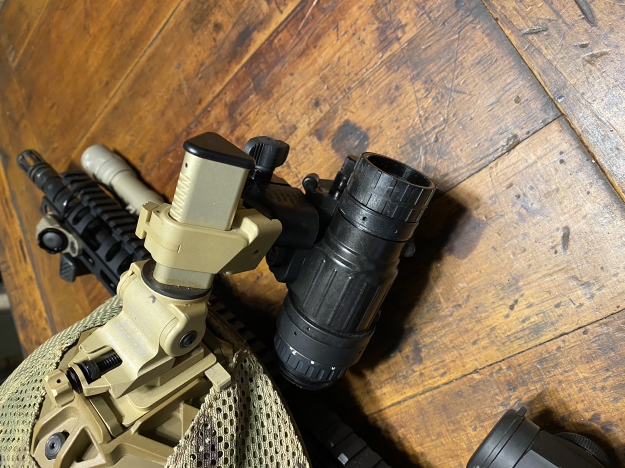

    Horta, this Mod Armory J arm is just as fast going right to left eye and does the instant eye switch in actually 1.639 seconds :) flat as well, so I beg to differ that no other mounting solution offers that capability.
    Slap it on a Rhino 2 with Dovetail and it is also folds back and lays right against your Crye Nightcap or helmet more compact than most anything out there.
    What say ye? Is the KAC bridge the best to connect two monoculars?
    The Mod Armory Light Weight Bridge is stronger, simpler, more durable and lower cost. Best mount out there for pairing two PVS 14's and also works well pairing a PVS 14 and a Breach Thermal. Mod says on its website it is not compatible with the Breach but I know how to flip the Breach arm around and make it compatible with the Light Weight Mount. I'm a good redneck engineer. :) You can also properly mount a COTI system when using this bridge. Other bridges, not so much.
    The KAC is overengineered, many wear points that will get sloppy with extended use, heavier and way more expensive. YMMV.

    The Mod Armory Light Weight Bridge is stronger, simpler, more durable and lower cost. Best mount out there for pairing two PVS 14's and also works well pairing a PVS 14 and a Breach Thermal. You can also properly mount a COTI system when using this bridge. Other bridges, not so much.
    I love the KAC/RQE, and it’s definitely the choice for dual Skeets, but I’ve had the MA Dual PVS-14 bridge for 5-6 years now, and it’s super simple and works perfectly for that application. Mine won’t lockup with any genuine Wilcox shoe, so I could never use it with anything else, sadly. It must be one of those “out of spec” early units. It was about $500. Back in the day. Not sure what they’re selling for now.
    All of mine lock up with Wilcox shoes and I have a total of about 9 Mod Armory Bridges. FYI, it is simple to change out the dovetail on the Mod Bridges. Undo the screw and it comes off. Call Nicole and get her to send you another shoe for it.
    You must have the Quick Detach Version. They run about $575. I have 2 of those and 7 of the Light Weight Versions. I prefer the Light Weight Version. That bridge is tiny and super strong with Zero wiggle which makes for a hell of a nice bridging of 2 PVS 14's or a 14 and Breach and they are only $350.

    I should specify, this is the two shoe recepticles on the bridge for the PVS arms. They won’t accept any Wilcox shoes. I tried to put Skeets, UTMs, etc in there and nothing locks-up.
    Ah, I understand now. Yeah I think the newer receptacles have an adjustment in them if I remember correctly. Never had to mess with mine. They are there for if you ever get any wobble in the system you can tighten it up IIRC. Both of my Quick Detach's are on loan out to some of my buds. I run just the light weights now. I am the loan shop around my buds. :)
