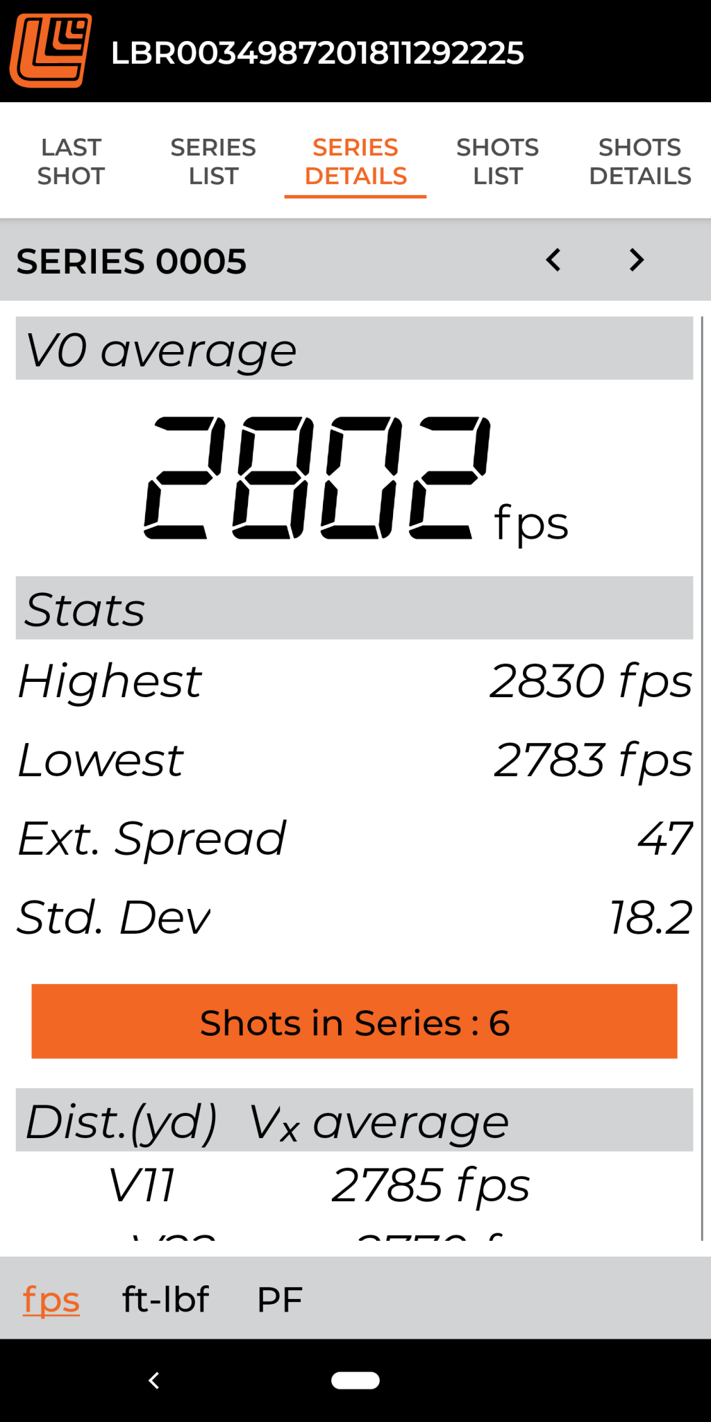

Magneto all the way, several of the shooters here have sold their Lab Radar's and use magneto's. If you watch the post exchange you can find some decent deals and might be able to pick one up at a used price.

This was his "one hole at 100 yards" but couldn't hit steel at 1000 ammo. Screenshot_20190225-131540.png
