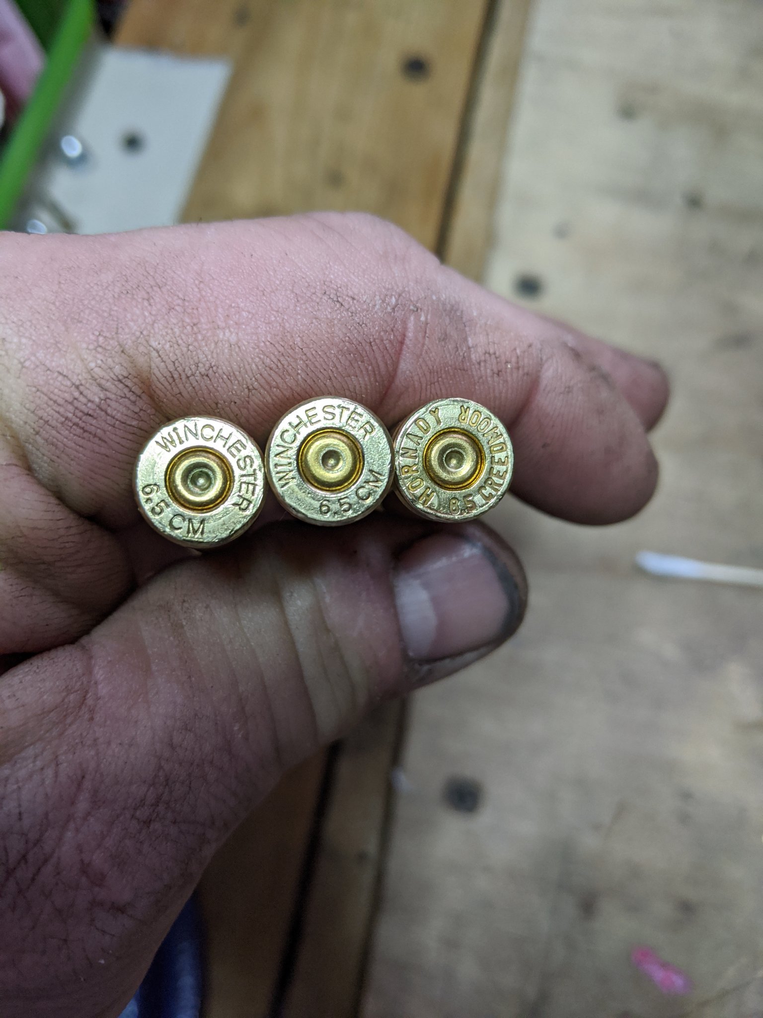

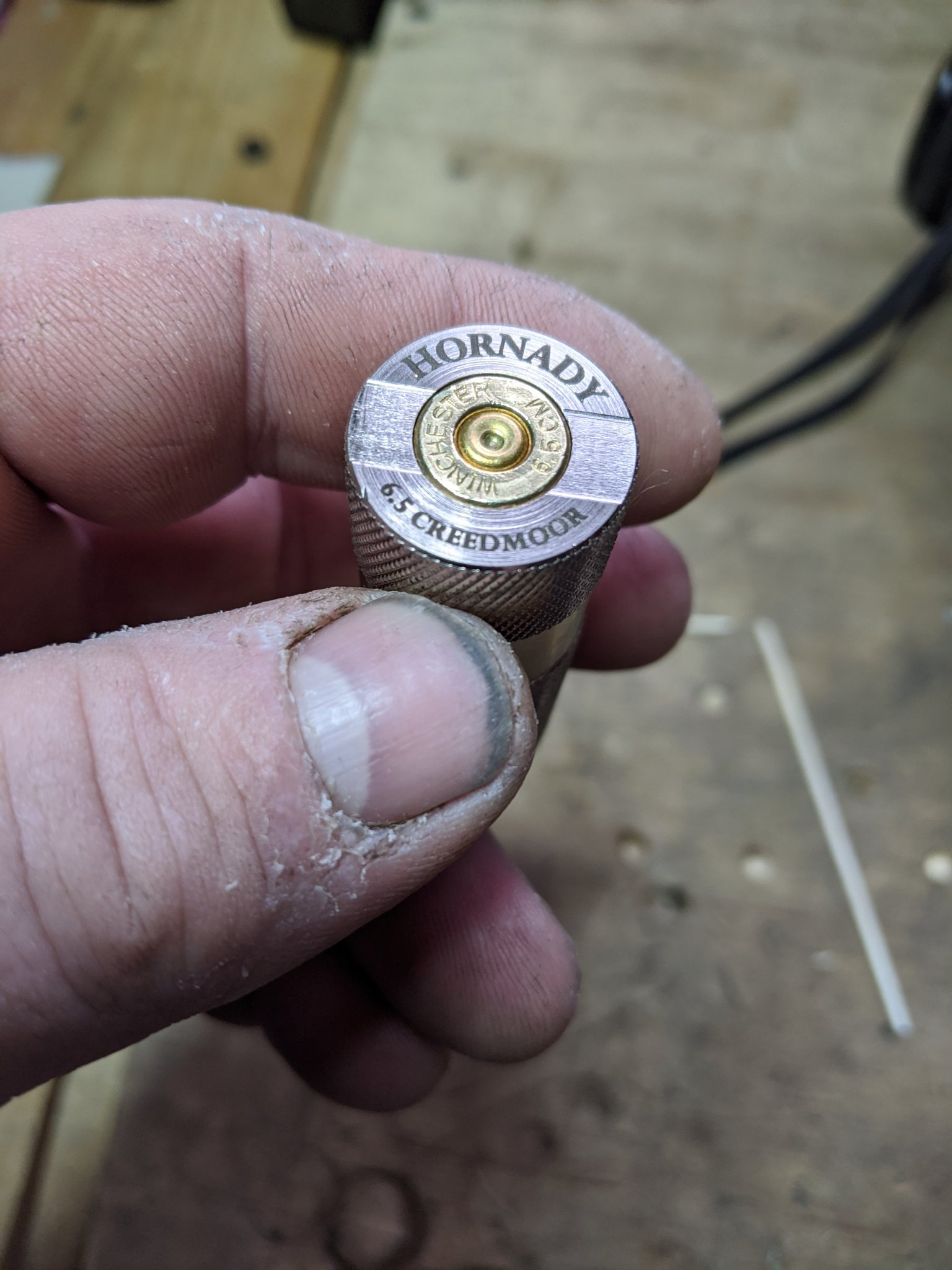

Ok so my 6,5 CM shoots GREAT ,, However ,,,,,,, ( and stay with me here) When I load Factory ammo it chambers and fires from the Mag just fine. I use my hand loads and it will chamber the first round but no bang , just a click. So I checked the cases,,, made SURE they were resized all the way down to the base, Check. made sure the COAL was right ,check. loaded 10 in the mag. sent te bolt home pulled the trigger and " CLICK". Now when I manually load the FIRST round by hand, and send the bolt home BANG! every time. I can hand load the first round and close the bolt and THEN slap the mag in and every one will run without a hitch . So I thought maybe the bolt wasn't being pulled BACK quite far enough to overcome spring tension , friction and the feed ramps. so i loaded some empty rounds,,, seated the bullets, primed the case ( no powder in the case) and loaded the mag to see if the primer would go . and again NOTHING ,, but the primers WAS struck and didn't even detonate . just a click. No clue whats going on here but it's driving me nutts. Hand load the first one the put the mag in and no prb. ,, load a mag put it in and click. Any thoughts?

my buddy had and issue similar, although yours does have some quirks.
Have you measured the shoulder of a fired cased vs one of your resized cases? His issue was he was bumping the shoulder too much and wasnt getting reliable ignition. Itd have a dent but not deep enough to ignite and it would happen once or during a string of issues.
.002 is around where you want to be on bump compared to a fired case.

You really need a way to measure how far you are pushing back the shoulder.
I full length size every fireing bumping the shoulder back .001-.002.
Google head space comparator or shoulder bump gauge. Hornady makes one. I think mine is a Sinclair branded one. They clamp on the jaw of a caliper.
If your shoulder bump is ok it is either your primers or something wrong with your rifle.

primers seated to below the case head?
nope,, primers are fine guys ,, I know it's not the primers
check shoulder bump
Check primer seating depth
I can just about promise one of those or both will fix your problem.

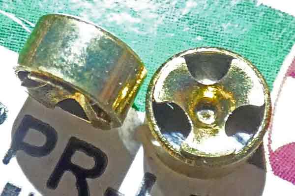

Correct. You don't seat primers flush you sink them to the bottom of the primer pocket (refer to my earlier post); they should be at the very minimum .002 below flush but more likely .004-.008 below flush. What I believe you are seeing is a pocket of air between the primer and the bottom of the primer pocket. It is acting as a cushion when the firing pin strikes the primer and then causing the primer to fully seat. This is also why you will sometimes see a "click" turn into a "bang" on a second firing because now the primer is properly seated. You should know the depth of the primer pocket, the dimension of the primer and how below flush it should be seated (you need to accurately measure all this) so that it is bottoming out in the pocket. I do not personally believe this is a shoulder issue.
I'm sure someone read about primer crush (seating until the anvil is crushed flush with the cup) and thought
"if a little crush is good, then more is better" :)
If the cup does not bottom out in the pocket it may or may not ignite.
You can measure if you want, or just seat till they bottom.
Everybody knows that but get all caught up on the word CRUSH.
I bet the anvil moves, just a little bit with the punch and hammer :)
Everybody knows to seat flush or below.
Dial in some depth with a super duper primer seater.
What IF that isn't enough to bottom the cup?
Like you, I bottom by feel.
Now someone come up with a meme
Feel the cup :)
