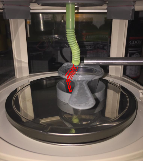

The big thing is to bend your straw in an s shape so that it slows down and to position the powder pan so it dumps into the side wall instead of straight down into the bottom, when it hits the wall it slides down smoothly, when it hits the bottom it bounces up and out. It will come with a small 3d printed base for the pan to sit in with some double sided tape underneath to hold it in place. Play around with its location and then once you have a good spot that doesnt bounce powder then tape it in place there, makes putting the plastic cup much easier/faster.
The double bend slows it down and then it comes out hitting the side of the cup to nicely pool in the bottom. I really should go back to it.

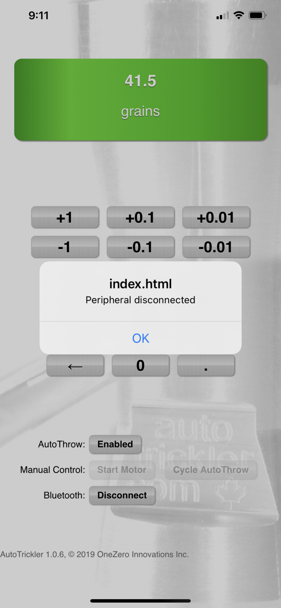

I just got my V3 and it is stuck on the the first powder charge I set it to. I’ve leveled and re-checked all the settings and they’re correct.
two issues: 1-it will automatically shut off giving me an error (after one or two powder throws) of “4.315” on the unit and I get the following error on my app “peripheral disconnected”.
2- the unit is stuck on 34.5 grains no matter if I set it lower or higher... if I set it to 50 it will throw 35 ish grains and then trickle all the way to 50... if I try 20 grains it will still dump the 35ish grains. I’ve emailed the guy for setup but am not aware of any other way to get help. Any thoughts?
the unit is brand new and I’ve looked through several things online and didn’t see any help for this. The unit has been leveled though I’m not sure that would cause these issues.

Ummm...are you changing the size of the initial dump (threaded insert in the powder measure arm)? The electronic interface really just controls the delta between the power measure dump, and the final charge (via the trickler).
FYI: The powder measure should be set a full 2-3 gr's less than the desired final charge weight.
The power cord for the unit. They shipped the original which I guess has a glitch but they put another cord in the box with stickers to put on the other plug. I emailed the owner and he got right back to me... I must have missed it but I’ll just throw the other plug away.
