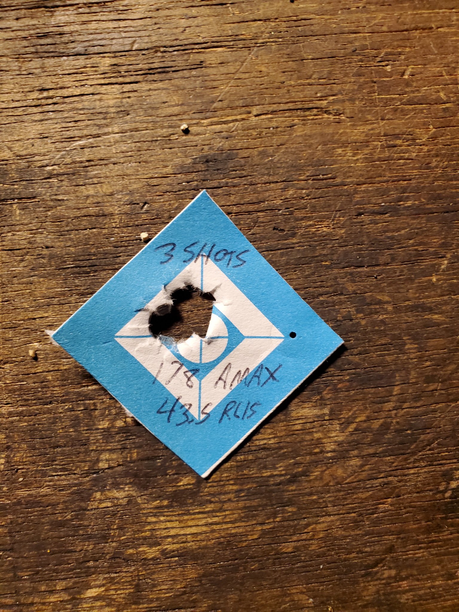

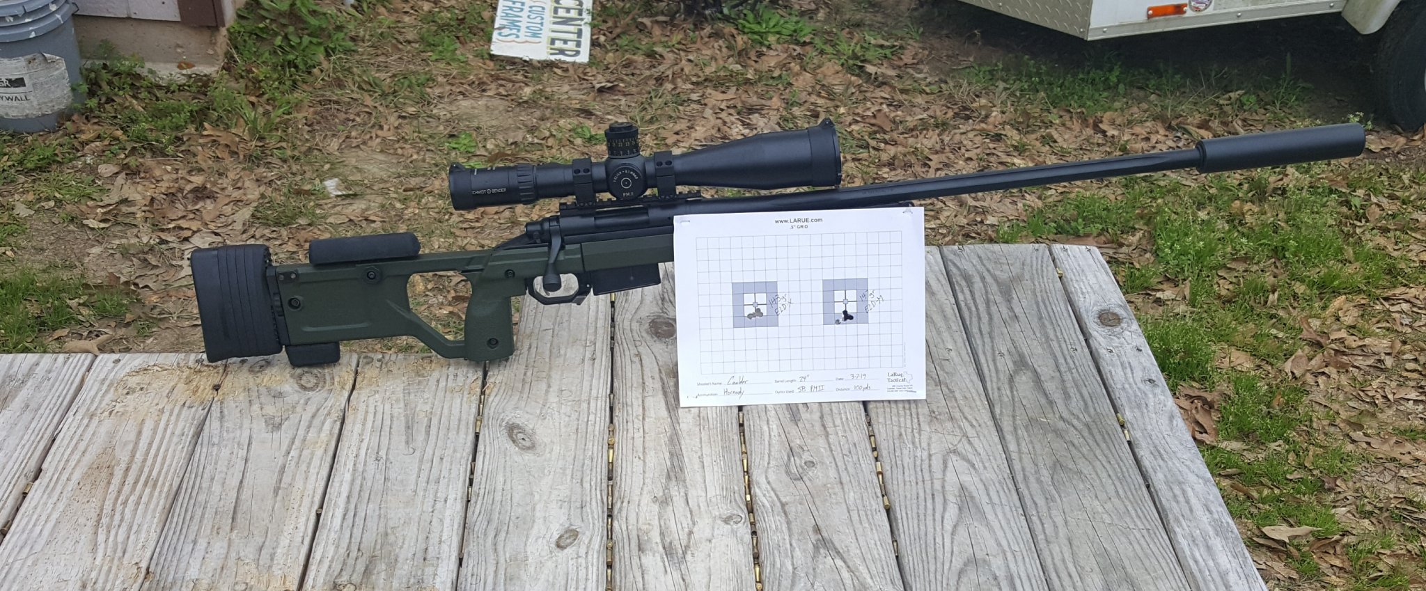

I own three Remington 700 rifles and they're all very accurate. One is an SPS 308 in a Grayboe, one is a CDL 30-06, and the other started as an SPS 308 that I put a trigger on, changed caliber to 6.5 Creedmoor, and put into a Grayboe stock. No blueprinting performed. All LH rifles, all will easily shoot sub 3/4 MOA.
Frank's Snipershide rifle is a factory 700 in an APO chassis with an added layer of QC and they are hammers.

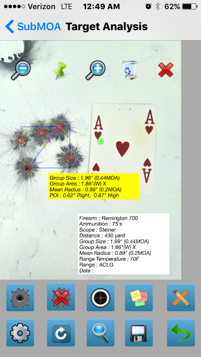

Agree, I have owned 3 AAC-SD's in the B/S factory stocks in 308 an not a one shot over 1/2moa with factory an with hand loads they all were in the .3-.4 range or better at times. I've a 16.5" .223 AAC-SD that with 25 grs of H335 an a 55gr Amax an 10X scope will do 1/4 moa at 400yds with most anyone behind it, who can shoot.
What I find interesting as my experience with some of the other sticks touted have been way different than the internet reviews state, but then again the target has no way to twist words or tell/spread an untruth.

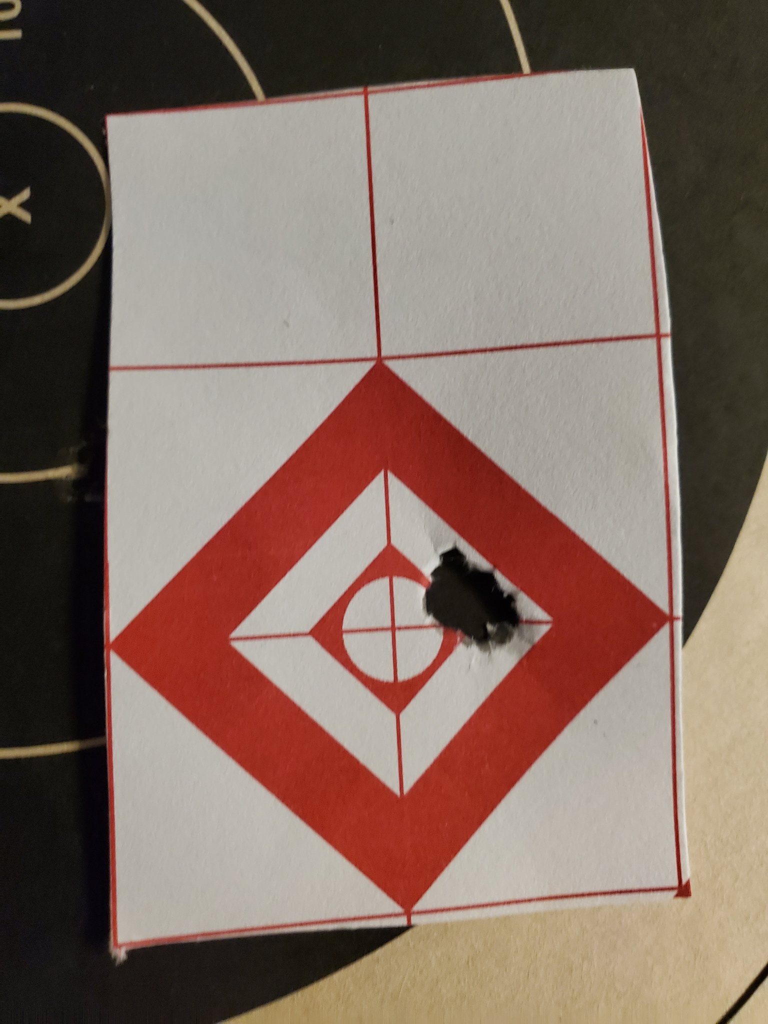

For a factory rifle shooting factory ammo I'm happy with my 5R Gen2. As soon as Triggertech releases them, I'll be adding a 2 stage trigger and eventually when the barrel is shot out I'll send it to LRI to flute the bolt, true the action and spin up a barrel. I don't have any experience with any other brands other than Savage, but one of the biggest draws to the R700 for me is the huge aftermarket. Nothing else compares.
That is typical Remington 700 5R with good factory ammunition.
The gen 1 5R rifles in .308 shoot just like that. With FGMM 175gr I would avg about 5/8” at 100 yards (the few groups I actually shot with it). Solid rifles. I kick myself for selling that thing.
