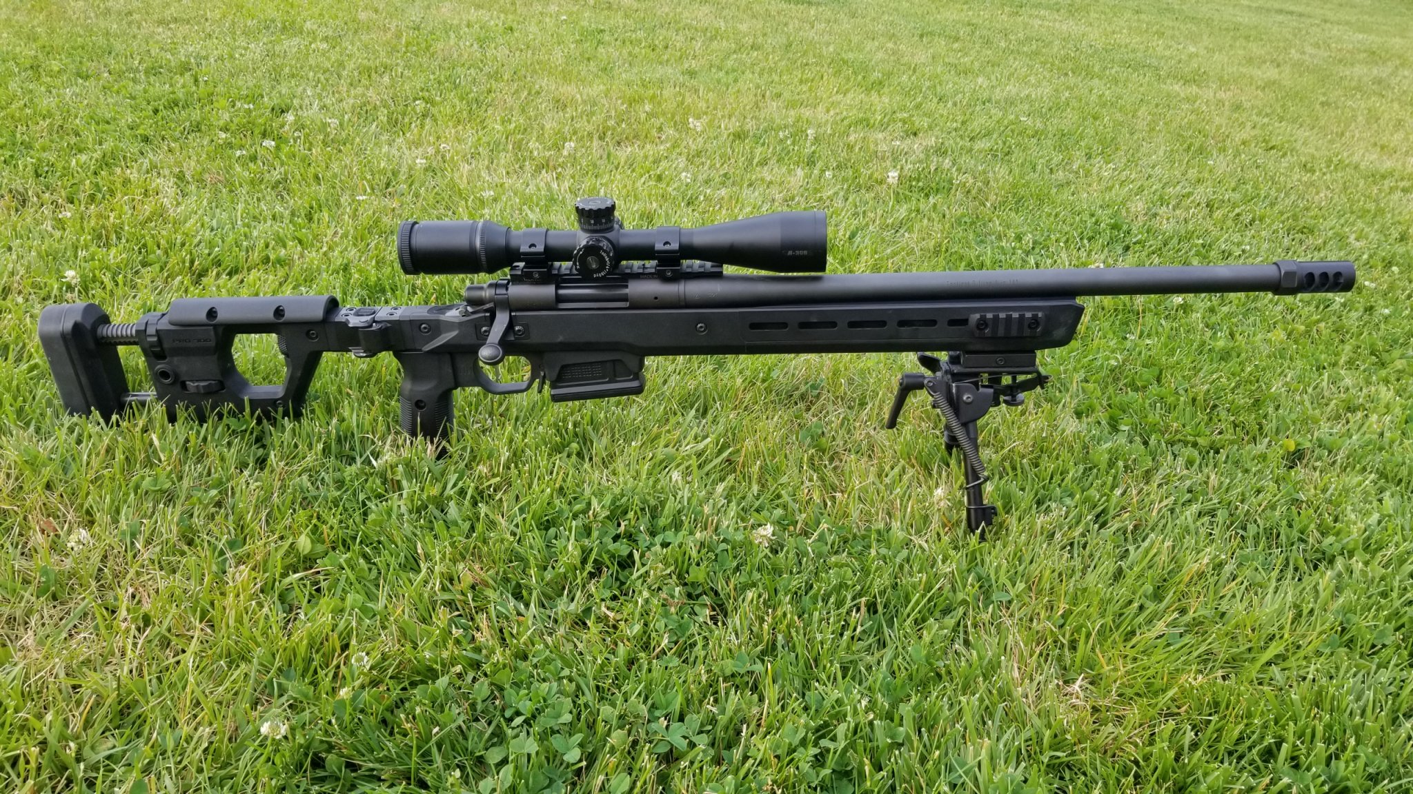

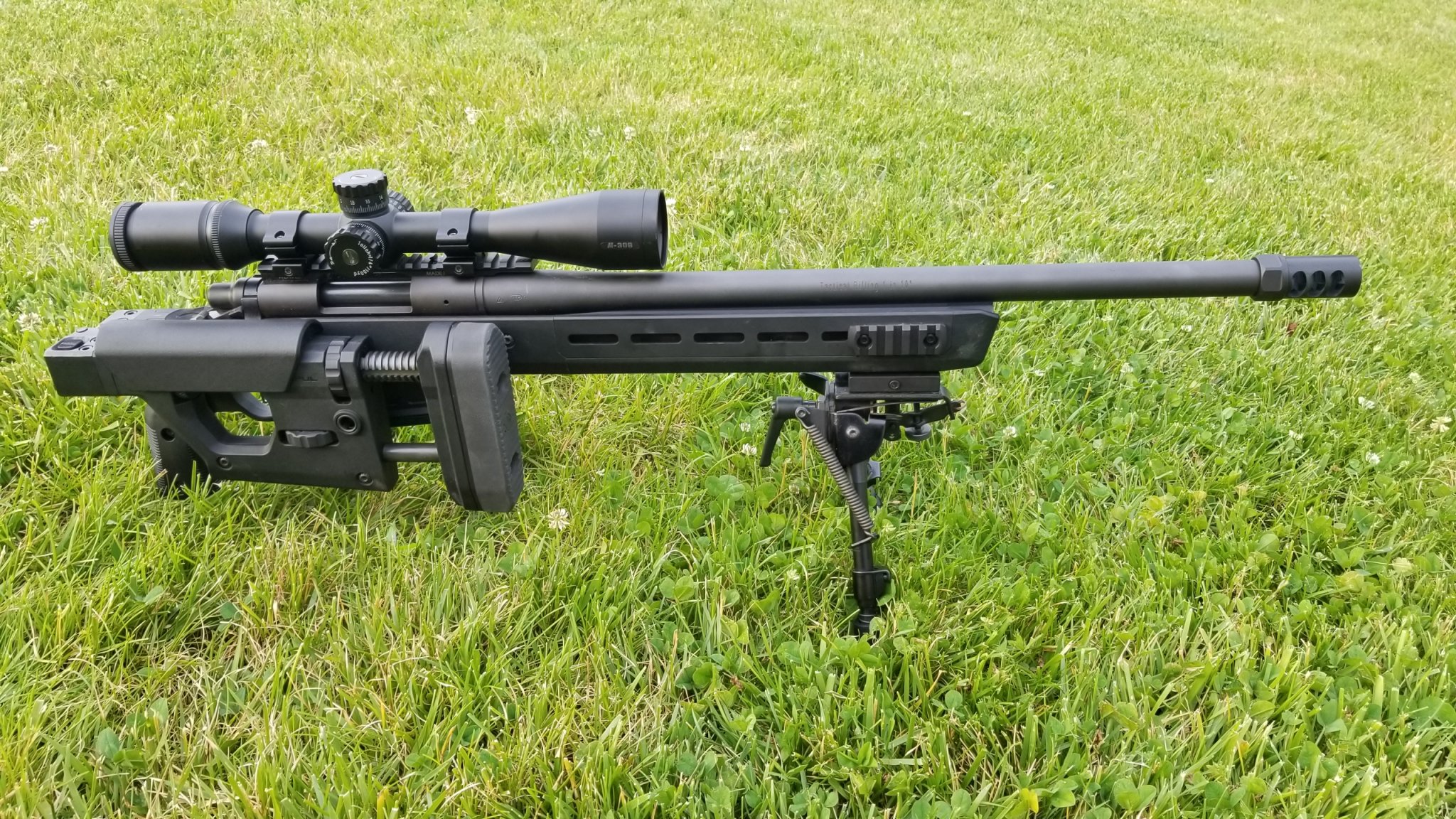

Seriously, was shooting my 700 SPS Tac in .223 sitting in a Bravo stock this past Sunday and shot three 5 shot groups at 200 yds and got a 1/2", 1/2" and 7/16" groups. Couldn't be happier with that considering the bozo behind the trigger.
