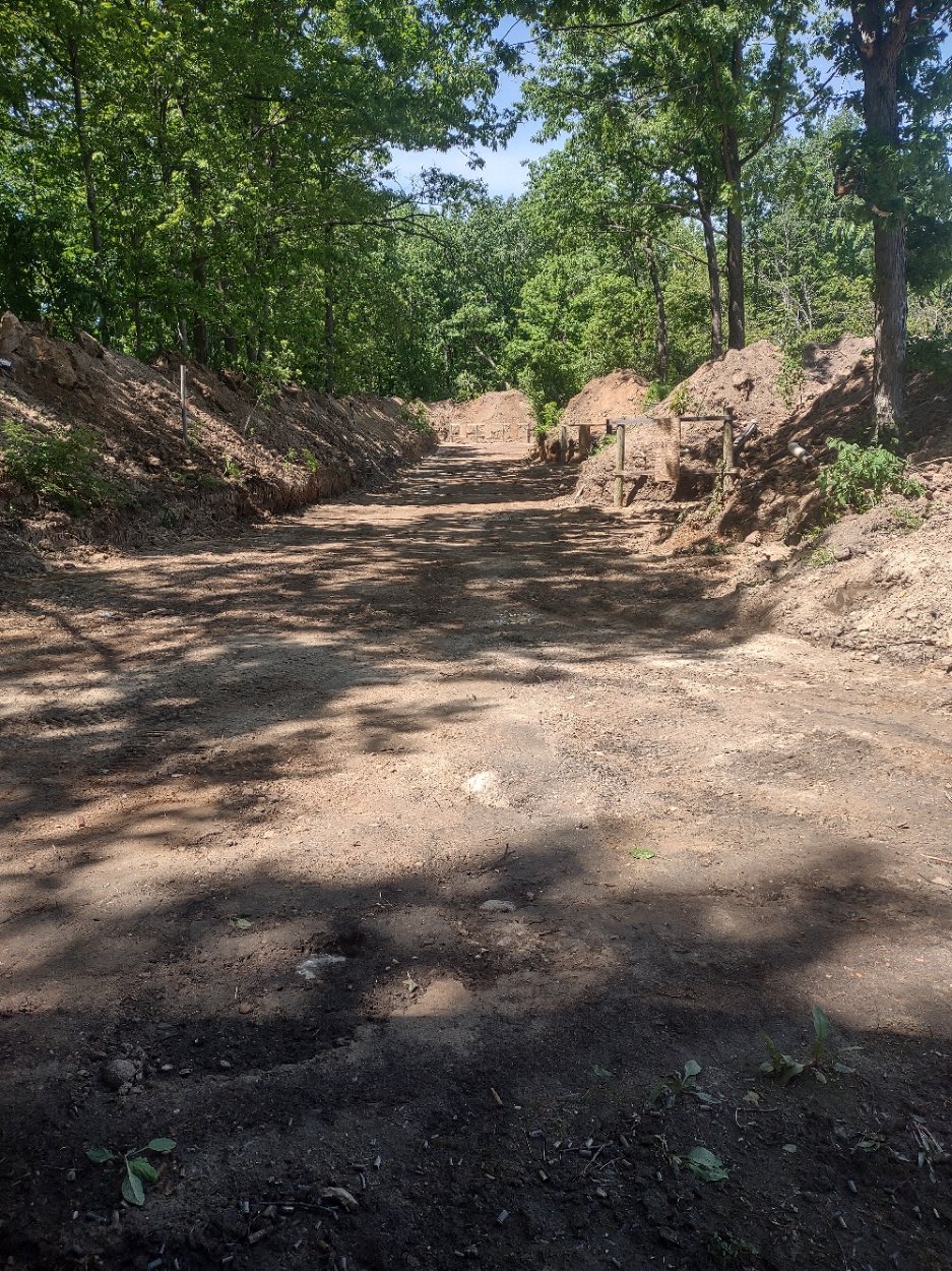

    yep me to .would be at the range now but it rained . its was just cut to improve berms .its clay ,no drainage. it will have sand overlayed but no one is in a hurry to get it done

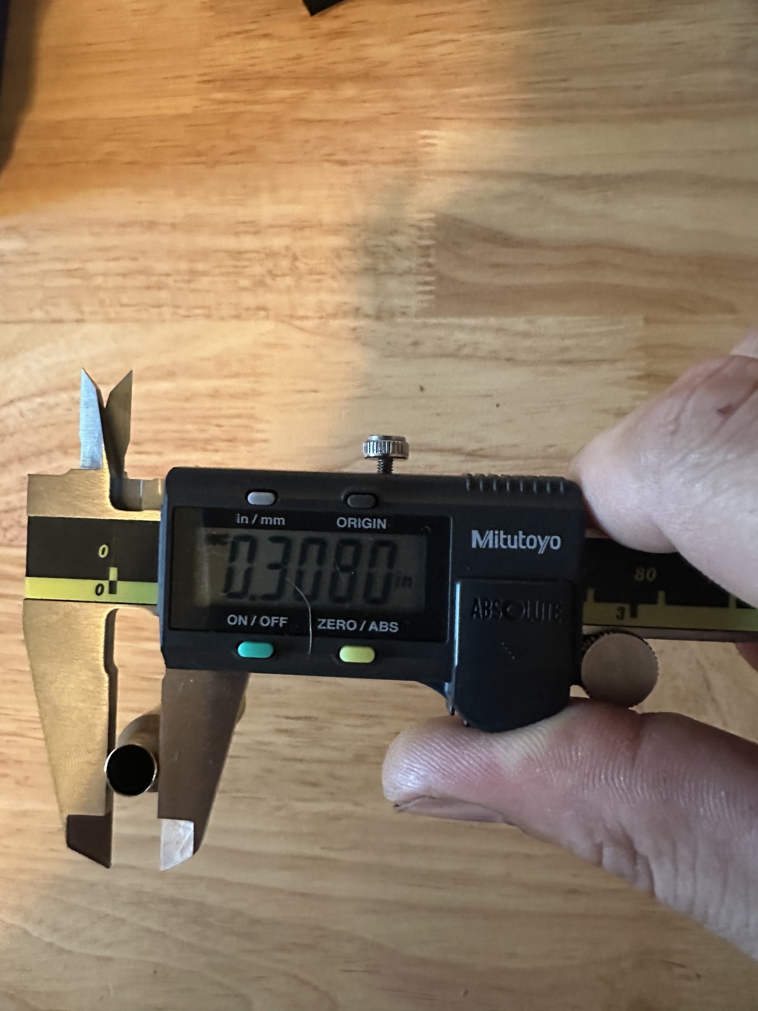

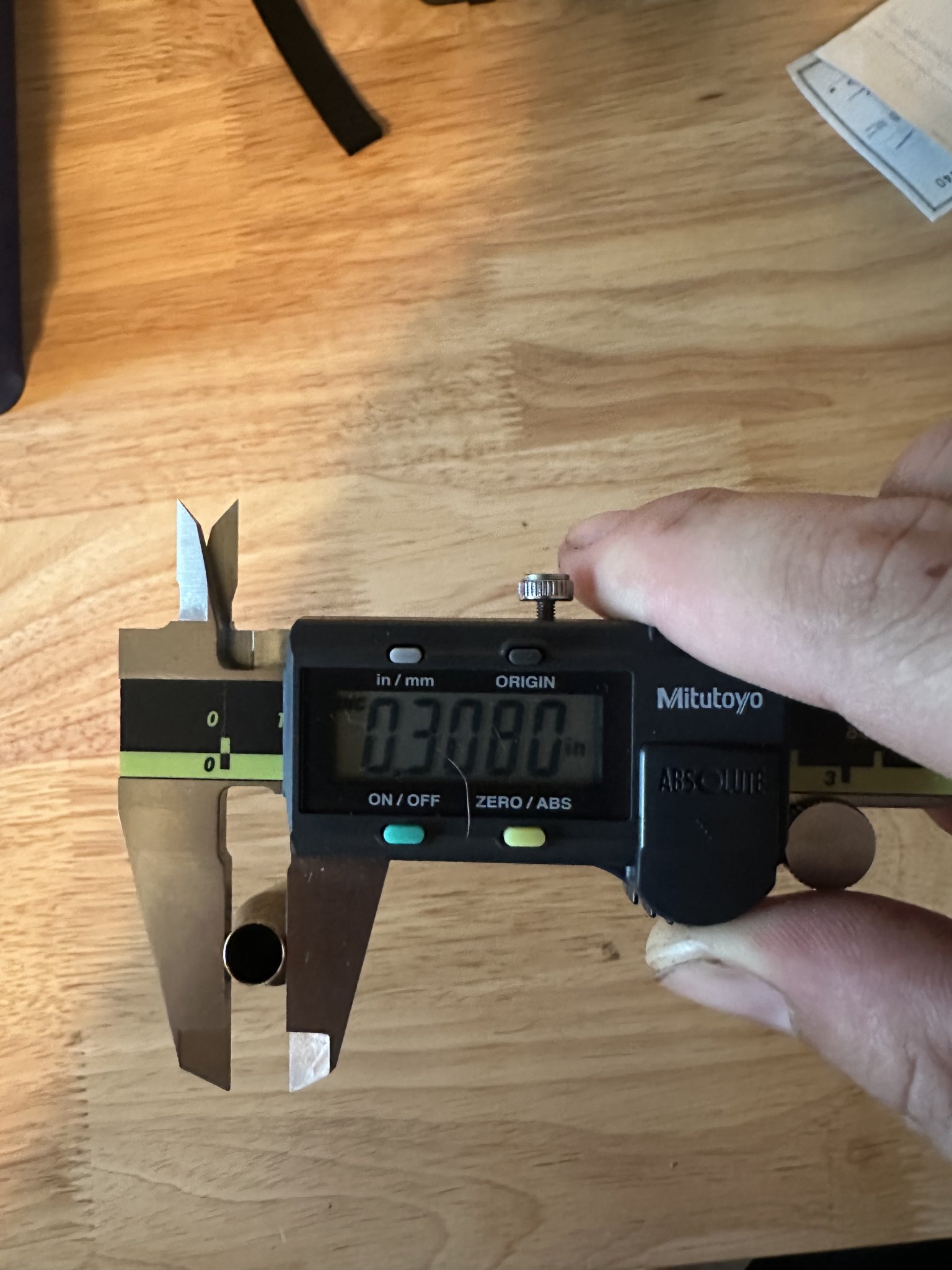

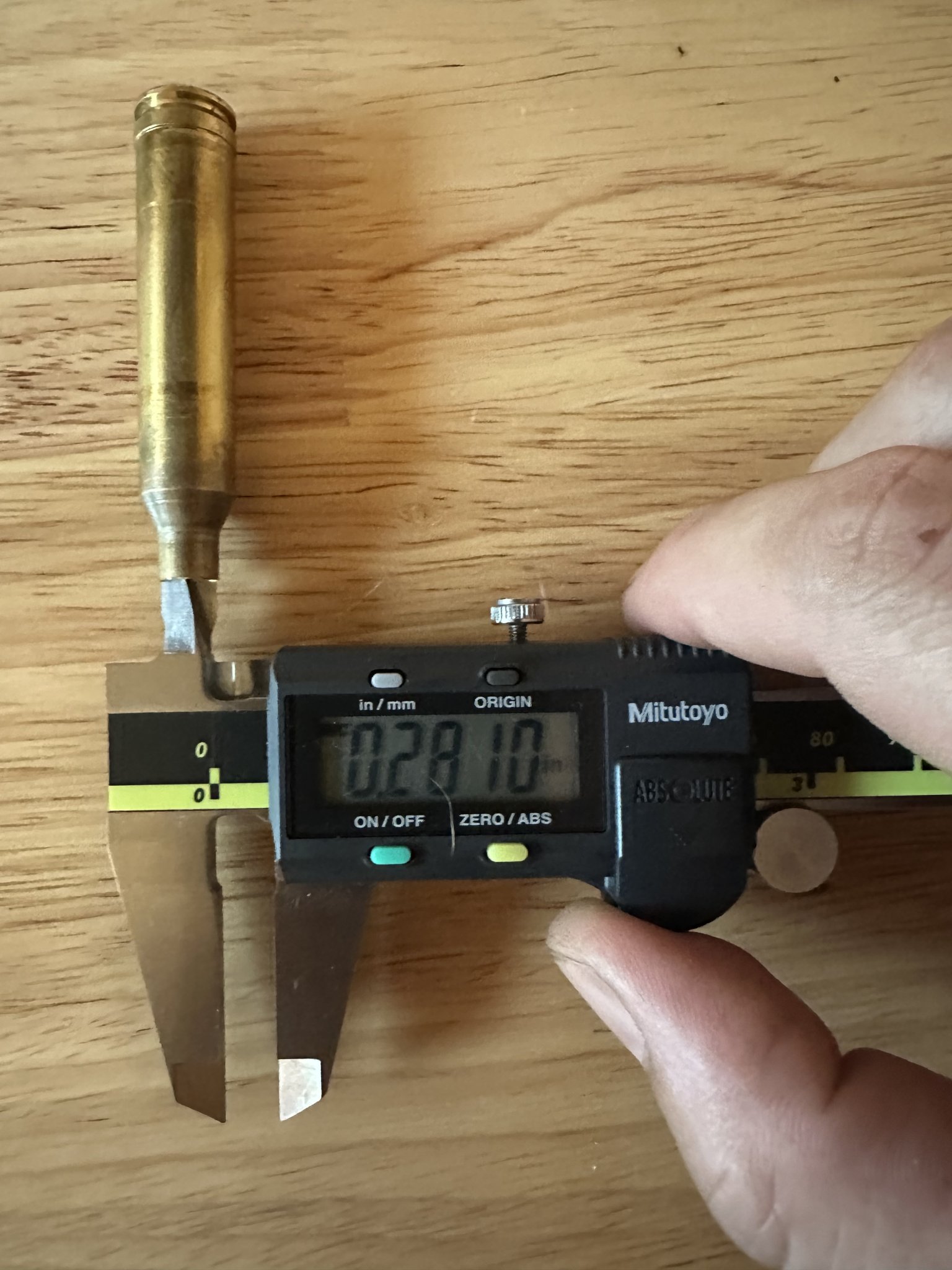

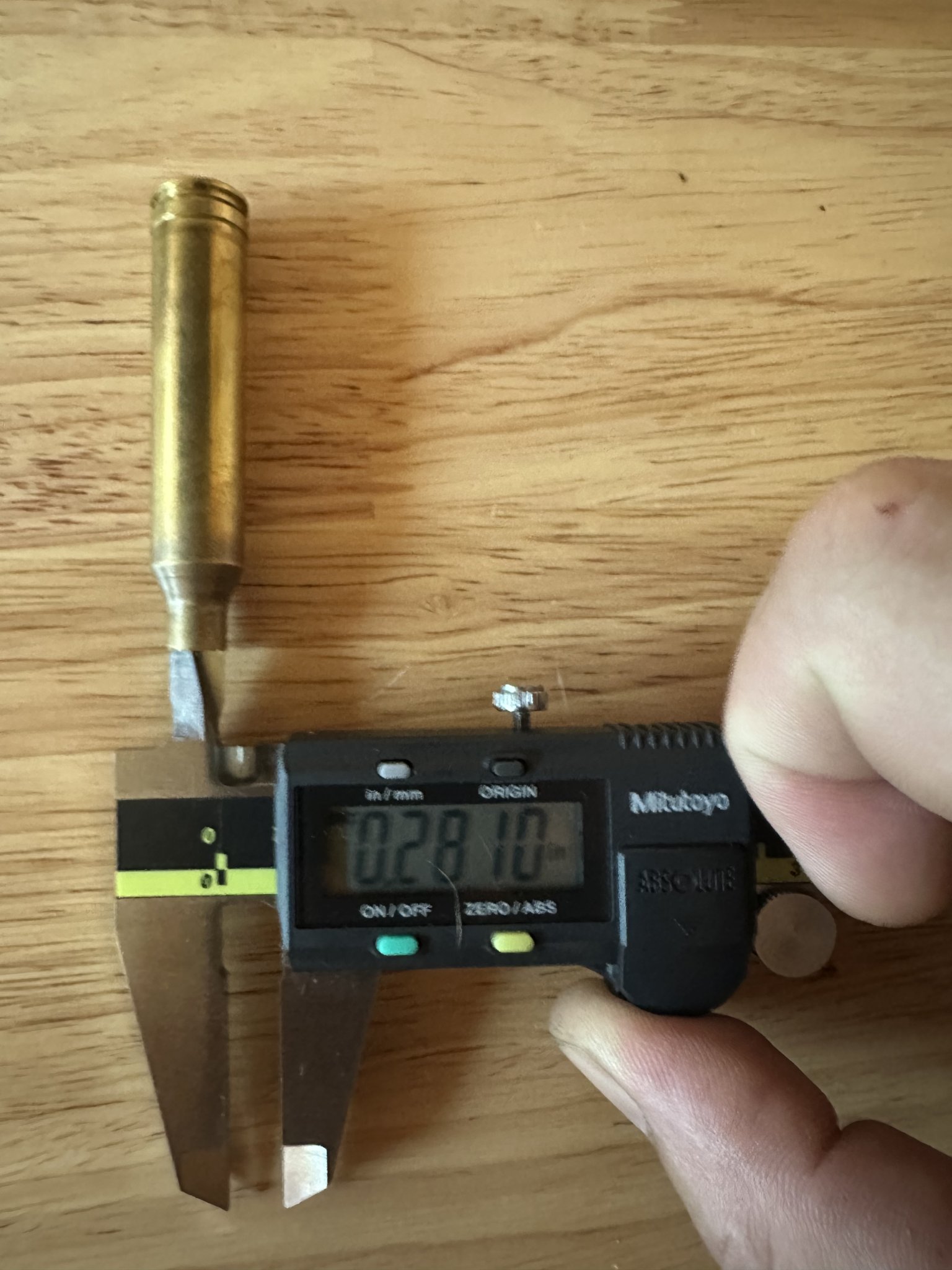

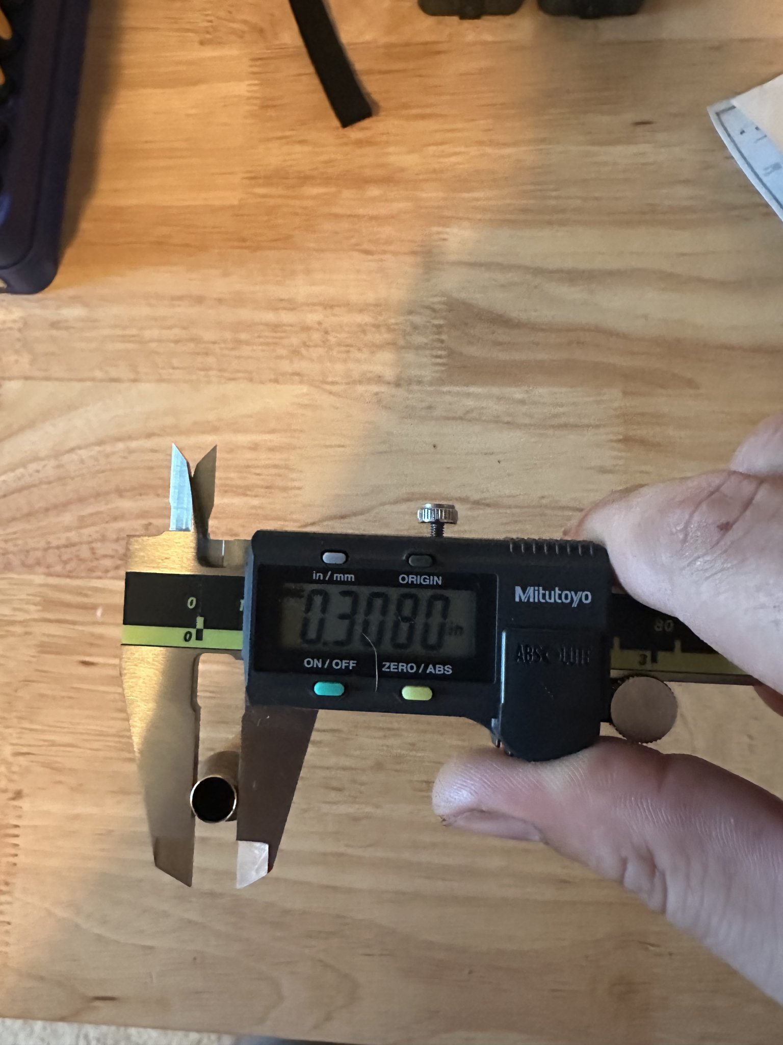

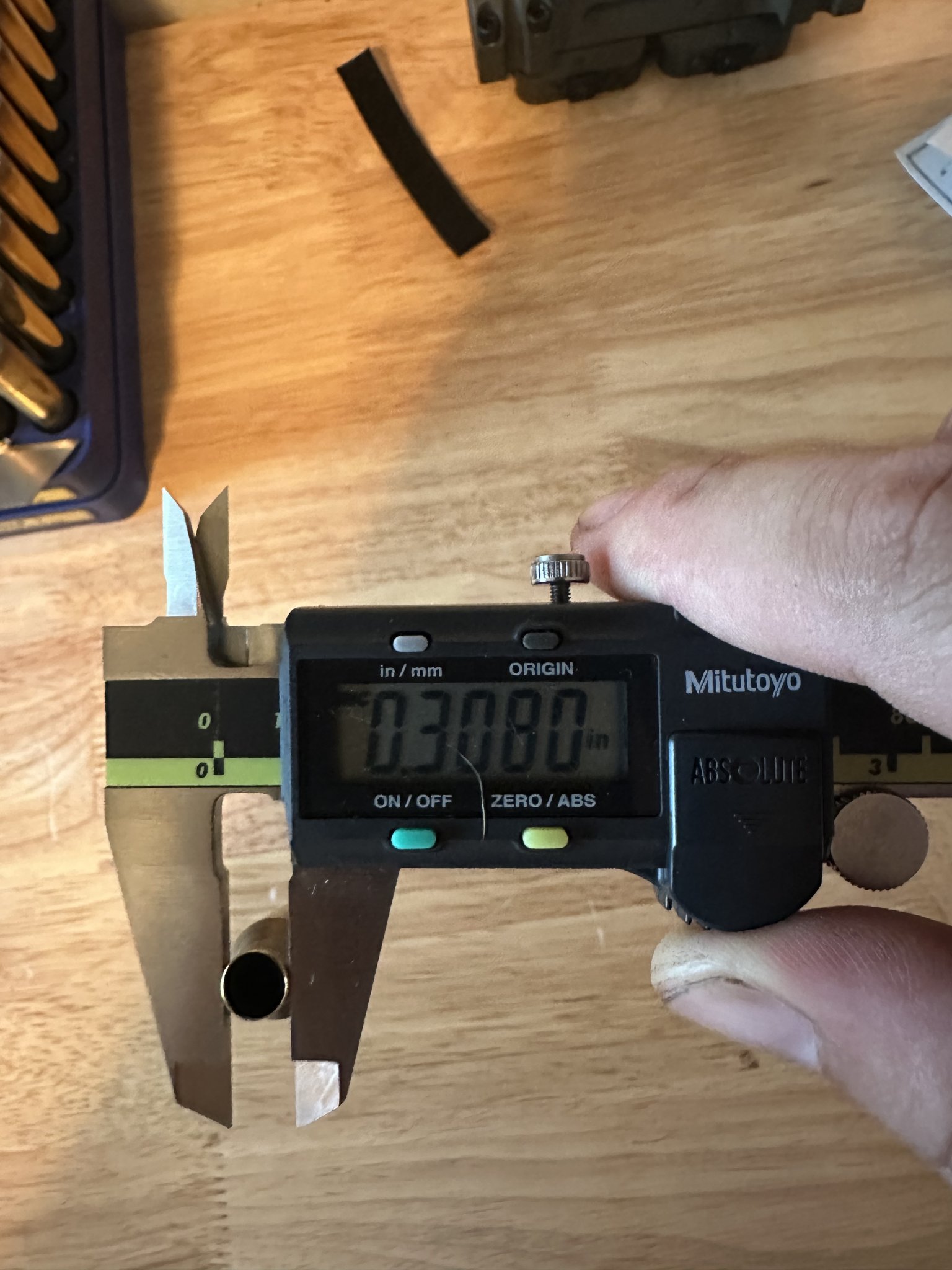

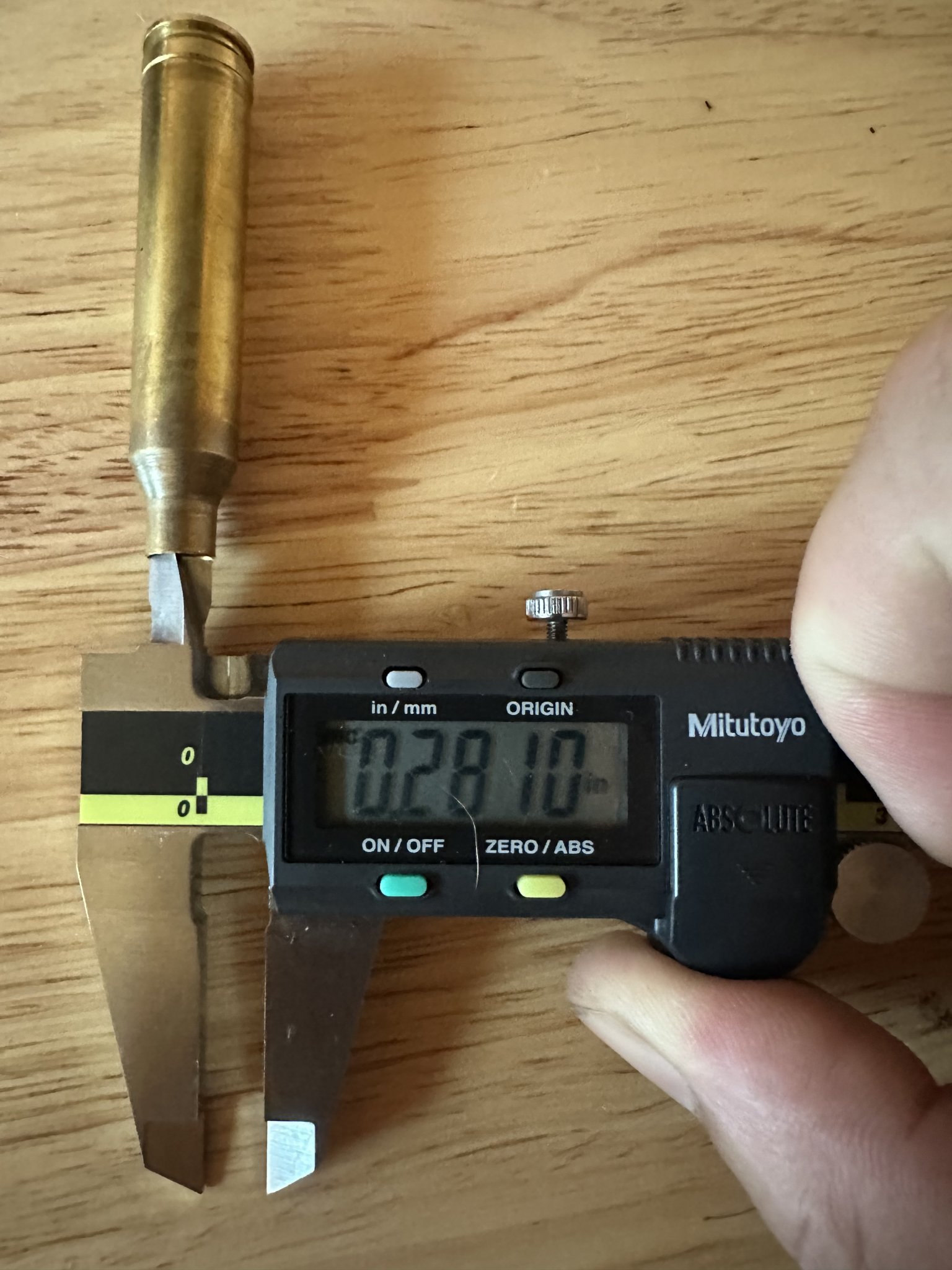

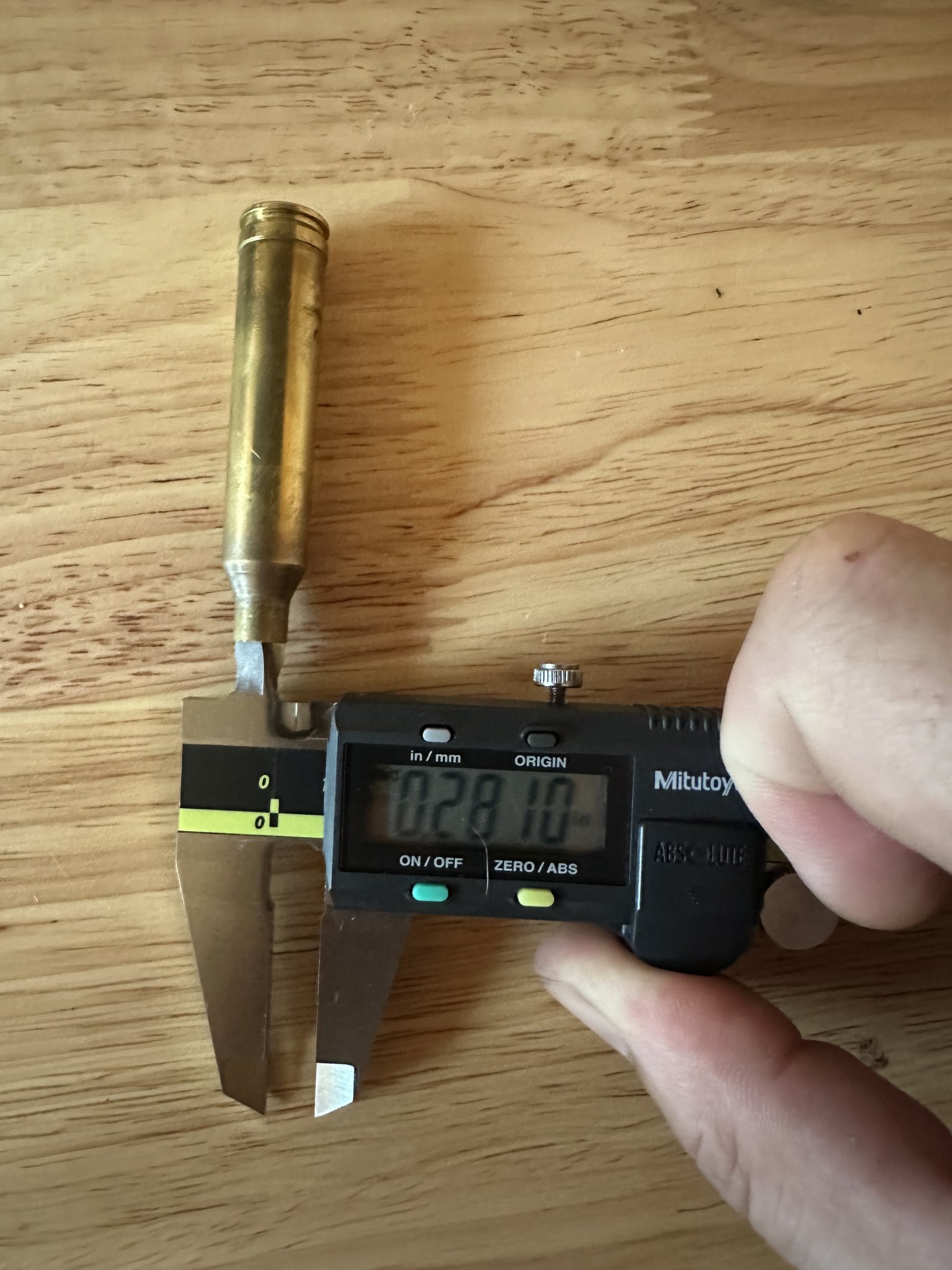

    Here’s 5 cases right off my bench. 308 bushing (that the size not the caliber for people who don’t know reloading @Baron23). Perfect id and od with expander and bushing. And as we’ve already settled above concentricity doesn’t correlate to target (there’s no concentricity argument anyways because these came out of a Whidden custom die) I’m not taking the fun out but people have been testing these things for a long time and have wisdom about what works and helps and what might not. You want fun and to test things - put the mandrel down and go get a tuner.
    Here’s 5 cases right off my bench. 308 bushing. Perfect id and od with expander and bushing. I’m not taking the fun out but people have been testing these things for a long time and have wisdom about what works and helps and what might not. You want fun and to test things - put the mandrel down and go get a tuner.
    LOL at using a caliper.
