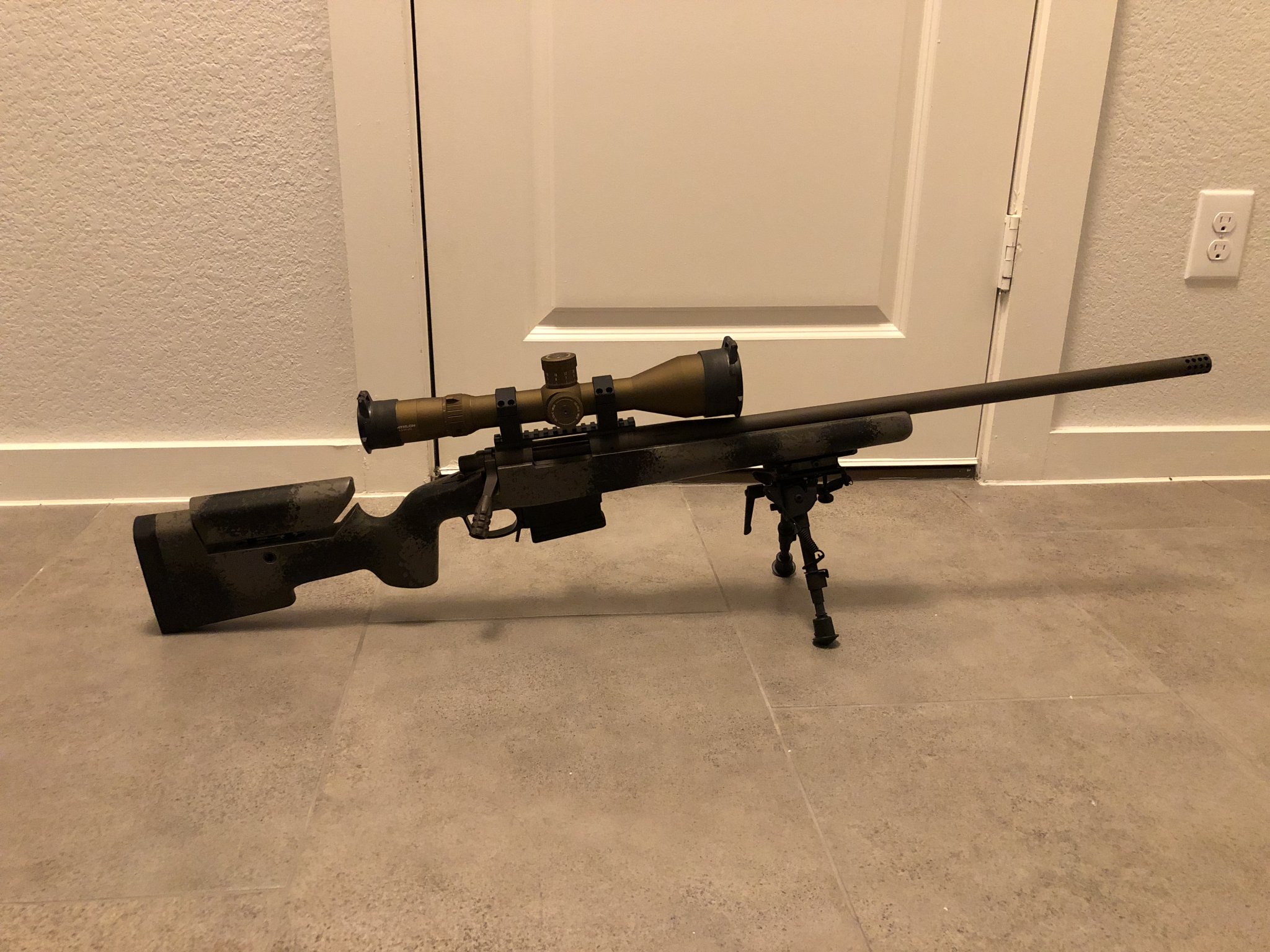

I run a Cronos BTR on my Tikka CTR w/ stock pic rail and I use 34mm low rings Nighforce ultralites. Clearance is about 0.25".

My Cronus BTR is in a Spuhr 4006 on a 30moa NF rail. This is a 300wm, though. It's 1.35".

I went with Seekins low rings for the Cronus BTR on my V-22, which has a 30 MOA rail, and have about 3/16" between the objective & top of the Kukri contour bbl. So, if you go with a 20 MOA rail on your Remington, you should have even more clearance with low rings than I do with my 30 MOA rail.
