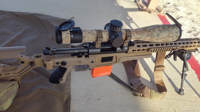

Went to the range a couple times this week with the Minox.
I did a tall target test, and it tracked perfectly. I use a tape measure to get the exact distance.
The glass is great. Turrets are excellent, very tactile, with the perfect amount of stiffness. The parallax and illumination is excellent as well. The reticle will take some getting used to. The center dot is very precise, I found the .2 mil divisions to be easy to use. The reticle is much thinner than the MSR in my Steiner (.035 vs .05), when it starts getting dark, the illumination in the Minox comes in handy.
The markings on the turrets are also super bright. The eyebox on my Steiner is probably a little better, I didn't have any issues getting behind the Minox though. At Max power the Minox is surprisingly comfortable to look through. It really is excellent when you crank it up.
I want haven't used the holdovers yet. I plan on doing that in my next trip to the range.

How do you like the reticle in your AMG?
Overall I like it, but there are changes I would make. I would prefer a fine center dot like the Razor Gen 2 over the floating crosshair, but I like the combination of .2 mrad subtensions and .5 mrad subtensions, very usable. I would like a .1 mrad scale like the MR4 reticle has because I find using the far edges of x and y axes somewhat difficult .
Interesting, I think the .2 reticle scale makes the .1 mil scales kind of unnecessary. I think both are useful. The center dot is still taking some getting used to. I'm planning on shooting some 800-1000 yard targets this weekend, I wonder what that dot will look like at distance .
Granted I'm not using the .1 mrad subtensions often, it's about the utility of the .1 mrad scale when I do use it. I find using the further ends of the main reticle crosshairs kind of a pain is all.
