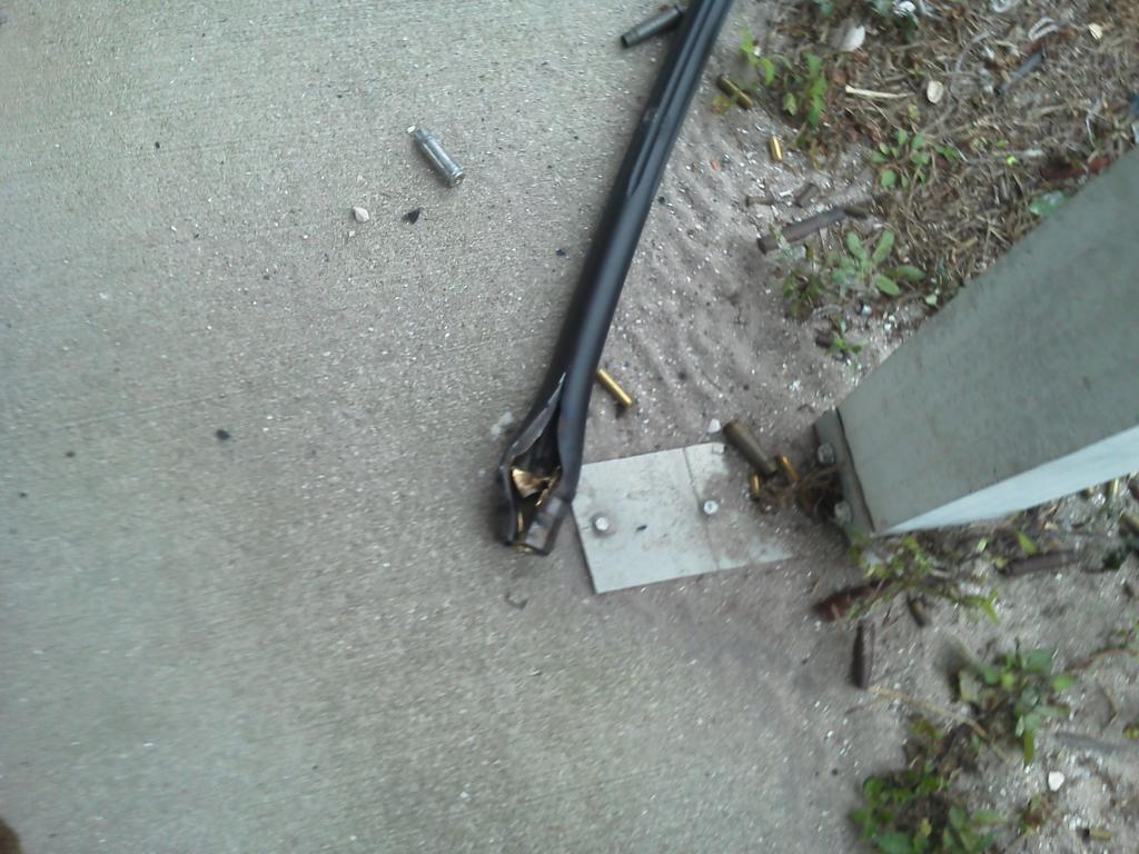

The fellow 2 benches west of me, right next to Ren, had a very bad day! Damn sure could have killed him and quite likely Ren as well.
Something blew clean through the roof in two locations!

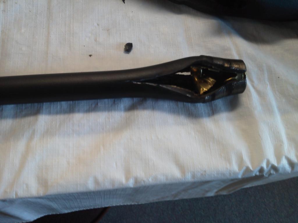

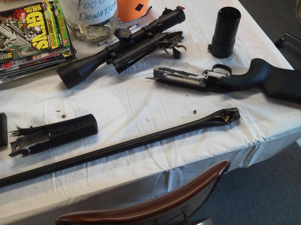

What was the reason this went the way it did? I see that there is a rod in the barrel in one pic. Was that the reason? Curious on how this went. Glad no one got hurt or killed.
Happened this afternoon at the Manatee Gun and Archery Club.
Al, Ren and Myself were there with a couple other folks.
Ren was at bench 12, I was at 13. The fellow at 11 is the guy who had the Kaboom. He was running a Savage .338 Lapua.
After the boom, I heard Ren ask "Are you alright" and then turned to look in time to see the fellow reacting in total shock. Literally stunned.
Ren and I went over to him and could not see any major injuries. Ren was uninjured as well but had a lot of fiberglass splinters on him.

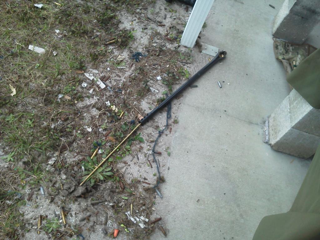

The barrel nut is what I presume punched the two holes in the roof. One was ~ 1" square, the other about half that size.
The shooter is a regular there and is a pretty smart guy. He had been having a problem with sticky cases though he said he was certain the loads were mild. That's why he was content to knock the sticky ones out with the rod.
He simply forgot to remove the rod after knocking out the last stuck case.
You can see what happened next.

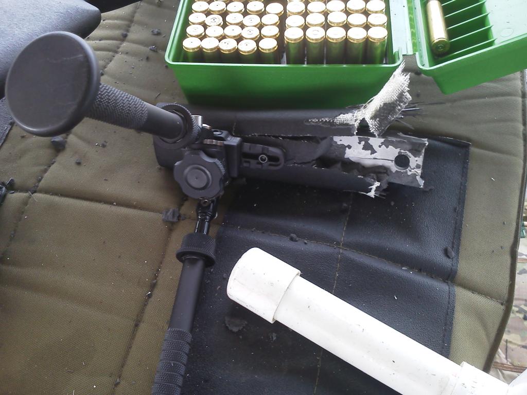

Look at the fired brass. Looks like I can see punctured primers and some with blow by. Glad he is not hurt bad. Maybe next time he will back the load off a notch and not have to worry about stuck brass.

That's pretty much exactly it. I think there was one free bench between me and him. Luckily Alan was up in the club house, as Him and Michelle would have been right beside him at the time of the rapid field striping of the savage. Yes the action, barrel, scope, stock are all trashed.

This also shows just how good the bolt action design is. The pressure in that thing was probably 100k psi or more, and the failure directed the bad stuff in just about the safest way possible. Think about how many tons of bolt thrust that was pushing the bolt straight back at the shooters face with no ill effects. Everything fails in the right order. Amazing from an engineering perspective.

He is also damn fortunate that he caught a break. And so are Ren and myself as the shit that blew through the steel roof was going fast enough to rip through him or us.
