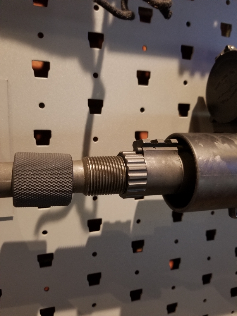

Now for the suppressor. I have the version with the threaded gas block, so the suppressor screws onto the gas block. From what Ive read, those suppressors did not make it into civilian hands. The suppressor you linked was to one that quick attaches to the gas block, for the mk11 mod 0. I am asking about the SR25 Match, with the 24 inch barrel (not 20).
That’ll have to be custom made.

Did you get a suppressor built? Looking at picking up an sr25 match as well here
