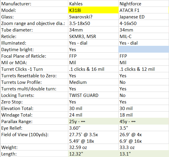

    Just a heads up, this chart has some errors on it assuming it is supposed to be representative of the 4-16 ATACR.
    What errors?
    I see now that I've had coffee that it's listing the 4-16x50 ATACR not the 42 so not as many errors as I thought but the ATACR does not have a dial for illumination brightness and it has a capped windage so I'd consider that locking. Not sure about the optical specs but I'd research it a tad to be sure it's accurate.
    Thanks Six, I've updated my spreadsheet to identify the capped windage and illumination. Does the 4-16x42 also have capped windage or is it an open turret?
