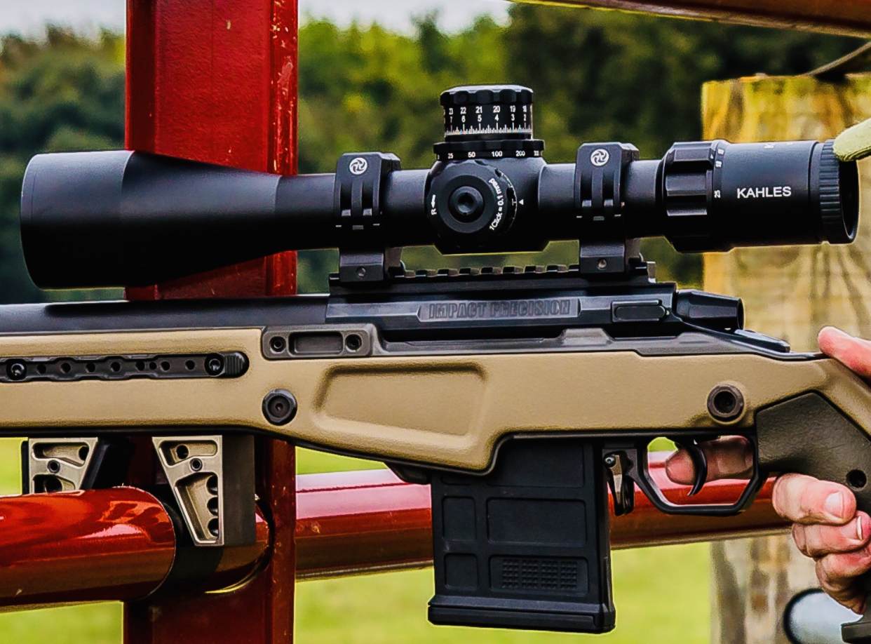

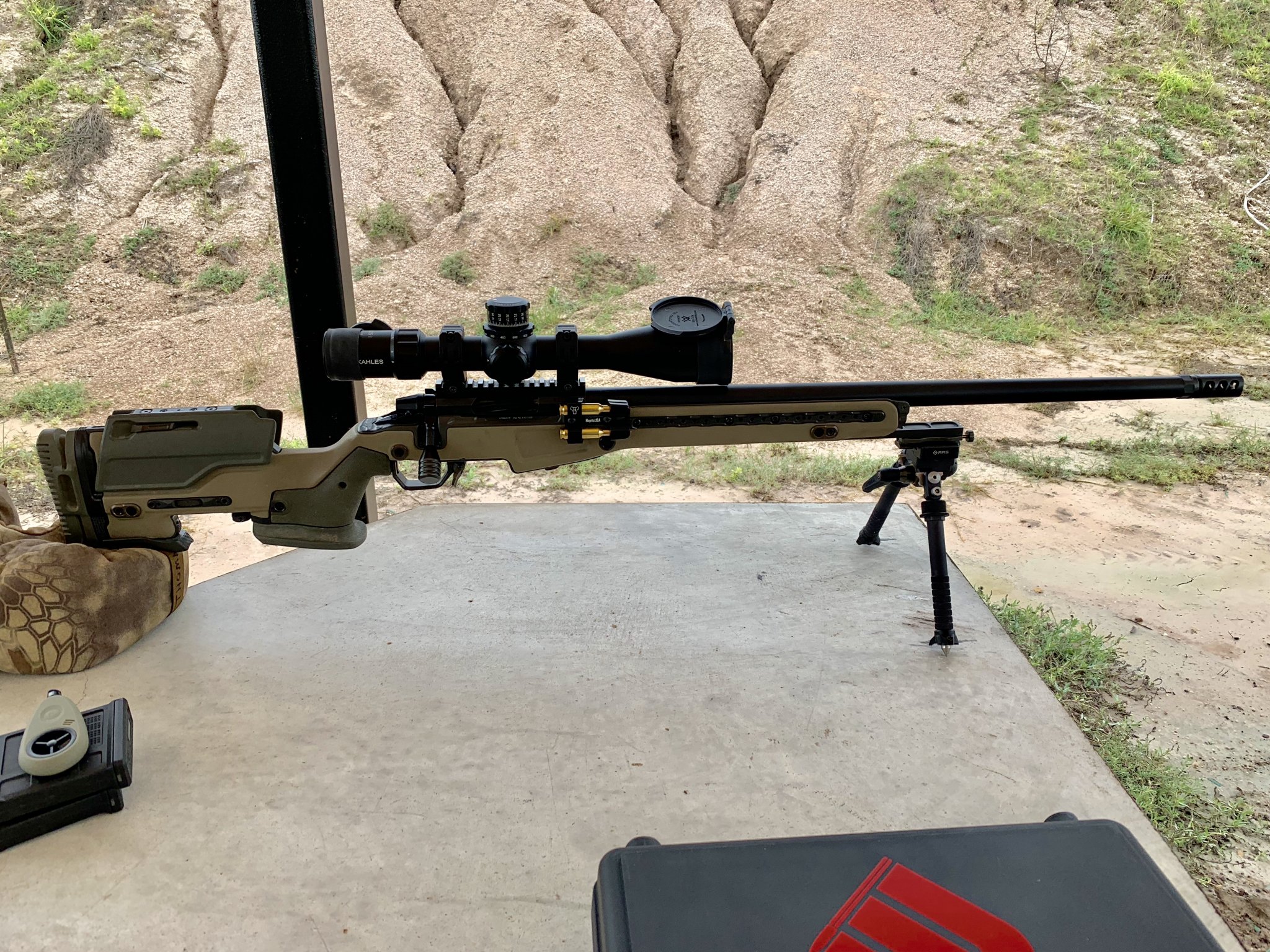

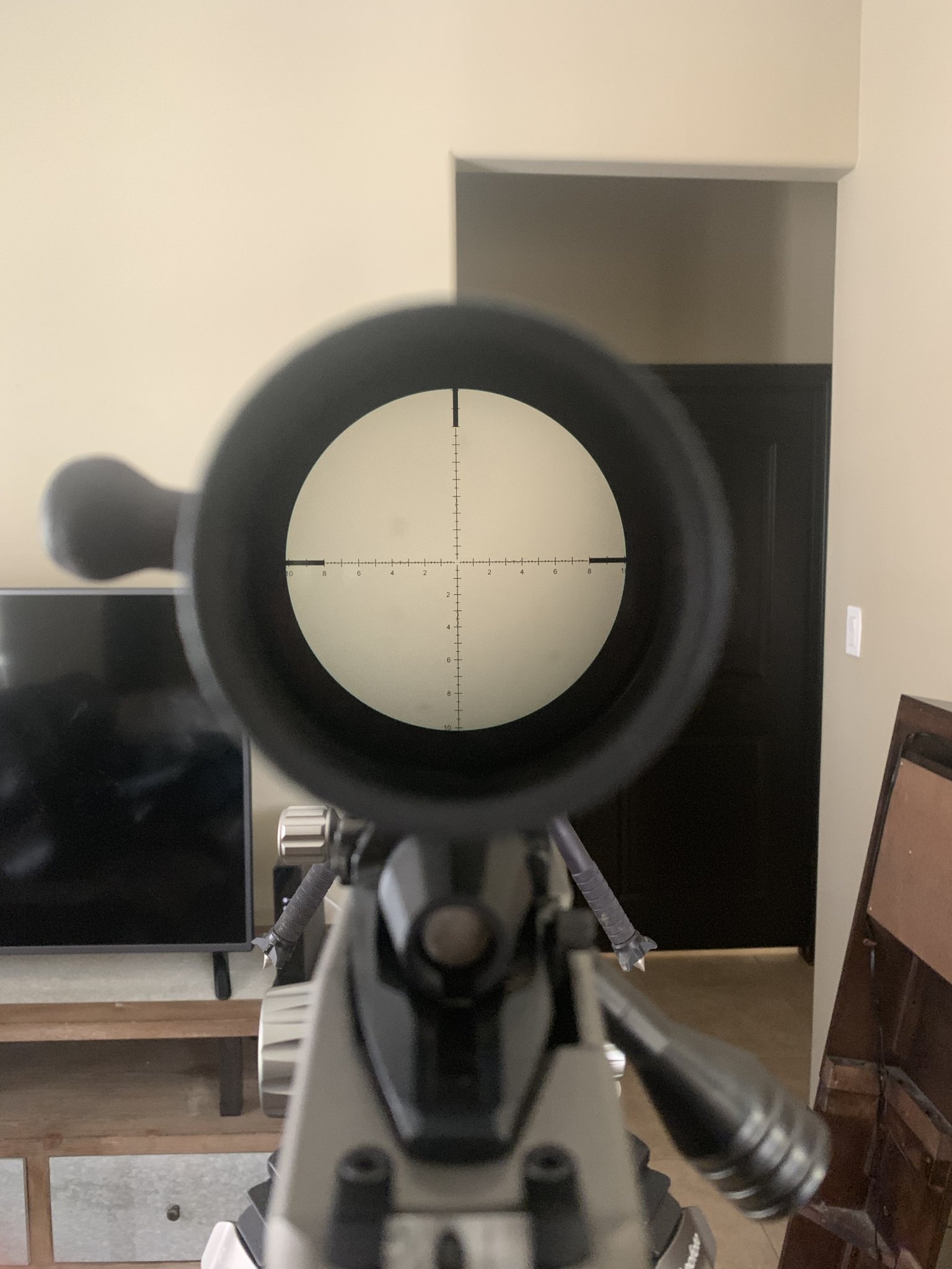

    Here’s a few pics for reference.

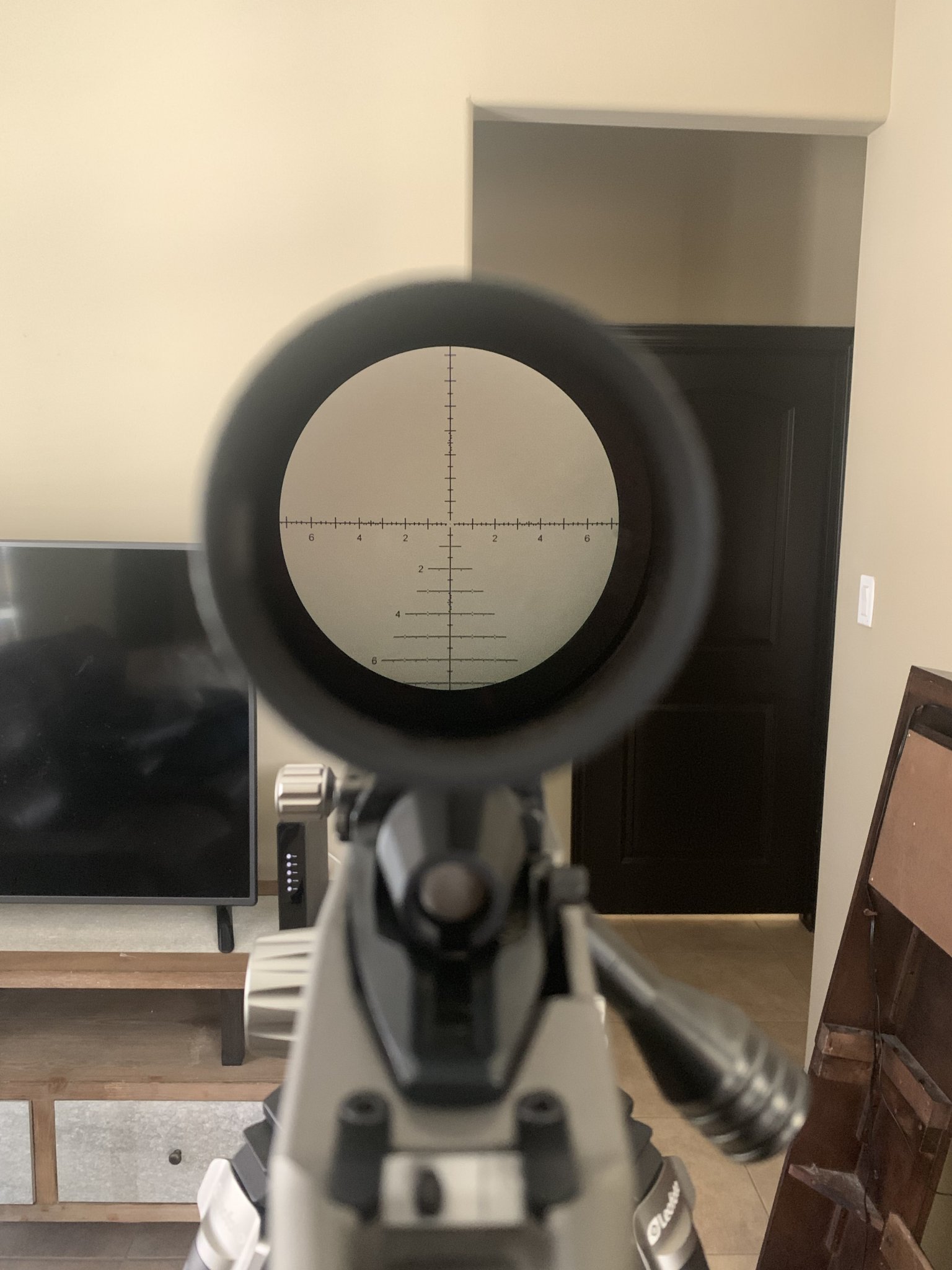

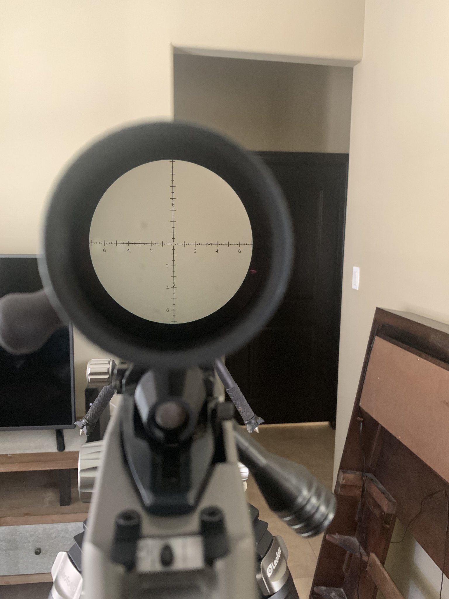

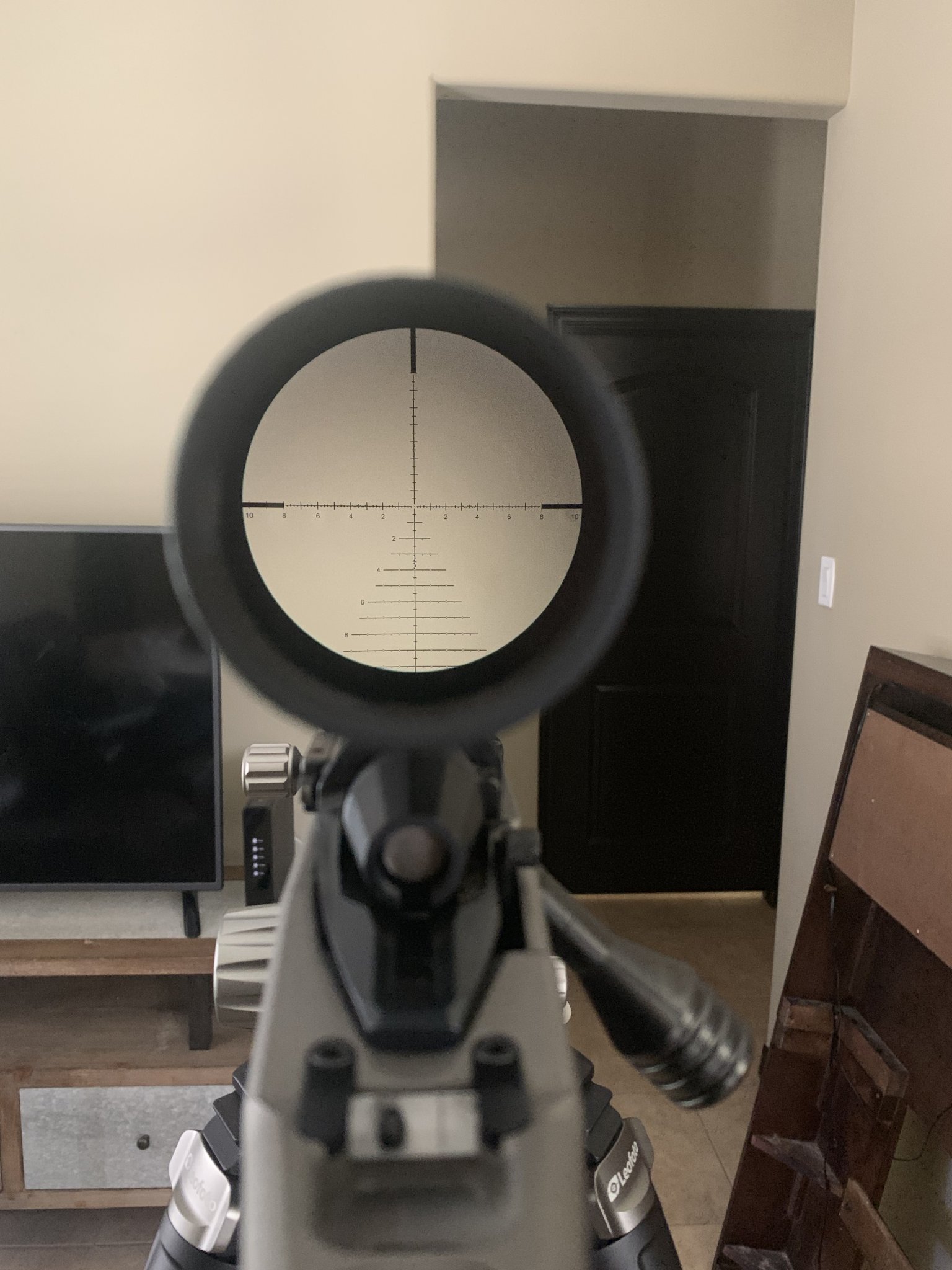

    After using the 525 a bit more, I concur the fov at 25x isn’t too great (compared to other optics).
    It’s not enough to be a deal breaker, but it’s defin noticeable.
    Anyone who would potentially be bothered by the fov should probably check one out before buying.
    Again, not enough to be a deal breaker for me. I’ll still be running with it.
    It's pretty tiny and a large step backwards from the previous design. Not unusable by any means though it's slightly above the Mark 5. It is a compact design though and i guess that's the trade off for small FOV and shallow DOF. I'd have personally kept it long, upgraded the erector system along with glass, and fixed the issues the 624i suffered from. It would be hard to beat if it retained the FOV of the 624i
    Reactions: blbennett1288
    I love mine. Yes FOV at max it smaller but I have found that the 20 to 16 sim to be a lot brighter and just as useable as many other of my scopes. Now that is for me and my eyes I don't want someone to say it is different for them. As it should be.
    18x seems to be the sweet spot for this optic. FOV and clarity are awesome there.

    Skmr vs Skmr3 at 18x and 25x
