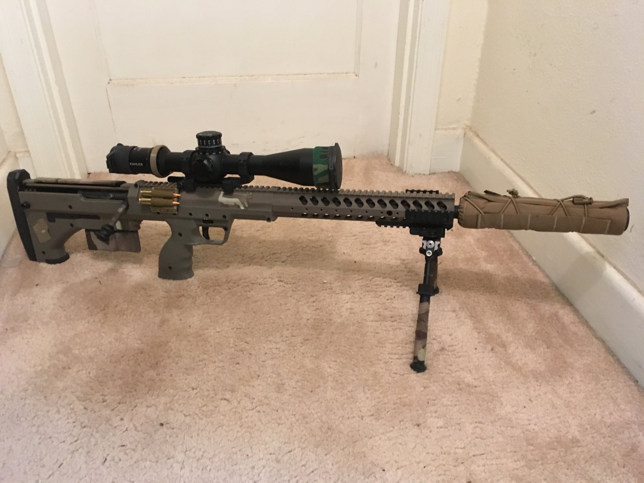

I have been using this scope of a little while and have come to really like it. The FOV at 25 is fine for what I am doing. I don't stay on max but come back to 15 to 18 and that is about prefect for me, even down to 5 is very usable. I have used it in bright sunlight and on dark cloudy days. No problems. Just did a tracking test and it is dead on. If you need a new scope I recommend you get in touch with the guys out at CS Tactical and check out this scope. Now I know someone will say something about it but if the scope works for you as this one has for worked me you will be very happy.
