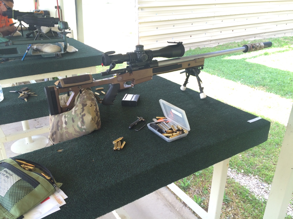

Mounted mine in a 6 mil spuhr mount on a 20 MOA surgeon action and had 23 mils of elevation from my 100 yard zero. ImageUploadedByTapatalk1398087150.068364.jpg

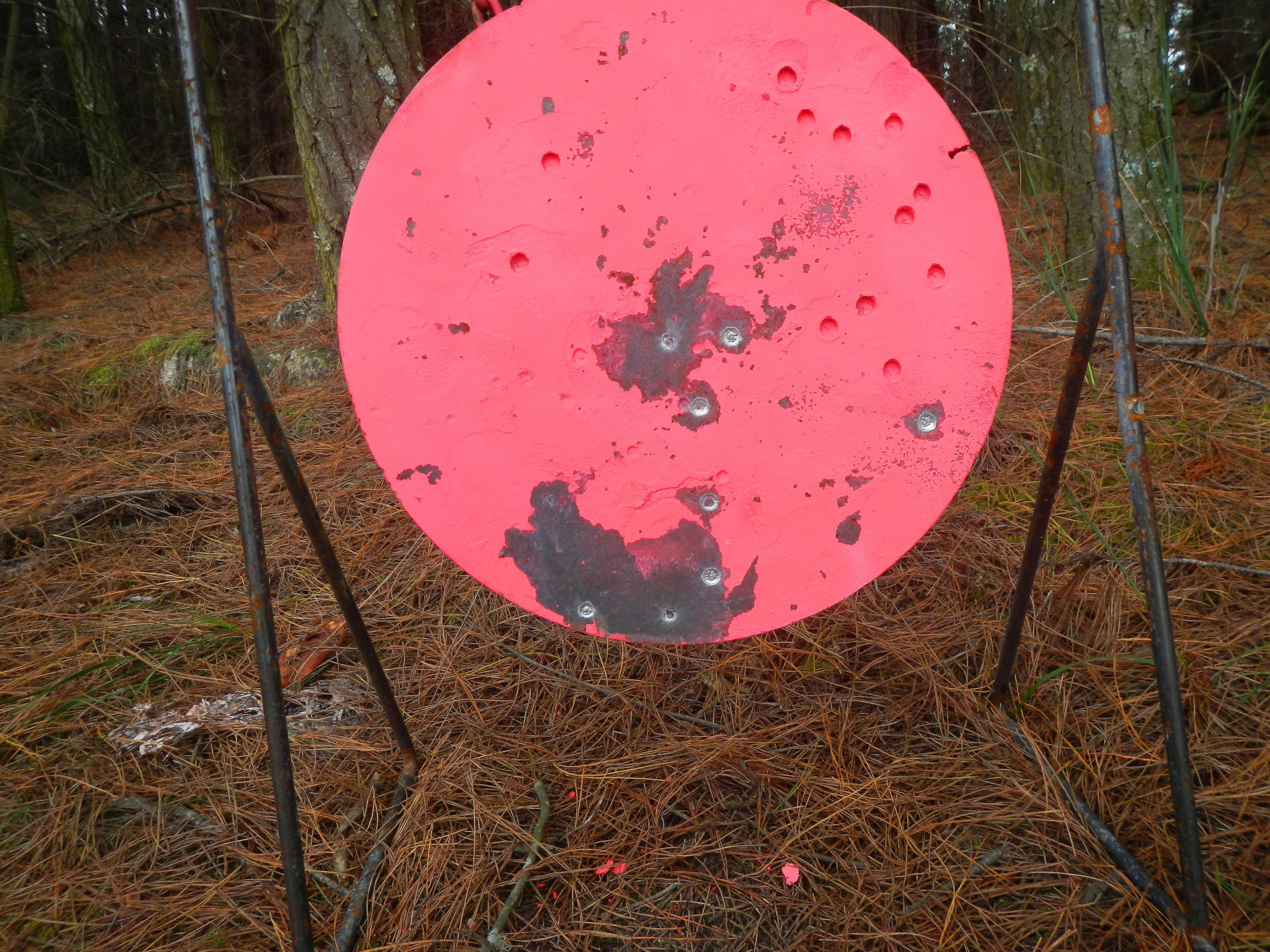

sphur 20moa ring mounted to nightforce 20moa base ....took her out today retweaked scope base alignment as much as i could and now have 3.8mils right and 6.4mils left ...not at all perfect but will have to do for now i just want to get time behind the rifle ...and a total of 21mils of elevation :) set at 100m zero all set to go ......now all i have to do is figure out how to get these damn 230gr bergers to shoot tight groups!!! grrrrr :mad:

i did consider that factor and after 40 odd rounds i didnt have to adjust windage from zero too much tho ...groups are two touching then one high ...or one low then two touching ..or one high one left one right ...seemed to be standard open groups ..my old mans advice was to fill the screw hole areas with bedding compound ..something i am considering doing now you mentioned it because the thought had pooped into my head too ....but my groups where the same using the proper rem 700 nightforce base before hand ...i just couldnt tweak it as far left as i could the hs base to get windage more centre

I mounted a Kahles K624i AMR on my DTA SRS in DTA 20 moa base/rings when the scope arrived, and after zeroing the 6x47 Lapua bbl at 100yds, had 14 mils of elevation left. Moved the Kahles over to a M700 - also in 6x47 - with a NF 20 moa sloped base, and now have 21.7 mils remaining when zeroed at 100yds. If I mounted the Kahles on another of the M700s I have, I'd expect to find that the amount of elevation left over & above a 100yd zero would be different than it was on either of the other two rifles I've had it on.
Point is, mounting a scope on different action/bbl combinations will have different results. Since your M700's receiver is drilled & tapped so as to result in the scope being slightly off axis in windage, it's no surprise that its contour results in you having less elevation than you might've reasonably expected.
