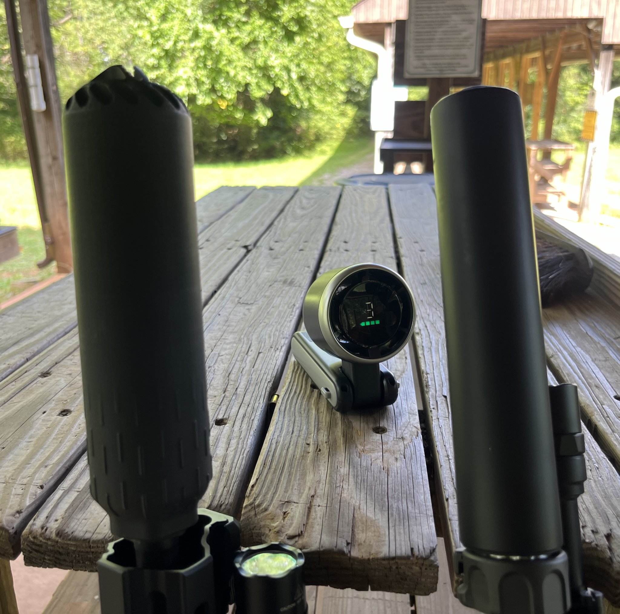

I went to the range to try do a comparison between a recently received PTR Vent 2 and DA Mojave, but instead, I got caught up figuring out which host I liked more: a DIY CMMG radial delayed upper and a MEAN Arms upper. (Turns out, at least this trip, the CMMG...)
Anyway, I'm curious if anyone else has a small fan in their range bag? Ive found this one does a great job of cooling off a hot, just-used suppressor and so I don't have to wait as long to pack up.

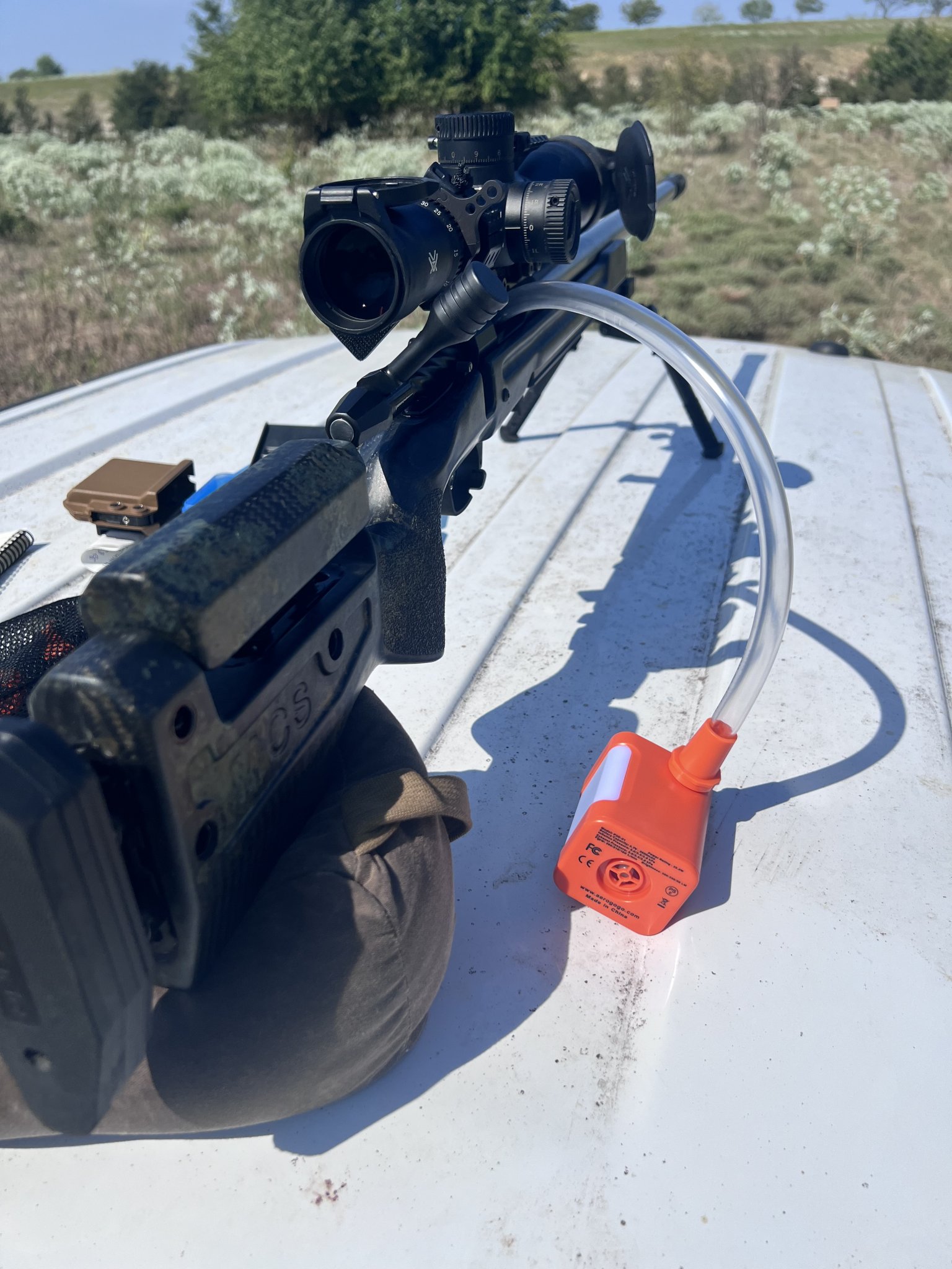

Magnetospeed etc have weak low-volume fans, not worth the time IMO. I attached some 1/2” vinyl tubing to One of these. Works great to cool barrels, but I haven’t tried it with a suppressor mounted
Pretty simple setup, but I’ll have mine out today if you want a pic

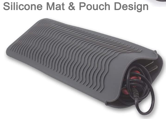

See if your dealer has any of the Silencer Shop mitts, they usually send them out to them. They work great for removal and to wrap around for transport, fit into the pockets intended for your hand.

I use a silencershop mitt thing to remove a suppressor when it's hot and transport it either in the mitt or in a TacOps dragbag suppressor pouch and it's been fine. Rifles Only makes suppressor pouches as well that will handle some heat too. Use a mitt to remove from rifle and place in pouch, just don't get too stupid with the heat and you should be fine.

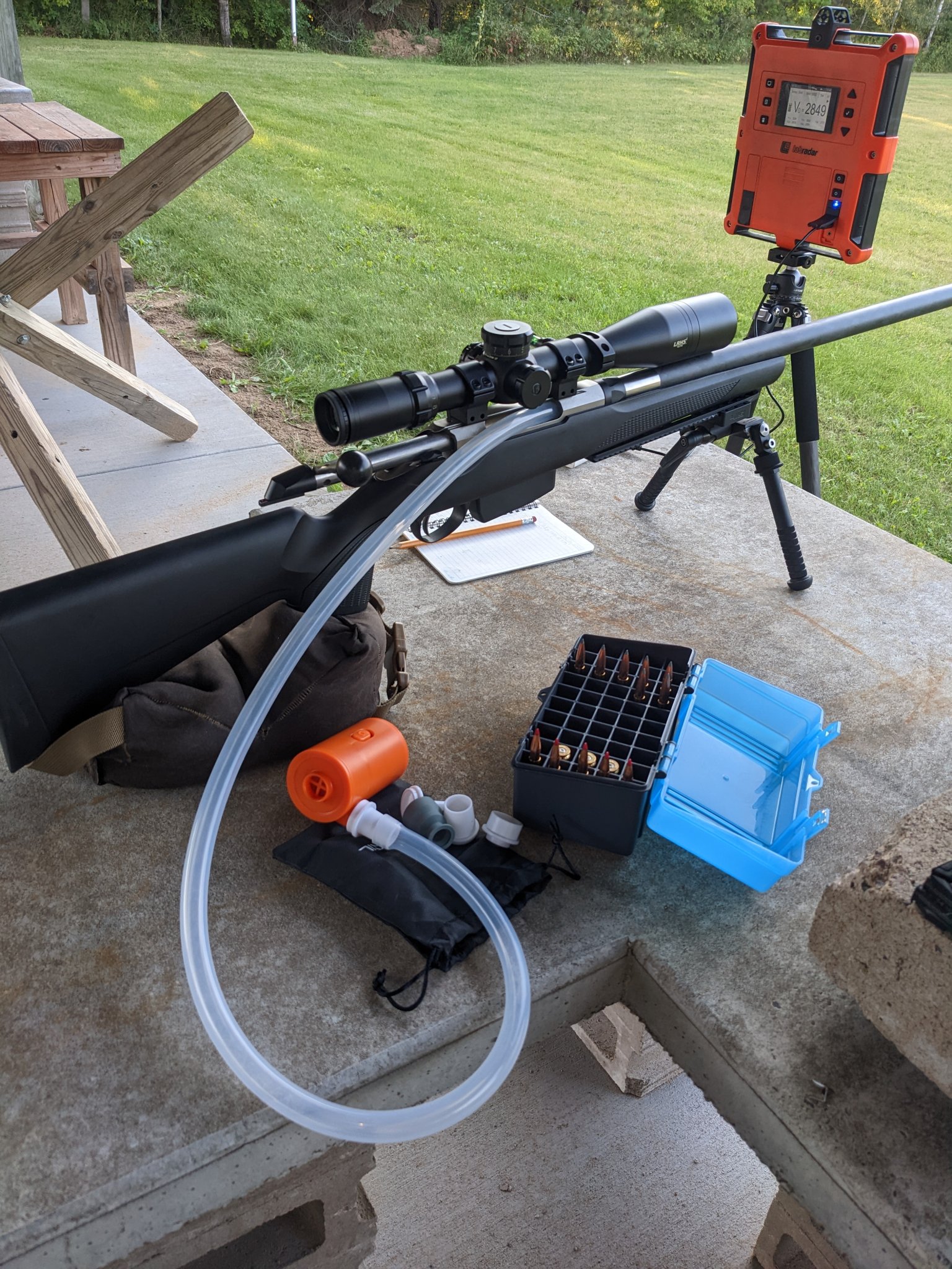

I use a similar little pump, but I'd definitely recommend using silicone tubing. Much higher temp resistance (~200 vs 450+ F). Melted plastic in the chamber is a bad day.
Bonus is that the pump can act as a battery pack for the LabRadar.

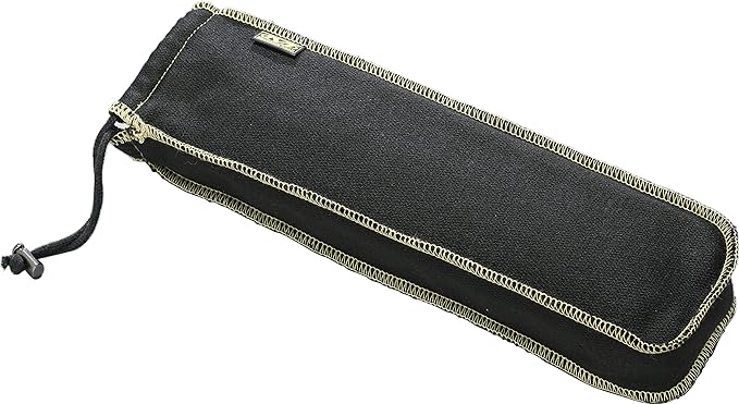

As far as having to wait for it to cool down prior to packing it up, I just pop them into this heat proof pouch from Rifle Only, chuck it into my range bag, and don't give it a second thought.

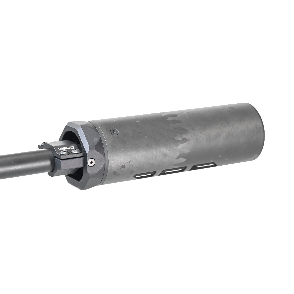

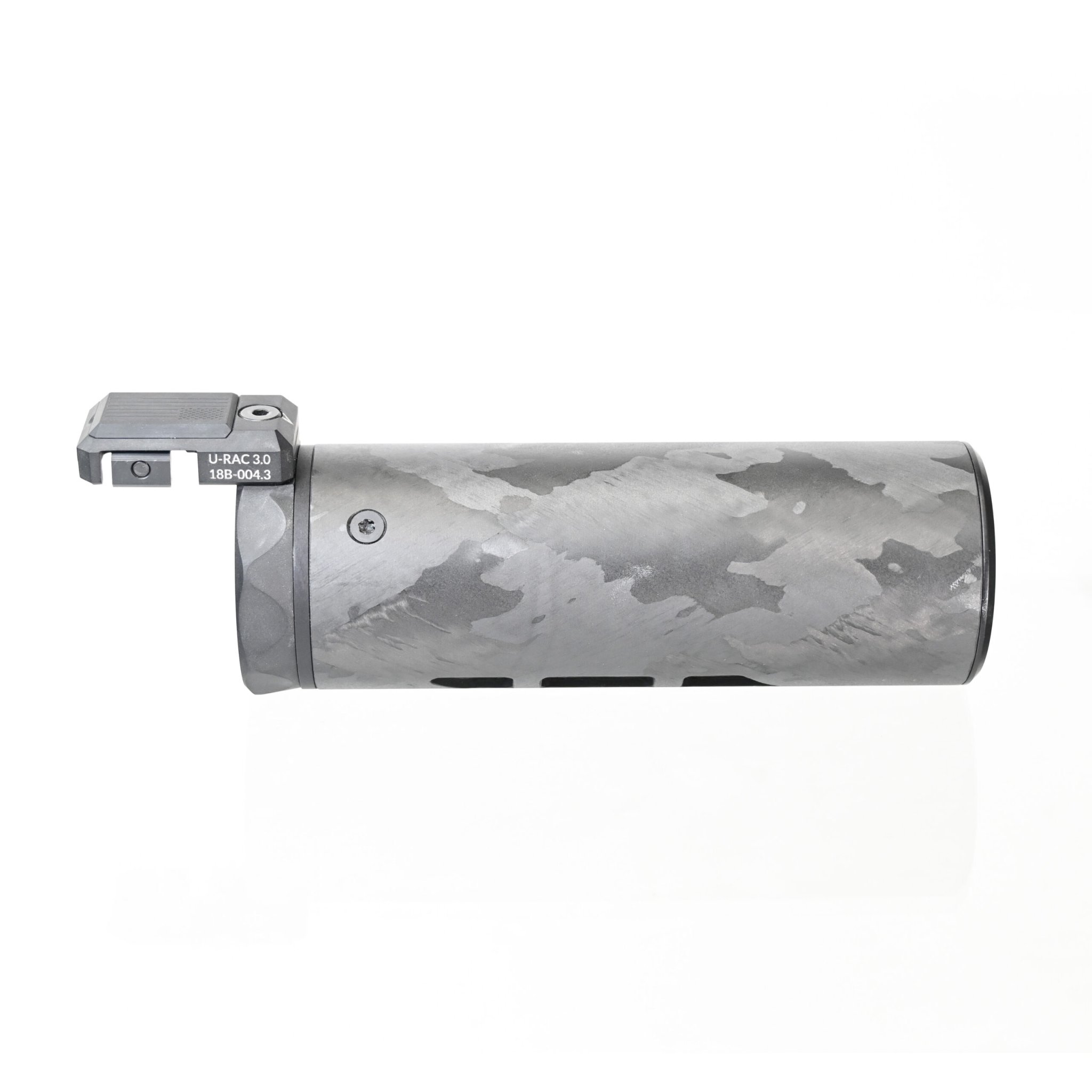

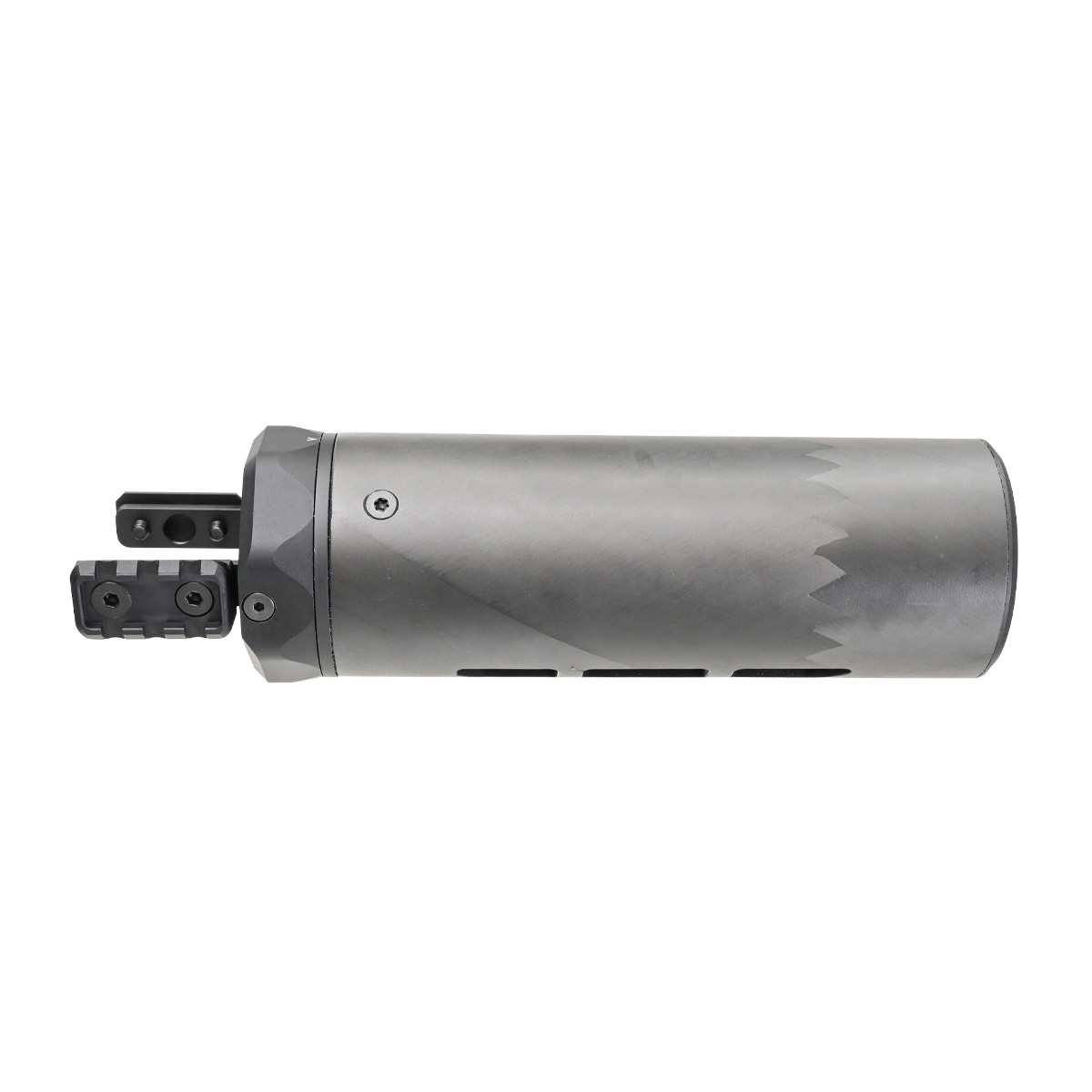

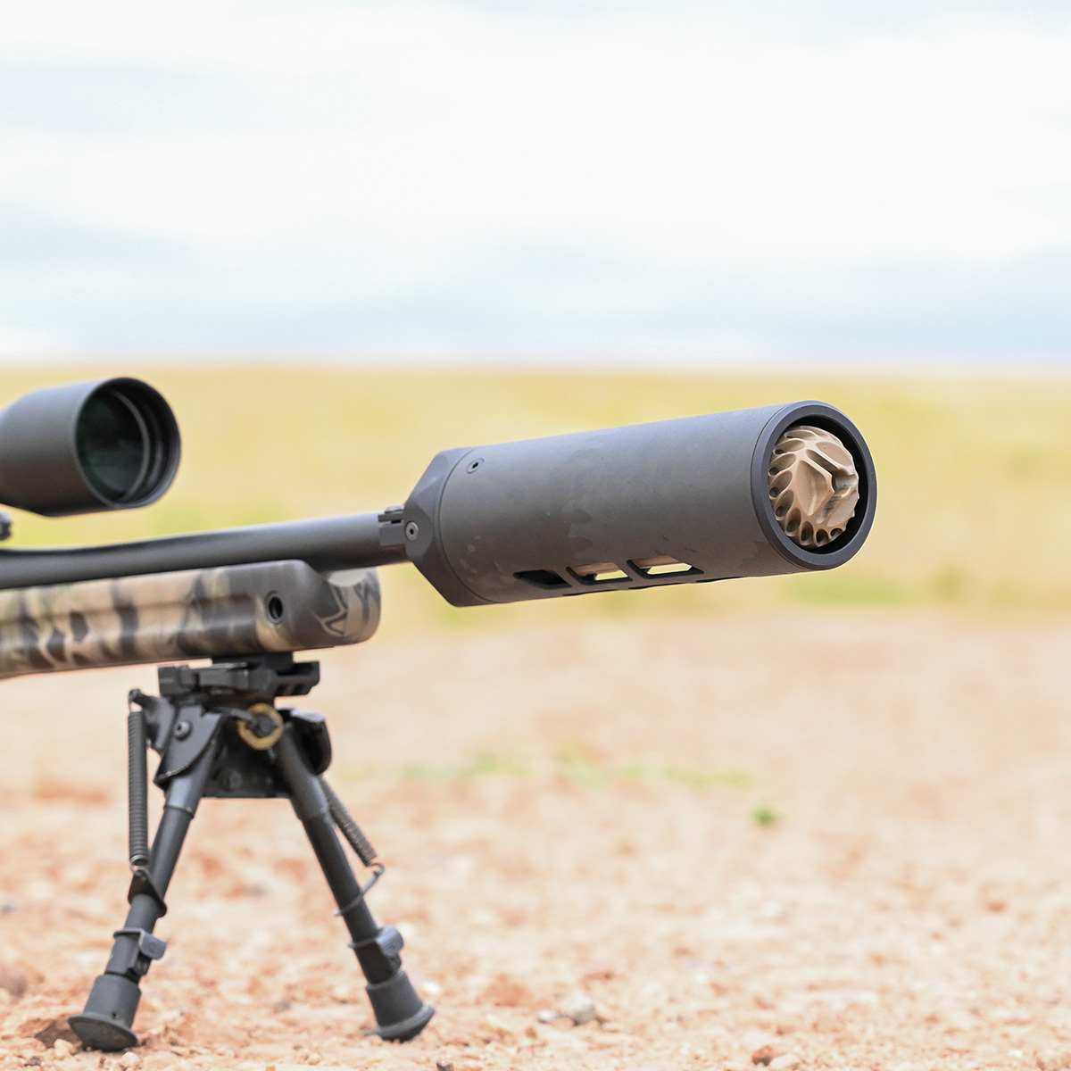

I use a “cover” from Modtac. Not really a traditional can cover, but is a carbon fiber cylinder that uses metal standoffs to allow space between the can and the cover.
My version has been discontinued. It wasn’t attached to the barrel, just clamped to the can. A bit of a pain as I need a small allen key to install/remove. Was ~$210 for the high-temp version. Seemed to limit mirage longer than the can covers I had.
The new version clamps to the barrel (no standoffs) and you twist it to install/remove. Like a camera lens. Not sure what I think about clamping…I know even screwing on muzzle attachments too tight with a wrench can slightly change the bore size, especially if there isn’t much meat (bore size vs threaded portion).
I guess it’s about how tight does this cover attachment thing need to clamp? It’s probably ok as it clamps to the full diameter of the barrel. Pencil barrels…well…
They come in two diameters. Here is the fat version:
Fat version is $500!
Reg version is $410-420
https://modtac.us/product/prss-xl/
https://modtac.us/product/prss/

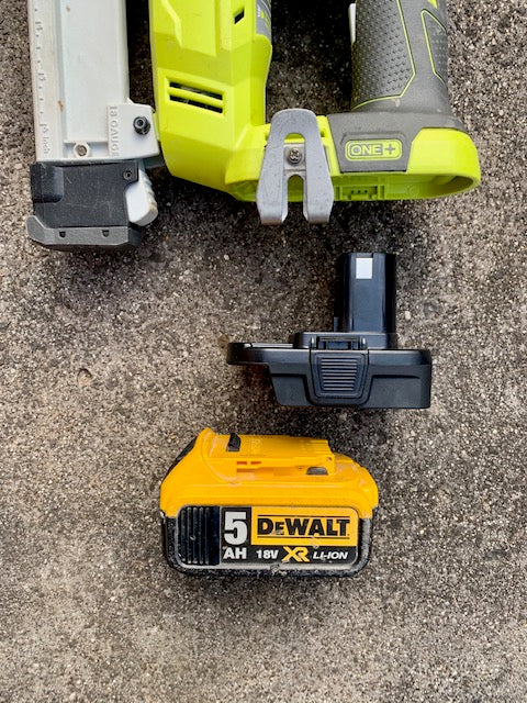

I use the Ryobi blower with a piece of tubing. It can be placed in the action of the rifle and cool both the barrel and suppressor or just place it in the suppressor once removed the new whisper series blower is much quite than my older version. I will probably upgrade it later this year.
