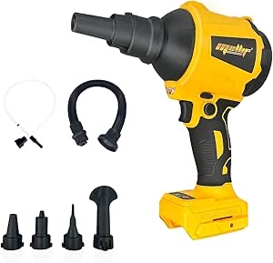

Found one that’s “good enough,” won’t be needing an adapter after all.

But I’m glad you find a Dewalt-compatible blower. That’s probably the best option anyhow.
Not a DeWalt.
Made to look like one, by “Mellif Tools,” which appears to be based in Seoul.
Looks like a Harbor Freight - type of brand, stuff’s probably made in China.

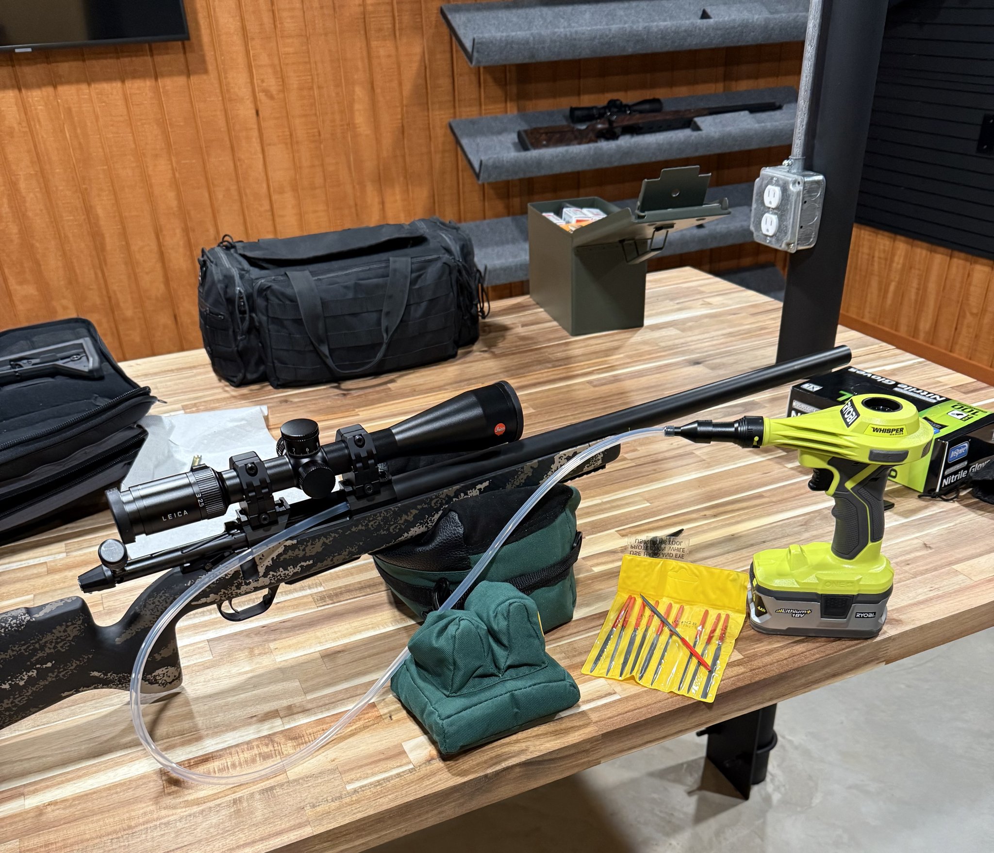

I built one a couple months back with a Ryobi inflator and it works extremely well. Chose that model because I have a leaf blower etc and was able to buy without a battery on Amazon. Went with silicone tubing for heat, and it’s flexible and grabby. Works with a variety of bolt face/chamber sizes and is very powerful.

Yep. I do this too. Only downside is it’s frickin’ loud! I can hear it running at the 100yd line lol

I built one off the new Whisper series a few months back - still pretty loud, unless I'm the only person around or I know the line is going cold soon, I don't run mine around other people. It is undeniably more effective than the Magnetospeed or just waiting on static air, however. I shoot 10rd strings suppressed in practice, and I can get easily double the reps in a given amount of time if I'm pushing air through the system.
Note that the picture posted earlier is also of the new Whisper series haha. They're better, no doubt, but it wasn't a magic sound revolution.
Yes, still very loud
