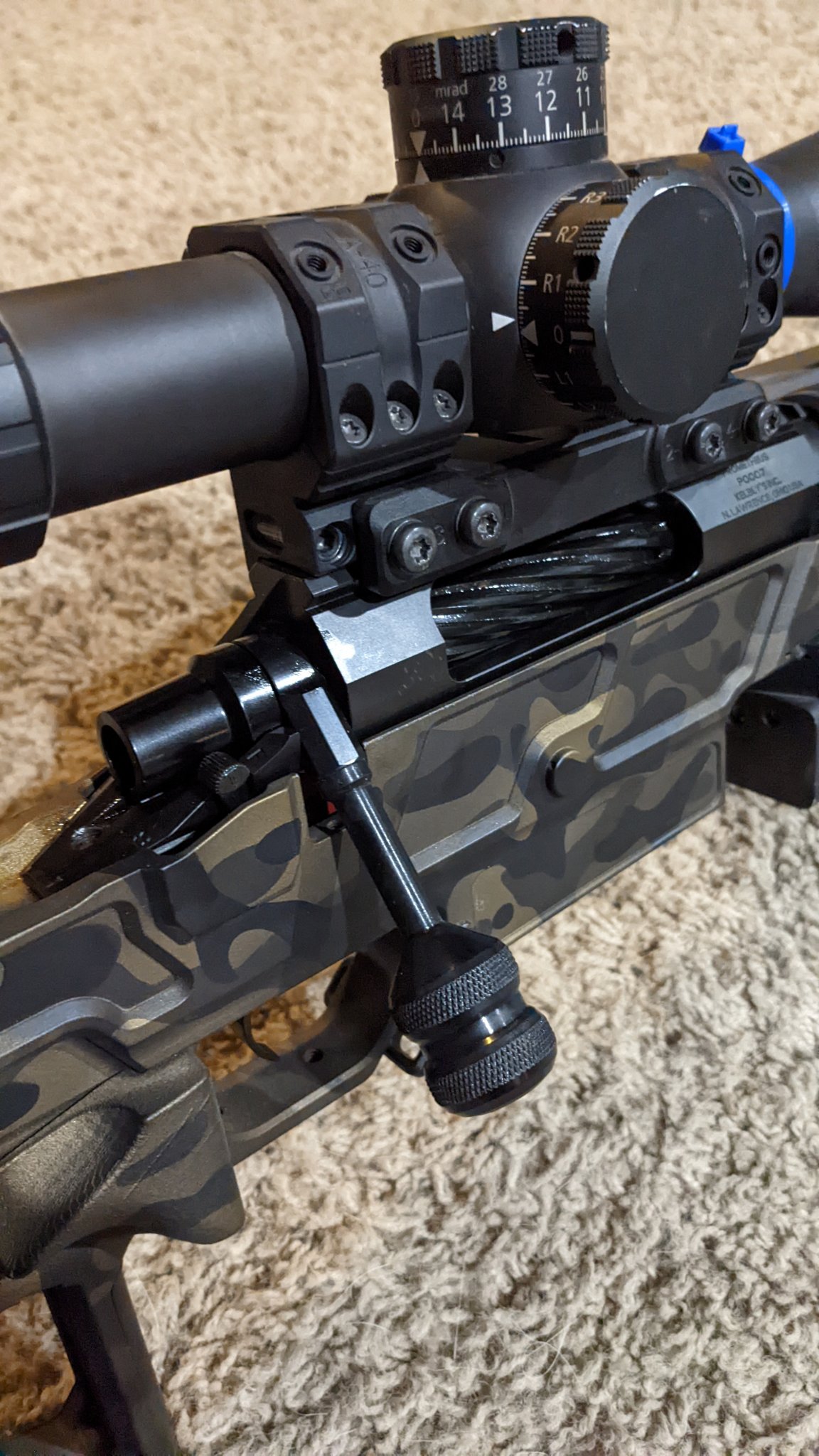

The bolt handle length is the only thing that bothered me on the Atlas. It made the lift incredibly easy but I personally would have wanted an option for a shorter handle.
We have three options for handles now. A tactical which is 2.5", a teardrop which is 2.5", and a ball which is 2". So we have you covered if you want a shorter handle!
