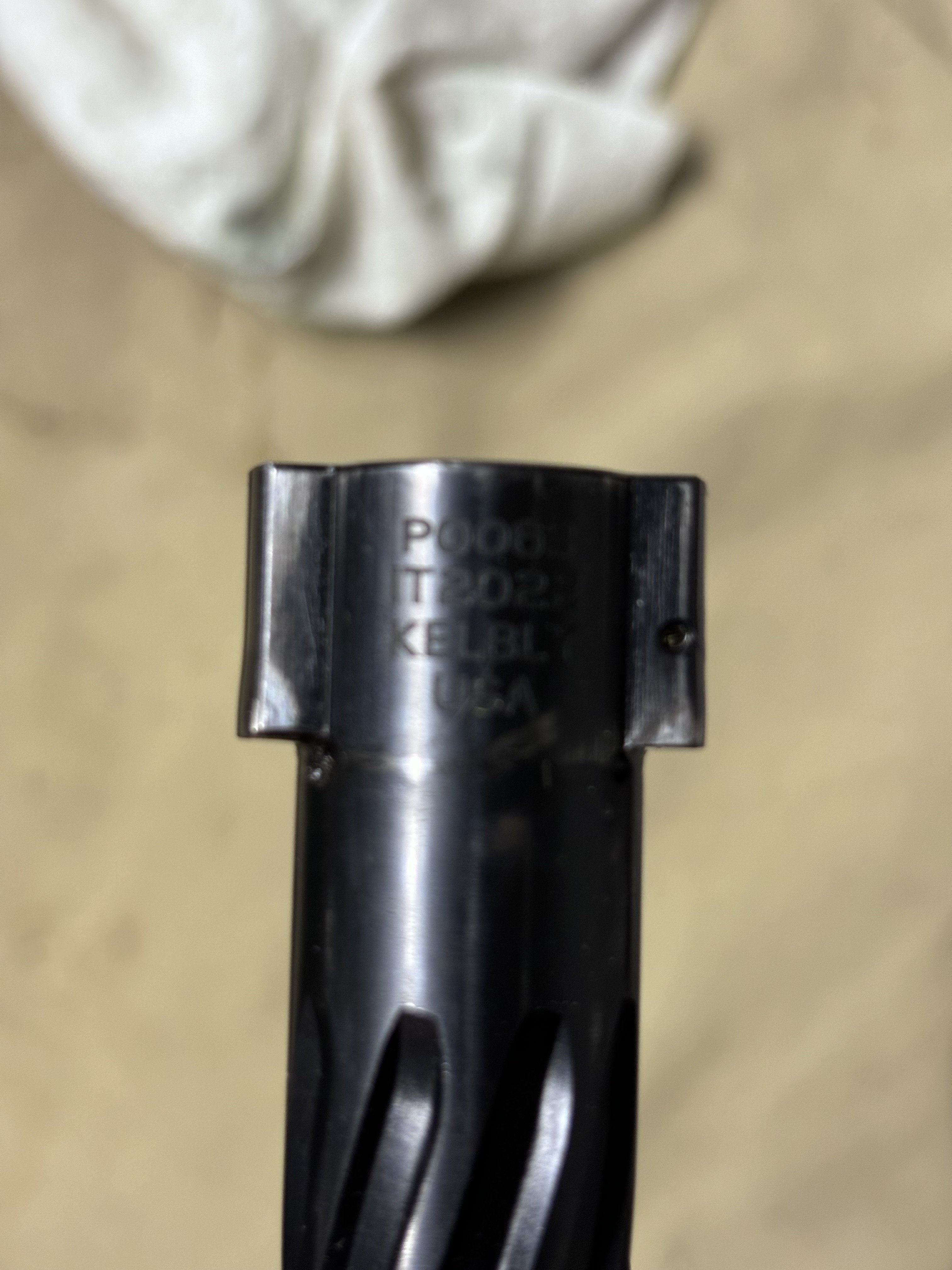

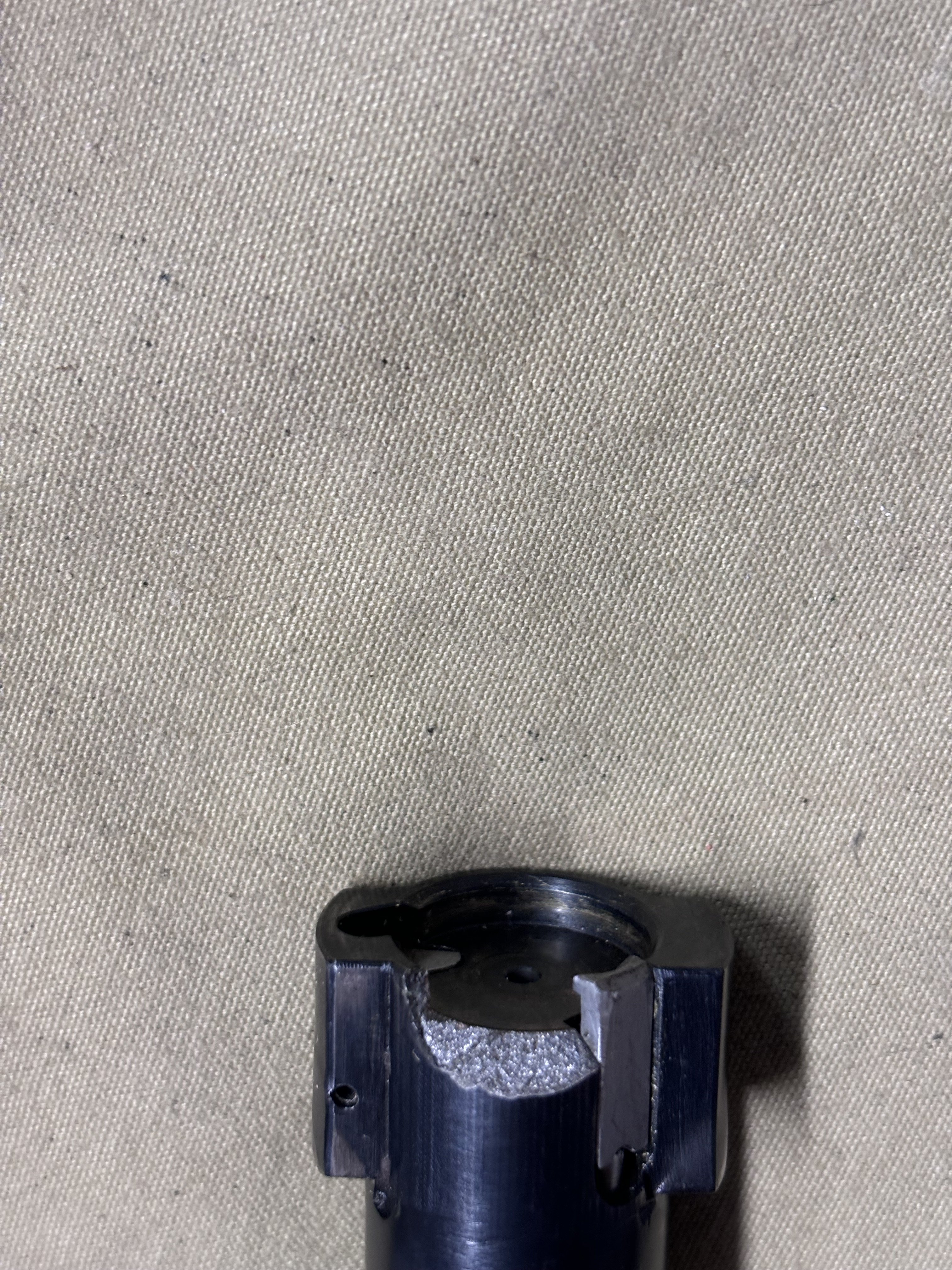

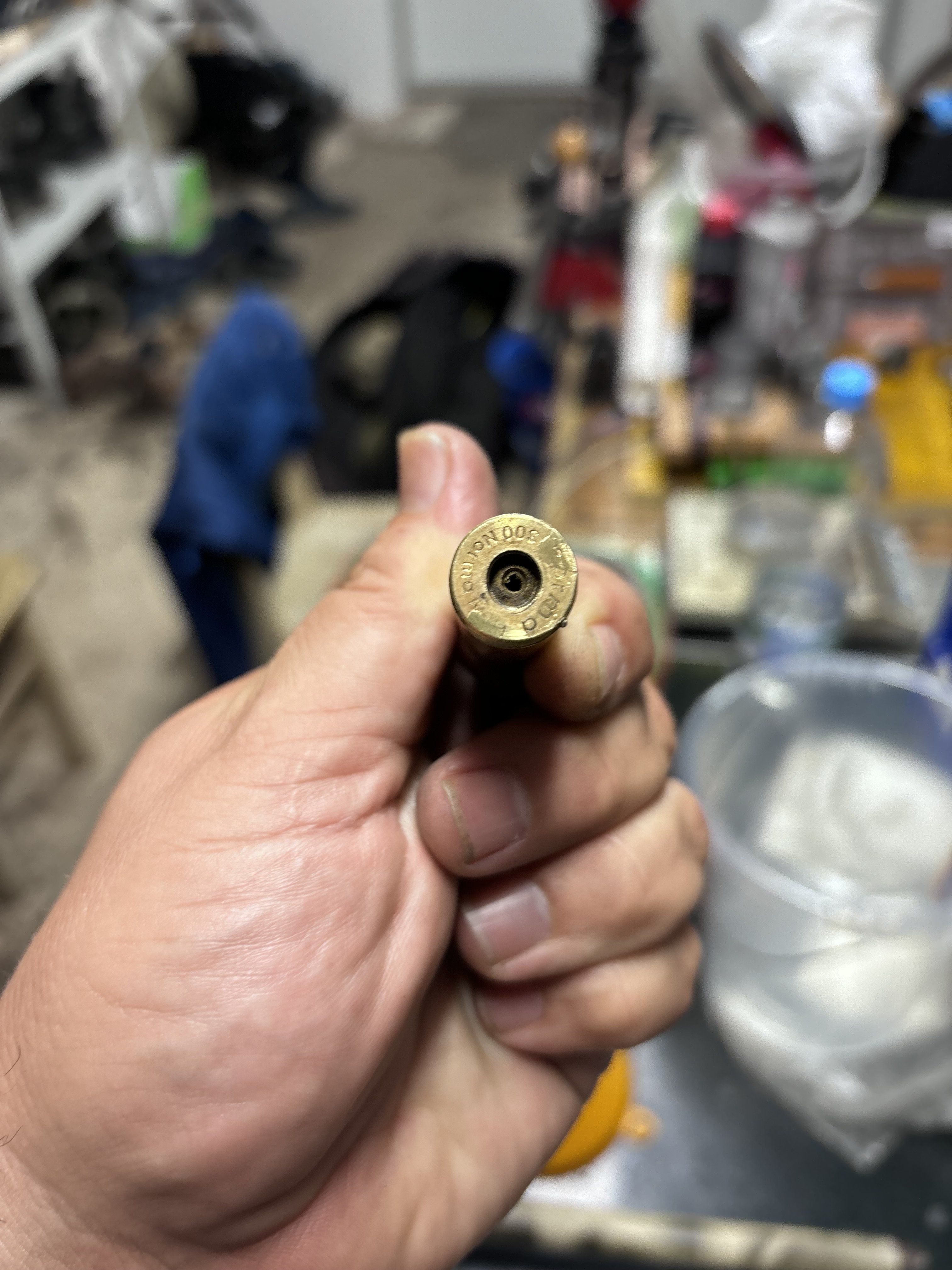

Not that it just works it literally saved my life due to its construction! Loading 89grains of 260rem powder into 300nm is not safe kids do not do it at home and especially not in “just any action”. Without getting into details lets just say that 250a-tip sure flew on that day.
