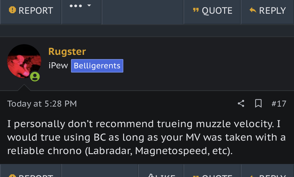

I personally don’t recommend trueing muzzle velocity. I would true using BC as long as your MV was taken with a reliable chrono (Labradar, Magnetospeed, etc).
If data lines up inside 600, then yes, no need to mess with MV.
However, if data does not line up 600 and in, trying BC will not have much affect on the data.
While in a perfect world, you can use the MV from a reliable source, ballistic calculators are not perfect. We don’t have the ability to change the algorithm/formulas, so we must change the only data points we can. Which is MV and/or BC depending on what you’re using.

If this is your method, I’d definitely make sure I put that in posts when you tell people not to true MV as it is quite important information.

No, you didn’t until later. Here’s your post telling him not to true MV without any context that you are manipulating the kestrel already
By slipping the turret to what the kestrel says it will be, you are tell the kestrel that you are at 100yd zero and that the 300yd dope is correct. When in fact, you may not be zero’d at 100yds. You are basically doing a reverse truing.
I’m not saying it doesn’t work, but you need to put things into context without someone having ask.
7107601
I stand by that statement. Do not change a known value. Why would you want to add variables and even worse, work off of a BC that is likely to be wrong from the manufacturer depending on the speed you’re running, atmospherics, etc. You do what works for you amigo.
