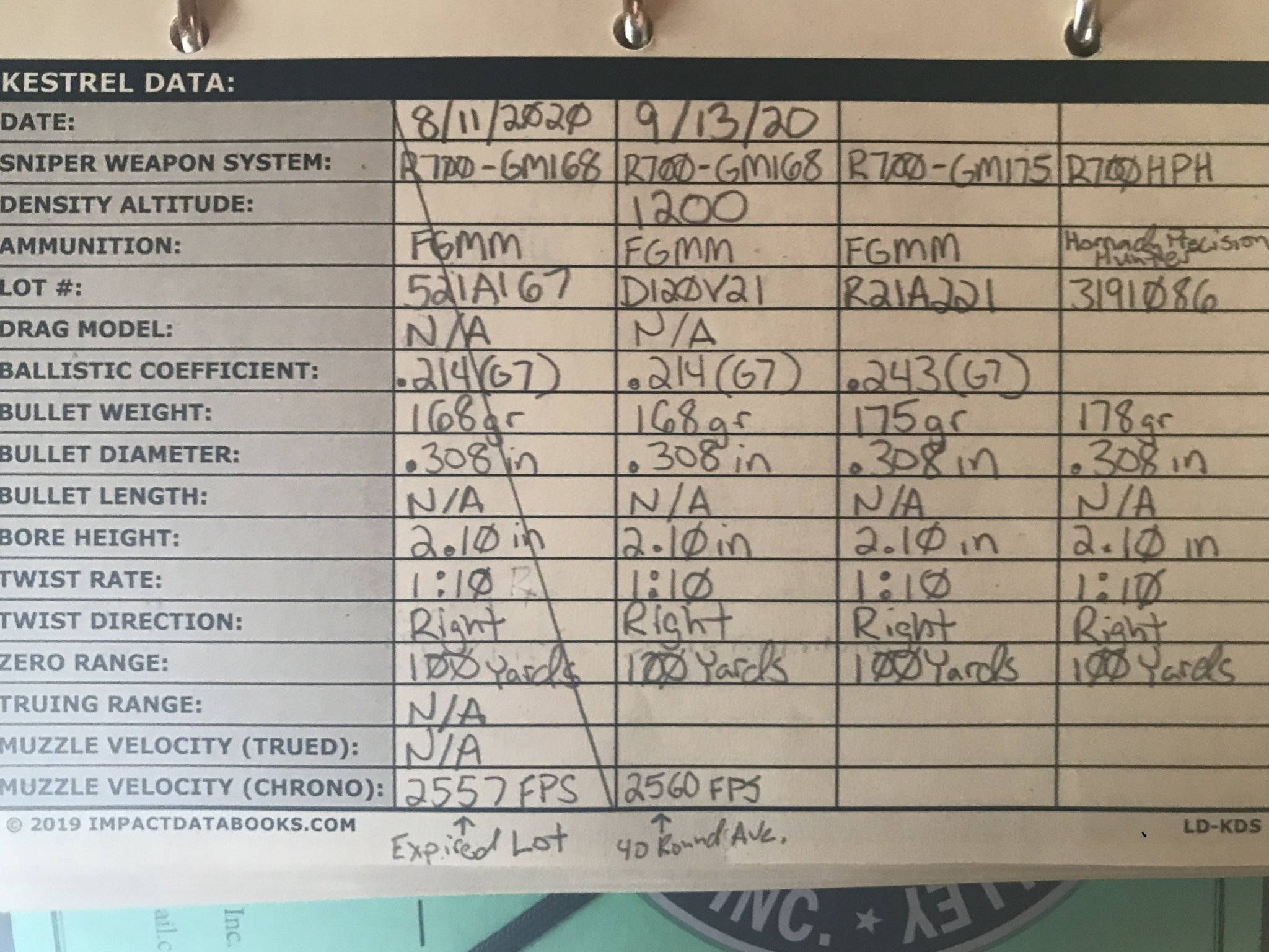

I’ve got a question about backing up my data.
Currently I keep a hard copy of all the data entered in the ‘Gun Profile’ page within the Kestrel Ballistics App. In addition to that I log the muzzle velocity truing range and “trued muzzle velocity”.
If I were to ever loose my profiles...
Would creating a new gun profile with the previously entered data and trued muzzle velocity be all I need to do?
Currently shooting factory federal gold medal match which there is a custom curve for. In addition to this I’m located in the north east so truing DSF is difficult at best.

I just keep the parameters, mv, sight height, BC(if not using cdc), etc etc written down for each rifle.
If something catastrophic happens, that’s all you need to do, just make a new profile with the same parameters.

Tracking the apps. I’m really moving toward a minimalist / hard date copy. Hoping Kestrel will get back to me with an answer and I’ll update the thread. Thinking it through I hard data with the trued muzzle velocity and one of the applied ballistic specific custom drags should be all I need to repopulate... where I think issues could arise is if someone trued muzzle velocity then moved on to DSF. If they did DSF I don’t know how you’d enter that back in the kestrel after loosing it.

For dsf, go into your software, write down the current environmentals. Then write down your drop/dope for he ranges you want to use for your DSF.
If a catastrophic situation arises, go into kestrel, set the environment the same and lock it. Then go into dsf and enter those numbers.
Since your data and dsf was already true on the profile, you will be using the trued profile predictions to calibrate the dsf on the new profile.

The profile loader I linked saves everything, DSF included. I get trying to go minimal but the solution already exists.
