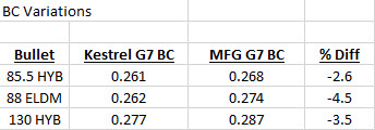

Kestrel BC Values are incorrect
Superjet
Mar 9, 2019
322
298
I primarily shoot Hornady 88 eldms, Berger 85.5’s and Berger 130 hybrids and have recently noticed that the Kestrel default values for G7 BC differ from the mfg stated BC. I only started questioning this as I have recently switched to the 85.5's and am having some elevation issues at ranges beyond 700 yards. ES on loads is around 15 FPS, at 2950 FPS. Is this just an error on Kestrel's/AB's end or am I missing something?
I’m pretty sure the kestrel BC’s are litz’s tested BC’s not the manufacturers
There is the banded BC info Hornady provides. If Kestrel/AB track into trans/subsonic their average BC is going to be further down the curve.
Reactions: timintx and Baron23
What’s banded info?
The BC value is tied to velocity, not just the shape of the bullet. Most vendors give a single number average that usually works "good enough" at common distances.
Hornady gives 3 different G1 and G7 values at different speeds as shown in the picture for many of their target bullets. As you can see the BC value decreases as the speed decreases.
Their whole chart is here:
Reactions: MilSpecOkie
The Hornaday 4DOF 5700 uses bullet data developed by Hornady, all other 5700 ballistic meters use bullet data developed by AB. When you use the App to create a profile the phone/pad goes to their database for the bullet information. There is very little bullet data in the Kestrel itself, just a few profiles. Always build your profile in the Kestrel Link Ballistic App and transfer to the Kestrel for optimal bullet data. The best data would be the 4DOF for Hornaday or the AB Custom for AB. These are tested results and allow the ballistic engine to optimize results.
