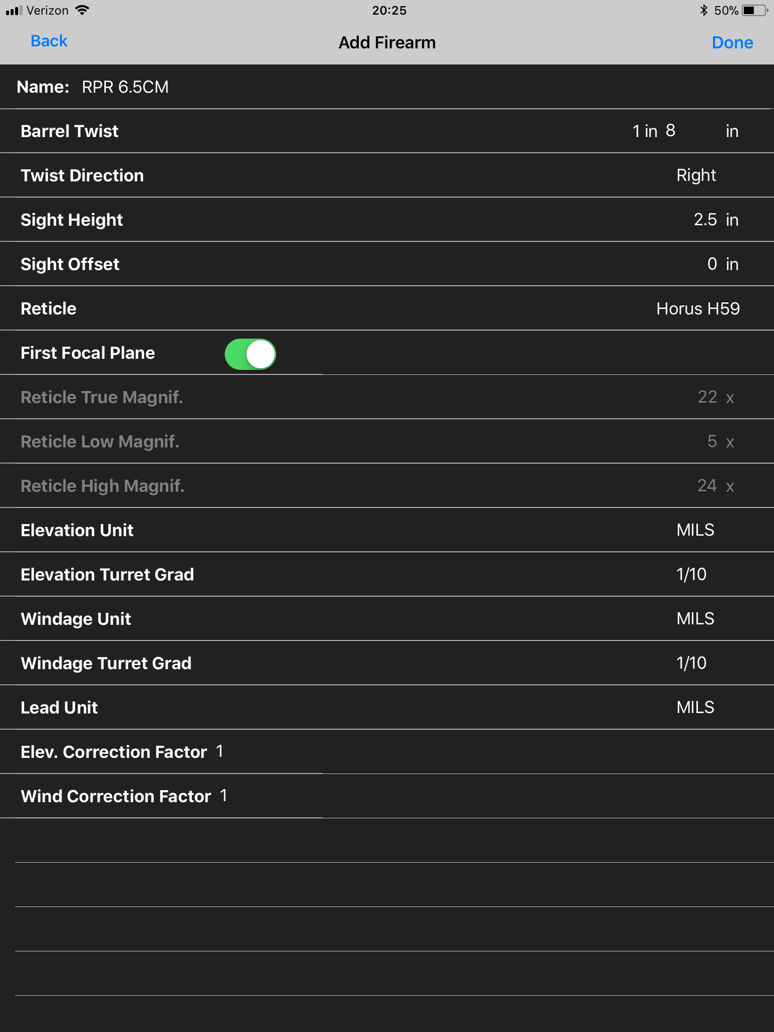

So assuming your zero was absolutely perfect and I mean perfect dead center of a target and you rotate 90degrees left. Your height over bore is zero and your scope offset is your height over bore right? In this example from AB Mobile I would have to to do 1 of 2 things. Either I create a new profile where I put sight height to zero and sight offset to 2.5 or when I rotate the rifle I dial out the 2.5 inches on my windage (which is the elevation turret) to bring that back to center. If my original zero was absolutely perfect I don’t need to do anything with the windage to make my elevation perfect again. After that your holds should be no different right? I just have to account for that extra 2.5 inches of offset whether it’s left or right. If your zero wasn’t absolutely perfect now you have to account for both. But yes the bore and reticle are absolutely parallel you just have to change which value is offset or dial it out and hold.
Make sense? Or am I completely nuts? Your compensating for sight offset instead of sight height is all.

Try the Fire Solution mode in CB, as I understand your request, this is what you are looking for.

Take your solver and reduce the range increment to 5yds so you can visually see the parabola. With my 6x47L, scope height 1.35", running a 105gr @ 3100fps I am at +.01 from 75yds to 95 yds, zero @ 100yds, and then dropping about .01 every five yards beyond that to 130yds. So, for a 100 yd zero the flat spot (top of the parabola) is from 70 yds to 105 yds. That is so flat for a third of the 100yd trajectory (my zero is right at the end of the top of the parabola) it seems silly to try and calculate that tiny angle. Unless you're shooting beyond 600 yds @ 90 deg cant, you ought to be able to just assume scope height on either side and add a 1/10 mil for every hundred yards and be ABOUT there, because the angle is truly tiny, and if the bullet is dropping 90deg to that it may require a finer than 1/10 mil adjustment. Trying to plot that stage perfectly isn't going to be done with a solver, but with a mapping algorithmic program that will plot the cosine of the parabola of the bullet with respect to that tiny angle between the scope height and zero at 100 yds. That kind of think may interest Bryan Litz, but if you're just interested in a hit go to the range, shoot that way, and gather the dope for your rifle. I don't believe someone elses dope will be that valuable, because you're talking minute differences in the way the rifles are set up. I think the point of the stage is to think about it, eyeball it, and hold it over rather than to plot a solution and dial it, which in the end I don't think will be as valuable as training to shoot that stage, by shooting it, anyway.
